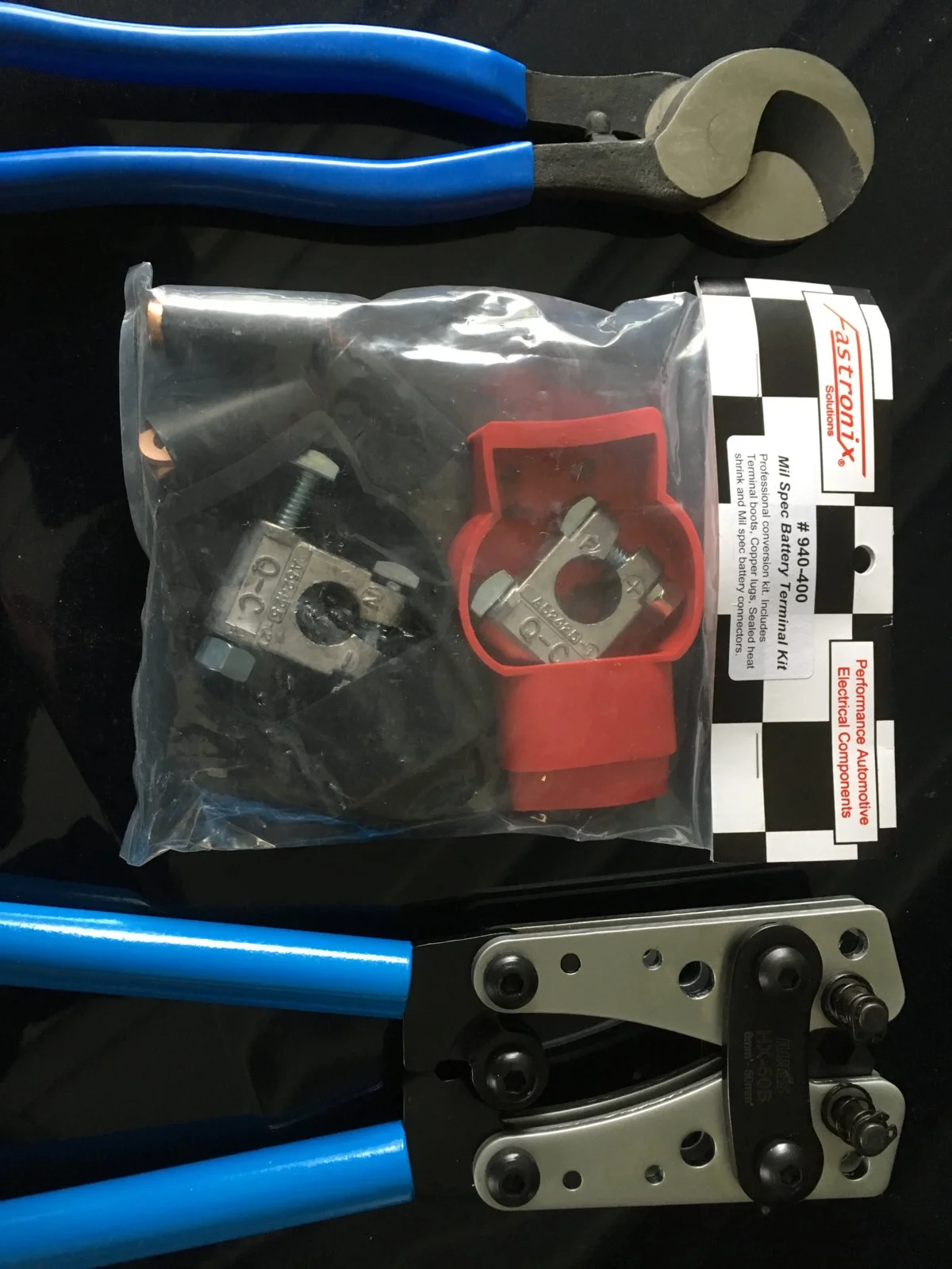

harbor freight sells a hydraulic hand crimper which works on up to 0 gauge I believe
Yes that is the one I used...
Maybe @Chris has a amazon link to one.
There're really easy to use I would only suggest getting a cutter for the cables but it really is not necessary for only one connection. If you were assembling 8 or 12 ends the time saved might be worth the added expense.

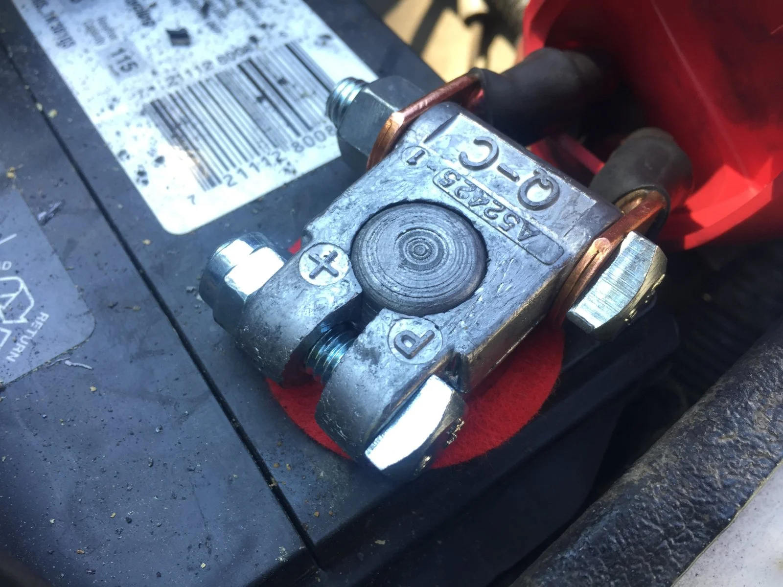

Alright so I did this job today and it was pretty good.
Love the new setup!

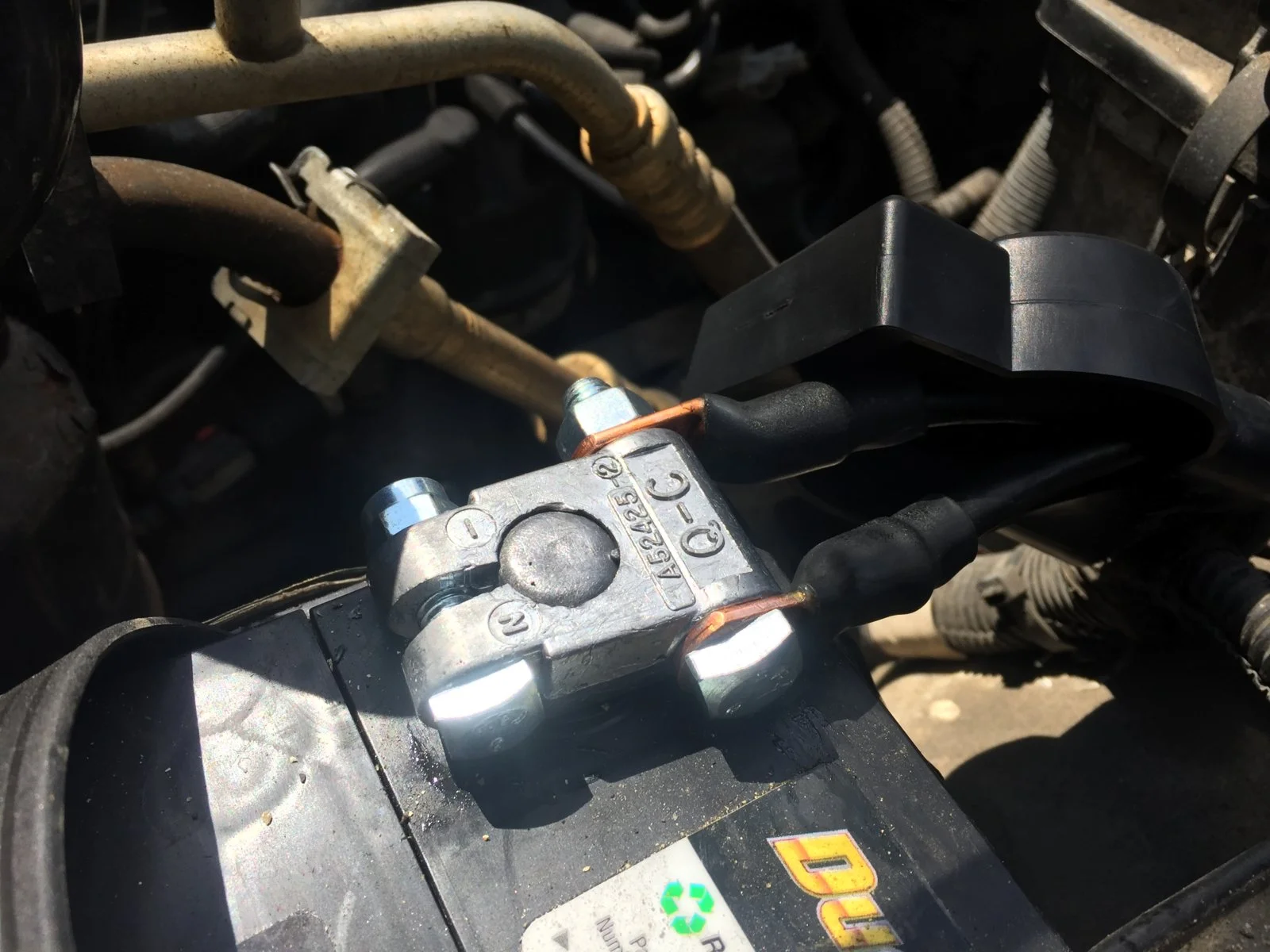

My cables were in good condition, so I opted to cut them & pull them out of their previous terminals and use a torch with solder in the copper eyes to attach them. 30,000 miles later still new as ever. Here are the photos before & after when I first got the Jeep. If I needed to replace the cables I probably would have had a shop make me a set. I'm interested to know why you wouldn't want to solder the cables to the copper eyes to attach to the battery terminal connector, because I thought that was the proper thing to do.
View attachment 25899 View attachment 25900 View attachment 25902 View attachment 25903 View attachment 25901
To add to what Jerry related, typically when you get solder (yes, even the correct rosin core for electrical) hot enough to flow correctly, you are destroying the insulation and it wicks into the cable. At the end of the solder flow in the cable, that creates a stress riser that can start breaking strands of the cable under vibration and since it is inside the insulation, you will never see it.
Do not solder cable lugs for cables. Get, borrow, or have someone use a good lug crimper and then use the adhesive lined heat shrink to provide strain relief and prevent corrosion.
