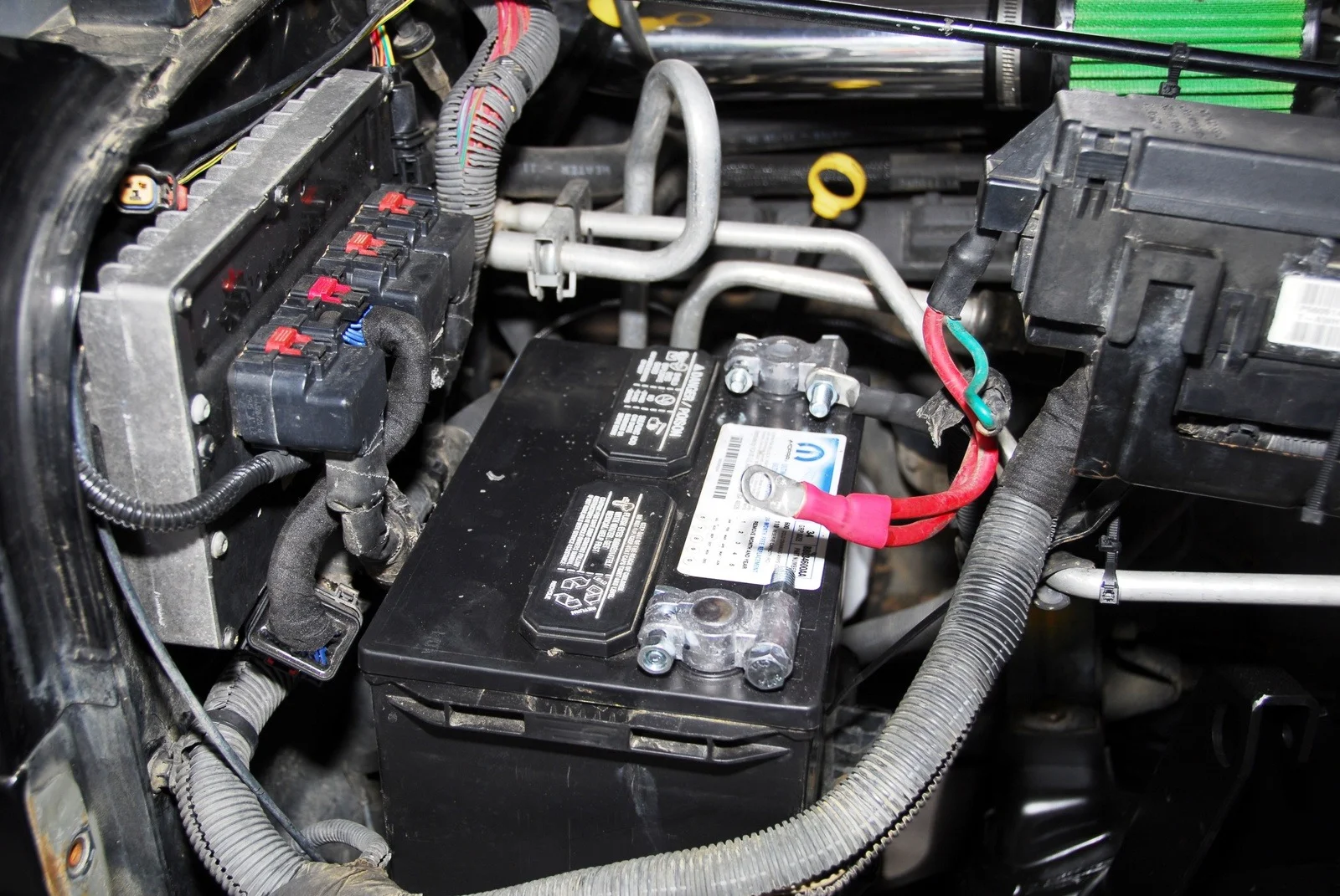

What size connector did you crimp the pair of +12v cables into @mrblaine? You're still using the OE size 6 gauge cables there? I'm probably going to redo my battery wiring soon.

I think it was a #4 cable lug.
Thanks, just checking to see if those two would fit into a 4 because a 2 would be too big.. Of course a cable and connector website had an app on what size to use for two 6 gauge cables and it said to use a 3 gauge connector. :D
