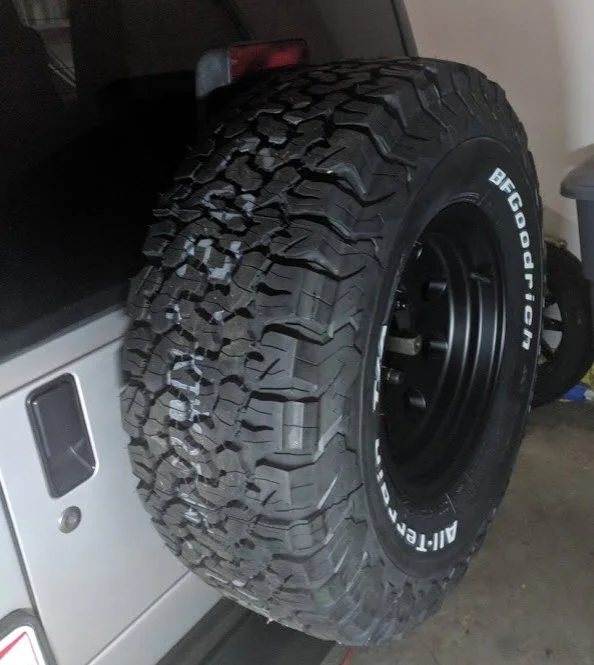

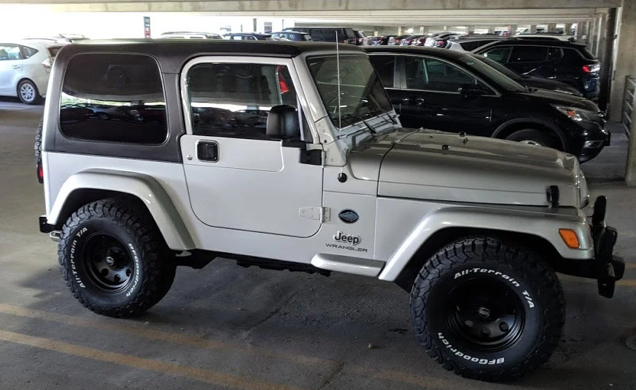

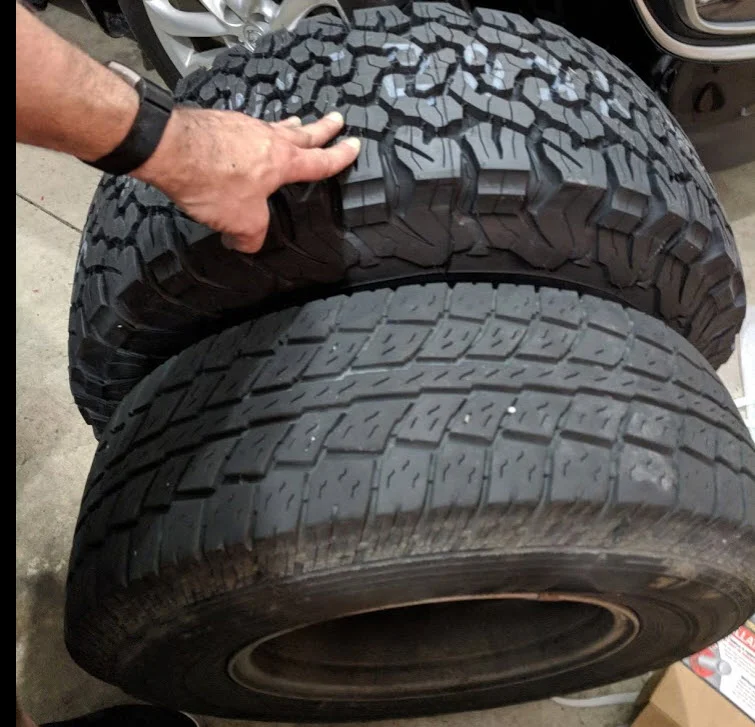

Yeah, the 3.07 is tough. At least you have the 5 spd to help a bit until you can re-gear. I finally received my AR Baja's and BFG 32's and got them installed last night (pic below). Now I just need to get the BDS 2" lift installed (hopefully next week). Boy does it roll better on the new KO2's. Two of my stock 30's (probably 29.5" new) were around 28" in true measurement since they are used and the other two perhaps 28.5". The new BFG tires are somewhere around 30.7" of real measured height with ~28-29 PSI. I have the Dana 44/3.73 rear with the manual 6 spd (NSG370). I did notice the gearing changes with the 32's, but I actually like how things have shifted so far. First gear is now more usable for me as I don't have to shift as fast. I can still also use 6th gear perfectly for OD on the highway, but I don't fee the need to shift into 6th as soon as before. We'll see how it goes from here, but I really like the 32x11.5xR15 setup so far. It doesn't look as aggressive as the 33's, but it is perfect for my needs. As a bonus, the 32" BFG A/T mounted perfectly on my stock spare tire carrier without any extension or alternations to the 3rd brake light.
Before
After

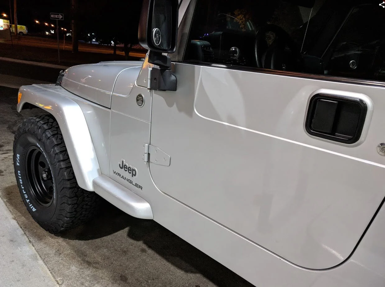

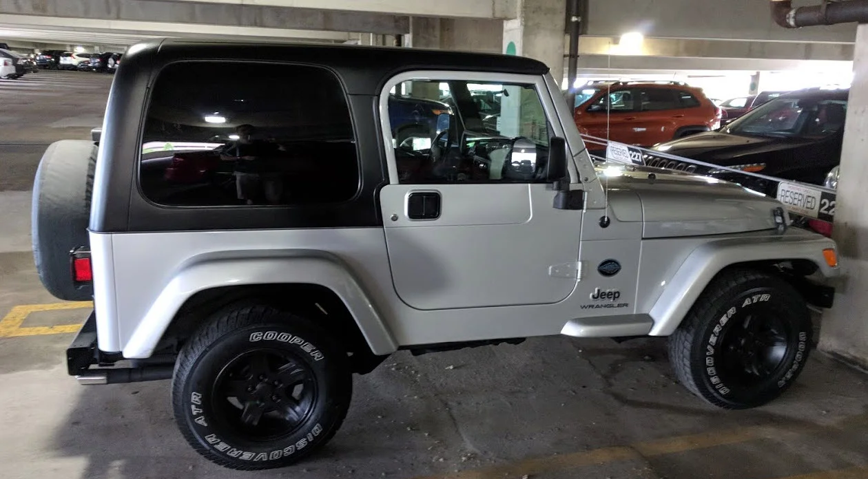

Before
After

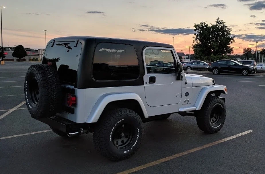

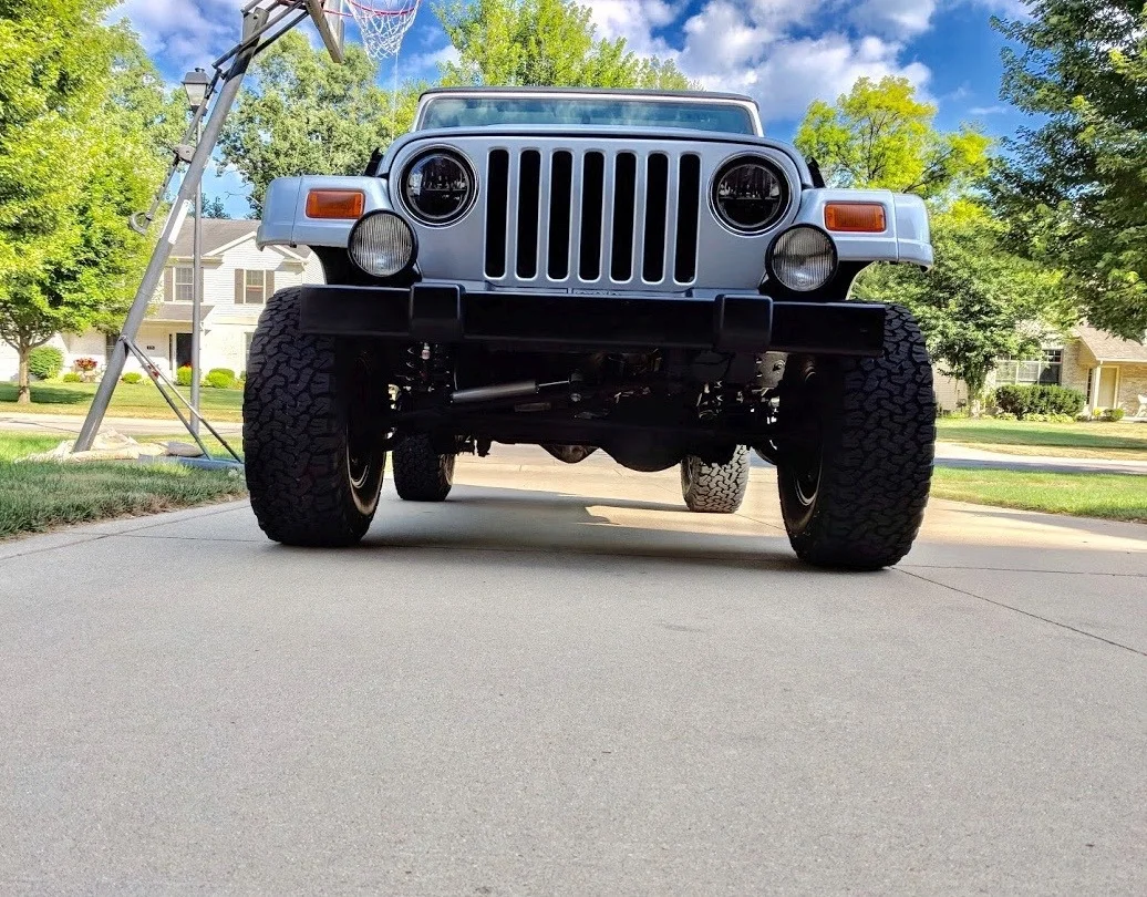

Here it is now with the BDS 2" lift kit installed (BDS springs, NX2 shocks). Probably not necessary, but I also added the JKS quick disconnects and NX2 steering stabilizer. I'm very happy with the lift height and the ride is nice and compliant on-road. A bonus was that the NX2 shocks and stabilizer have a silver painted body that matches my bright silver TJ. Need to wax those things up, LOL.
However, a negative is that I now have some minor vibration when taking off from a complete stop in first gear (rear driveshaft pinion angle related issue I assume). I can feel it most in the 6 speed shifter as the driveline shimmys a bit and then goes away fairly quickly as I continue to accelerate. Nothing violent by any means, but it needs to be fixed. It is a little more pronounced the faster I attempt to accelerate. So, I'm not going to drive it any further and we'll be dropping the t-case a tad to see if it smooths things out on Monday.
More notes:
  • It was good I could compare the wheel\tire upgrade by itself first and then the BDS lift about a week later. Both were very nice upgrades from stock form. Now with the lift, it is even more compliant and is quite a bit better than my previous setup on stock springs with Bilstein 5100's. Before the lift, clearance on the 32's wasn't a problem for normal on-road driving with the 3.75" backspaced wheels, but I wouldn't want to drive like this for too long.
  • After the lift was installed, when I come into my driveway over a rounded curb of 4 inches or so, I noticed that it now feels like it oozes over more smoothly as opposed to roughly jolting up and over like before. Same tire pressure, same tires, same wheels, only differences are as noted above. After riding around a bit, my wife also had me do the speed bump test, LOL. It passed the test and handled the jolts well, much better dampening than before the upgrade. Anyhow, just some quick observations after a bit of driving, so we'll see how things go from here. The NX2 shocks claim to have "velocity sensitive valving for lightning fast adaptive dampening to whatever terrain you traverse". We'll have to put these things through the paces a bit and see how they hold up on our crappy roads here in the midwest, LOL.
  • As far as diagnosing the vibes...there aren't any issues with the rear shaft u-joints during inspection or sounds during driving, so leaving those alone for now.
  • Carfax tidbit: my front driveshaft was replaced at 67k by Gazzani Motors Inc. Elmwood, NJ. Wonder what this was about...
  • Still would like to upgrade the rear driveshaft to something better at some point, do the adjustable arms, and SYE. Maybe even gear up from 3.73 at that time as well. For now, I hope the t-case fixes the starting vibration issue and I can just enjoy the Jeep for awhile without spending any more $ immediately (yeah, I bet you've heard that one before!).
  • Motor mounts and trans mounts seem to be OK, but I need to inspect them more closely.
If anybody has additional advice or comments, please let it fly. Thanks!

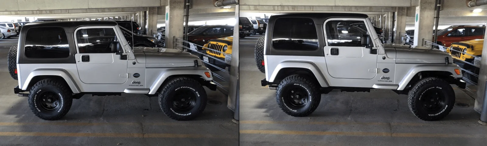

Before and After (also can see upgraded Banks exhaust):
More notes:
More notes:

When I first installed my BDS lift I had the same vibration (more of a shudder) that your describing. Temporarily dropping the transfer case skid about 1/2”-5/8” with washers took care of it. I then added a motor mount lift and was able to put the skid back where it belonged.
Reactions: Cal and mots
Thanks! The MML sounds like it would be a better alternative than the t-case drop, but I haven't done enough research on that one yet to feel comfortable. Would a body lift also be required if I don't want to relocate the fan shroud with the MML alone? Are there any concerns with the MML solutions causing unwanted vibrations with the engine at idle? I have heard talk about these things in general, but I don't pretend to fully understand them yet, or know how much it would cost. It sounds like more than I want to get into right now though. My issue is just a subtle driveline vibration due to the now steeper rear driveshaft angle, so I definitely would not classify it in the same camp as "death wobble", LOL. I've felt the DW before in another Jeep during a test drive (induced by ridiculously high tire pressure) and it literally felt like my wheels were slinging into the next lane and back again! I had to slow down to nearly 5 MPH for it to completely stop.
Cool, good to hear. I do want to learn more about the MML, the costs involved, and hear your guys' experience with them. I'll have to do some more research this weekend.
