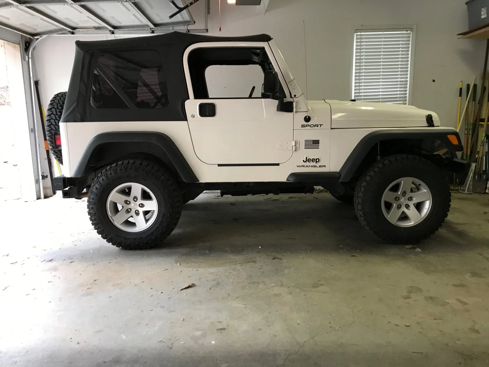

Other then the spacers in front did u need anything Else for the liftI've got the 2" kit from BDS. I've been very happy with it, and likely due to some sag in the stock springs, it netted at least 2.5" but more like 2.75". I also added 3/4" spacers to the front thinking I could take them out if needed. I haven't needed to, and it sits level which I prefer. Installed in April this year and no settling (yet). Cost was about $420 from Northridge, shipped free.
I don't have a ton of money to throw at this Jeep so I liked the price and reputation with BDS. Easy install with a helper. Good luck!
What bump stops did you useI run their 2" coils with a .75" spacer in front which leaves about 1/2" rear rake. You do not need new control arms with 2-3" lift but, don't let that stop you if you want something adjustable, with Johnny Joints, etc.
To complete my lift: Rancho 5000X shocks (55239, 55241), JKS track bar, rear track bar relocation bracket, 2" bump stop extensions front and rear, although the rear only needed 1.5" I passed on cutting them due to laziness![]()

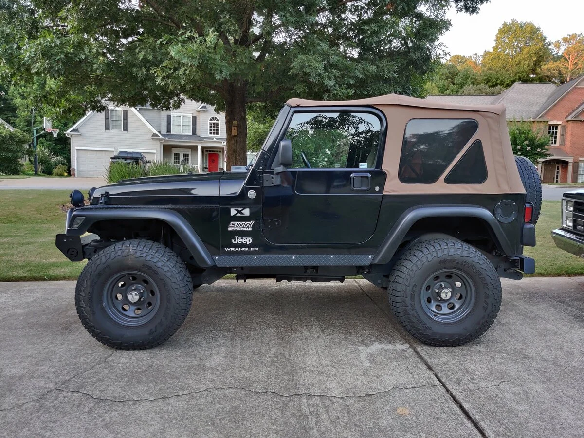

I really want to see how your jeep sits with 3/2"... Can't seem to access your profile, maybe due to my low rank.

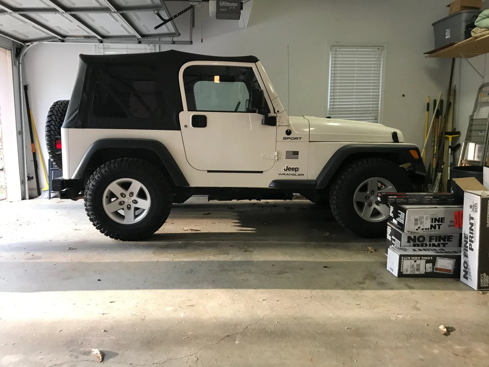

I now see what you mean. I could draw a straight line lol.View attachment 179024I have an aftermarket front bumper and full size spare tire. Currently have no backseat as I am moving so the rear may sit a little lower usually but not much.
