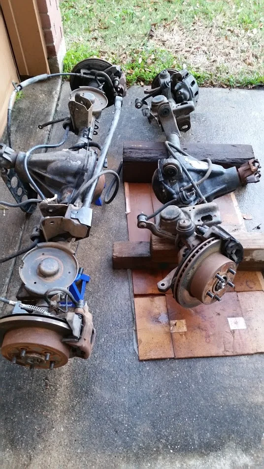

Well here they are! 2006 Rubicon Dana 44's
Awesome man, I love what you've done with it so far.
Also, I saw what you got those axles for. Talk about one hell of a deal!
Reactions: Kevin E
There's a complete set of 2006 Rubicon axles here on CL for $4250, it includes everything needed for a swap. The NV241 is an additional $1500. Glad mine already has them.
Yeah, Kevin got a damn good deal on them. They usually sell for a lot more than that!

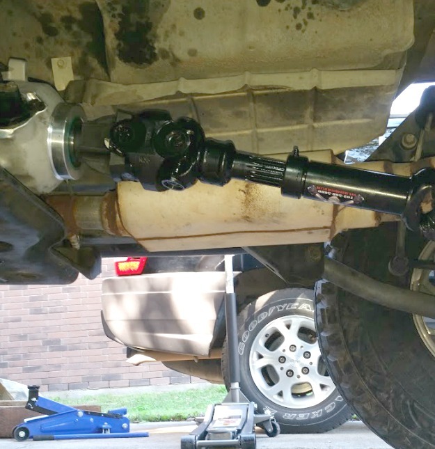

I'm doing my SYE/Driveshaft/Control Arms this weekend weather permitting. Anyone have a fluid preference for transfer case?
Drain and refill it with any good brand of ATF, it's not fussy about the exact type of ATF it runs on like the automatic transmission is. If you want a specific ATF recommendation, go for ATF+4.
Cool thanks
Do you have a MML? Looks like you do since the transfer case seems slightly angled down?
Must have because the mounts are pretty high. Might be why I didn't have a lot of vibration with the old driveshaft that was angled higher.
That would make sense. My transfer case isn't angled like that with my 4" lift but that's because I haven't yet put my MML on.
I'm also glad I ordered a replacement chain for transfer case. The old chain was stretched enough to be hitting the case.
