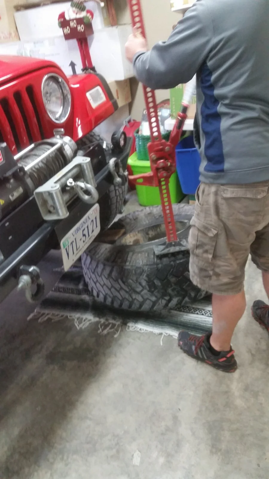

Friend of mine was quoted $ 100 per tire to dismount/remount 37's on beadlock wheels.....i said bring em' over.
Well after several attempts with the help of youtube videos, we were unsuccessful.
Pulled my TJ up onto tire and used high-lift jack and couldn't break them.
I'm no longer a fan of beadlocks. Grrrrr

100 bucks each is about what I would charge to mount and dismount new tires on conventional bead locks. More if they have been in the rocks and we have to hammer a socket onto the bolts to get them off. Takes us about 4 hours and I'm going to ding you a bit for the PITA factor because I don't really like messing with them. That and you're going to supply new bolts and washers because I won't reuse any bead lock bolts.

So I can’t help but ask, how do you remove beadlocks from a tire? The home grown method appears on be a high lift jack. The method we used on aev beadlocks was with a fork lift. Would love to know if there is a better way. :D

I have a set of Tyre Pliers and some tire spoons. I have had to use my Dodge Diesel and another rig to break down a set of Krawlers off of a set of Walker Evans though. I won't do that again. The TJ parked a front tire on one side, I drove up on the other side and had to drive back and forth to break the bead loose. Without the TJ, all it did was flip the tire and rim up. Needed weight on the other side to hold it down.
