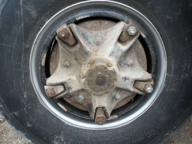

Beadlocks were not the target but they get lumped in with other modular wheels which used to be common like Daytons, which unless regularly maintained, inspected have a habit of falling apart. They take a special knowledge, sort of like beadlocks.
Reading thru the OP it is obvious the skill level is pretty low amongst first time beadlock owners too.
So, just a Canada thing and not a US thing then? And only applicable to bead locks by the most broad of definitions even though anyone with a smidgen of common send understands that one retain the tire and rim assemble and the other only retains the tire.
