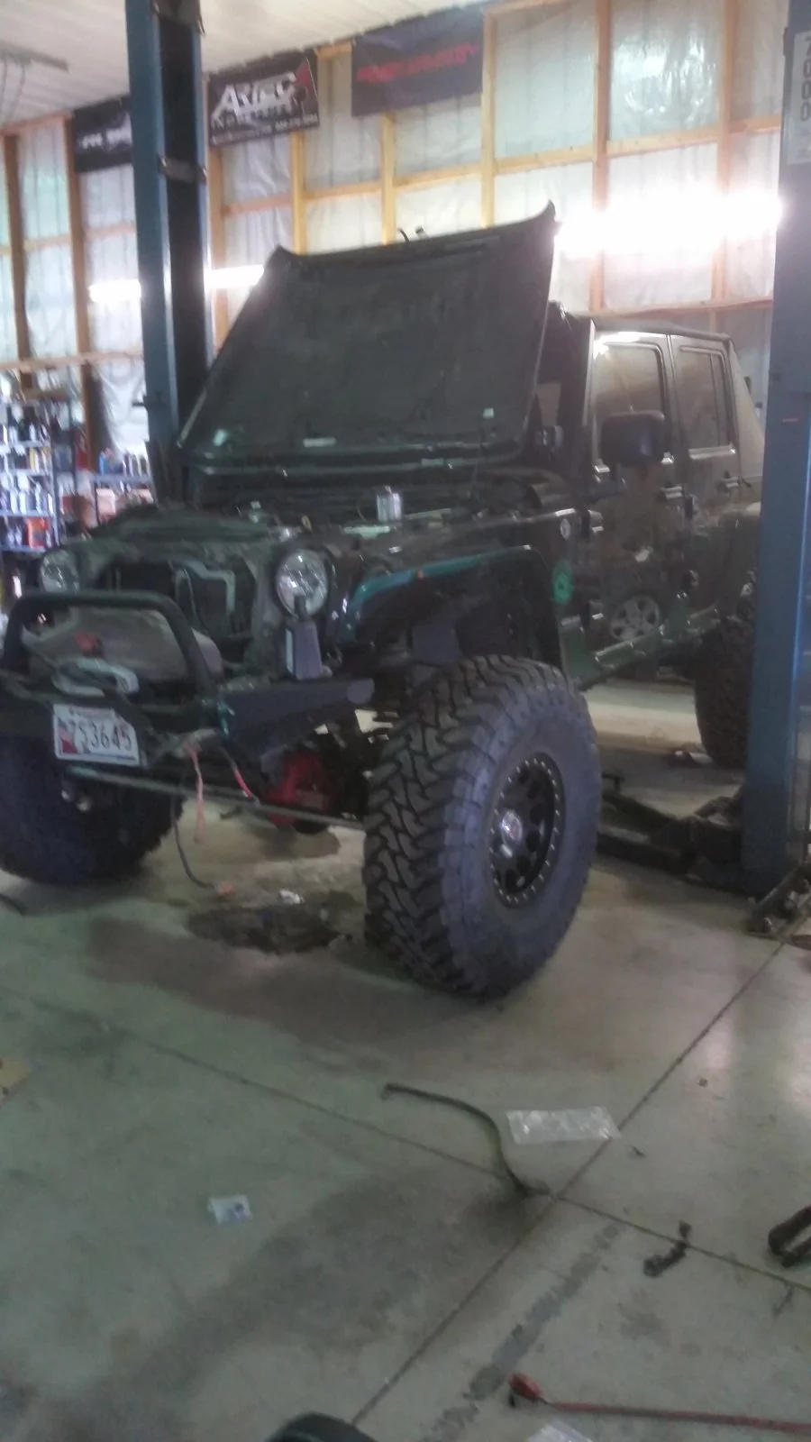

Speaking of Beadlocks.....check out these 40's this young girl had mounted and the necessary mods to roll them.
