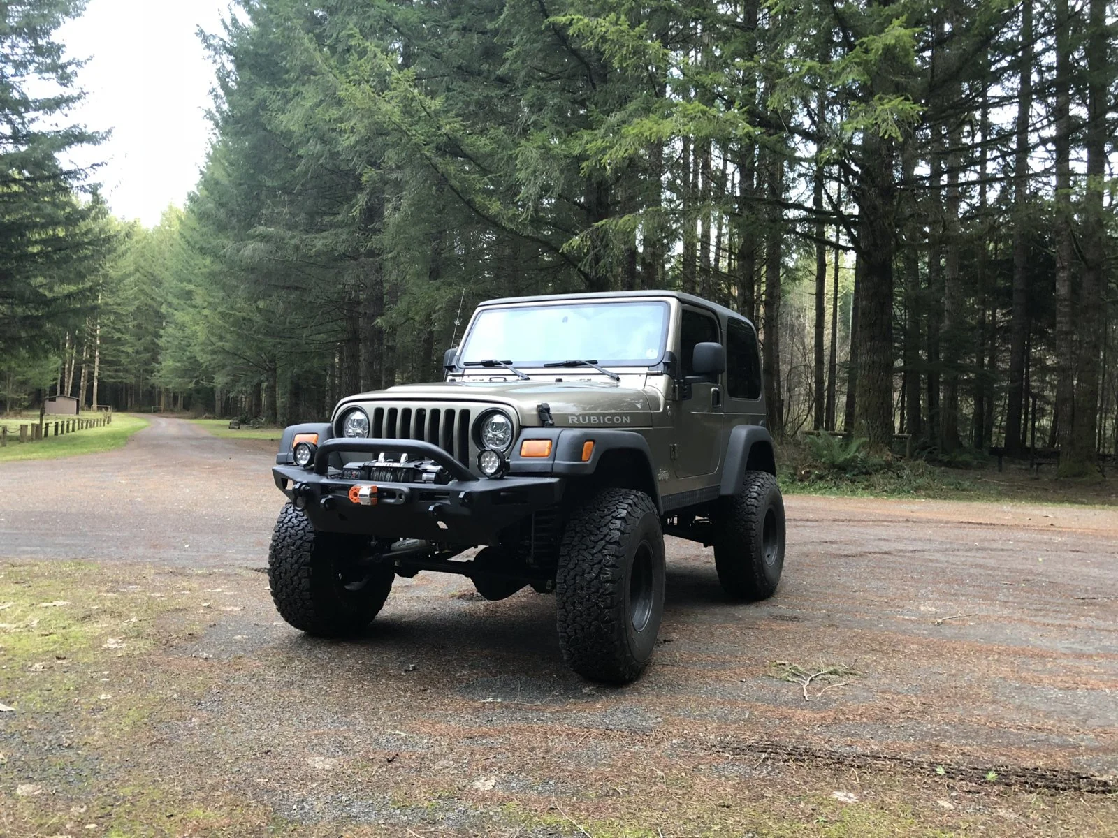

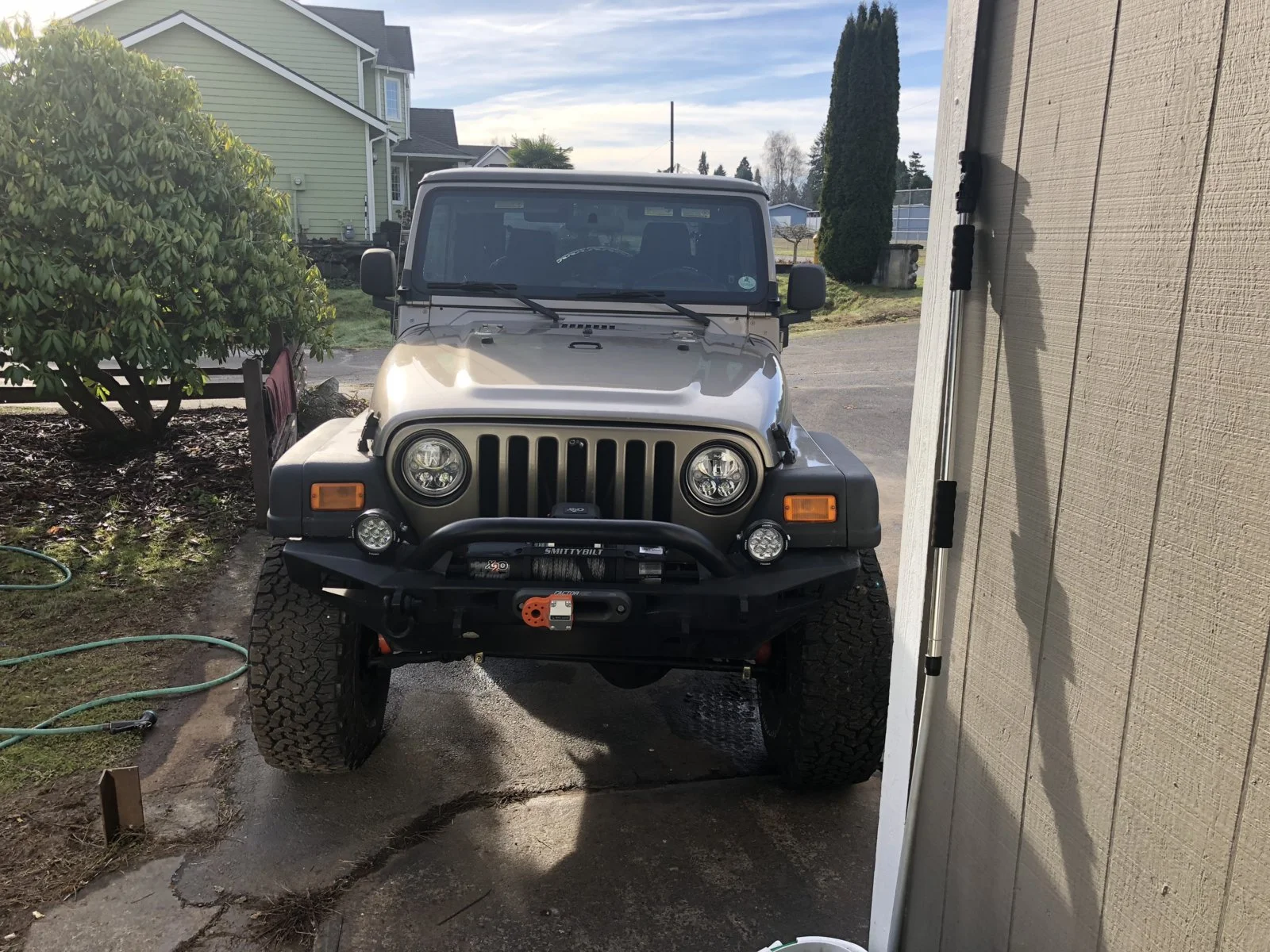

The previous owner of my Rubicon applied bed liner across the front fender for aesthetics. No rust issues. I think it blends some of the lines better with the custom front bumper.
