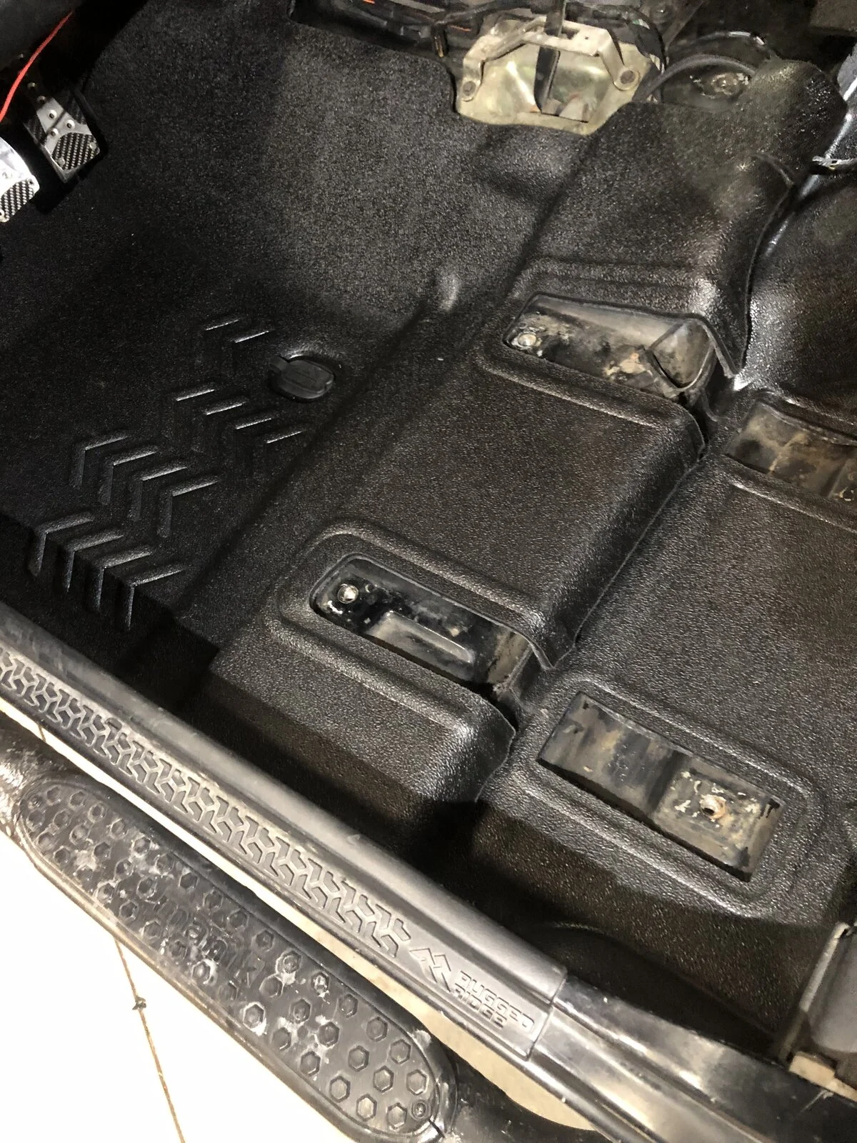

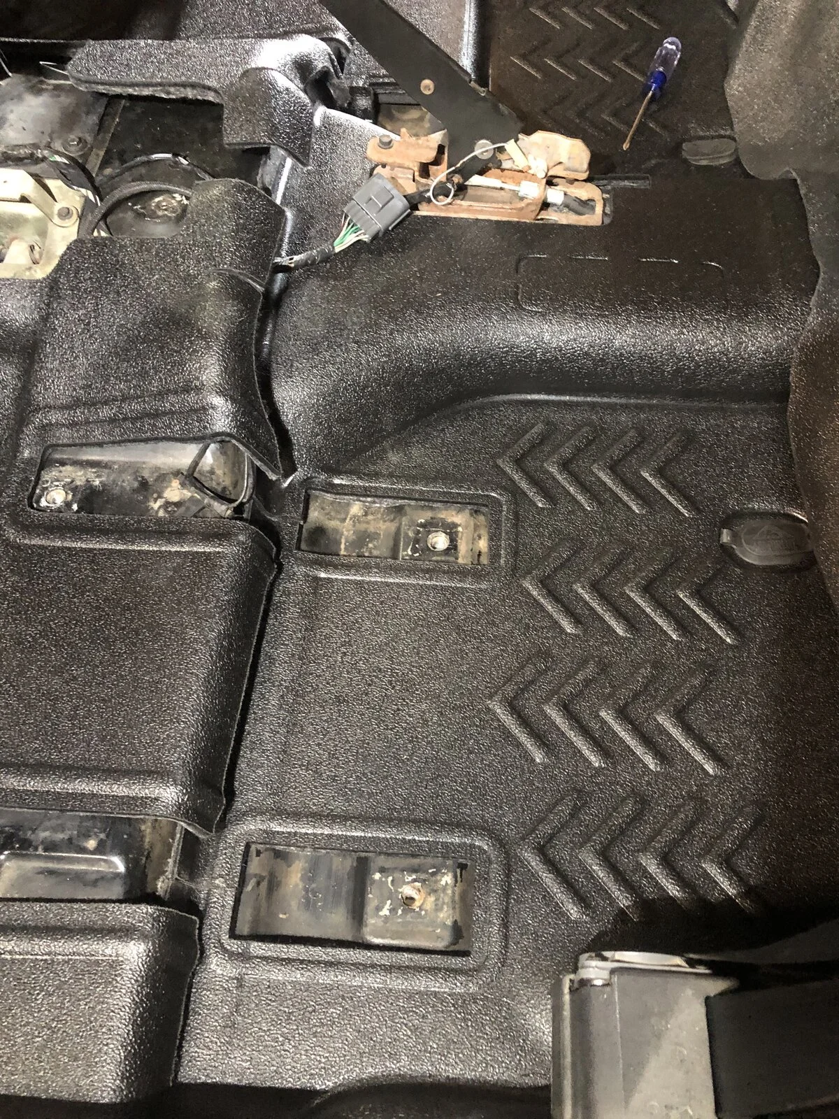

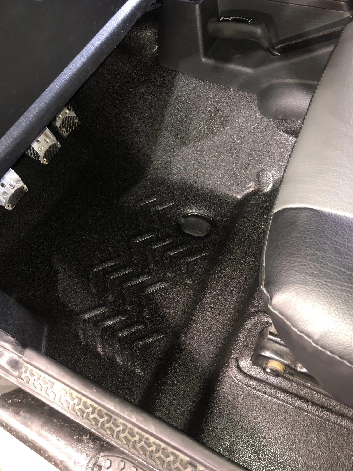

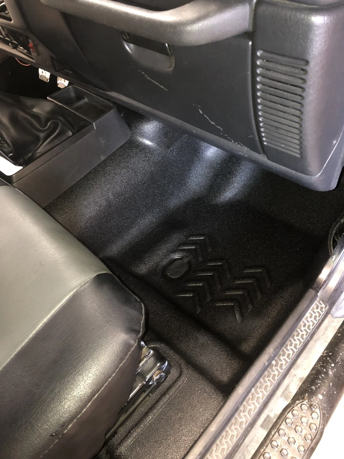

Here it is installed. Gotta say, I’m impressed. Fit perfect. I didn’t buy it for sound reduction but there is a noticeable reduction in engine/drive train noise. The first couple pics are before the seats went back in.

That is definitely on my list. Can you show a picture of the area in front of the back seat?
Anything in particular you want to see? Basically, it goes up to the bottom of the rear area (the raised area). I have a vinyl floor covering in the back that overlaps the new flooring. I’m seriously considering the Armorlite rear mat and inside wheel well covers now.
