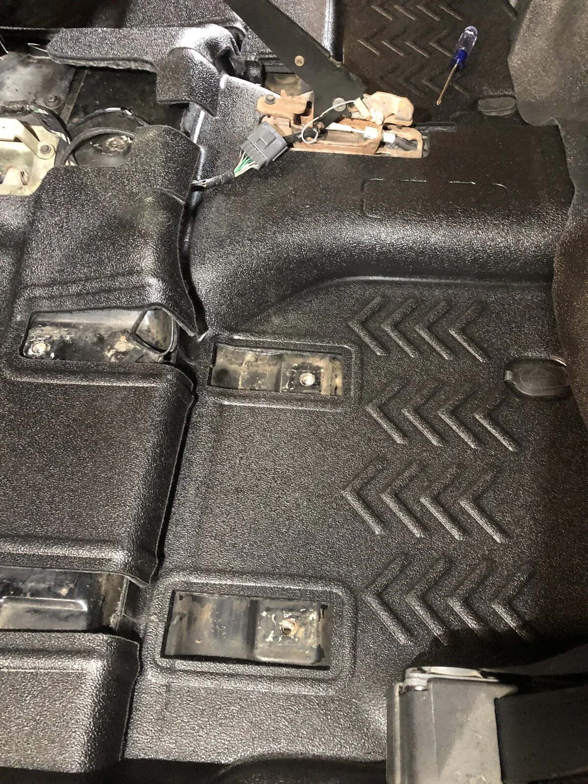

I appreciate all the input even if I didn’t agree! I decided to go with the Armorlite custom flooring another poster linked. I just went with the front and back. Didn’t get the rear bed mat but I probably will get a liner like Quadratec sells at a later time. It was expensive so hope it’s as good as they claim (and justifies the price). I found some YouTube videos, although nothing for a TJ, and the Armorlite flooring appears to be well regarded. I have a shipping tracking number but hasn’t shipped yet so we’ll see when I get it.

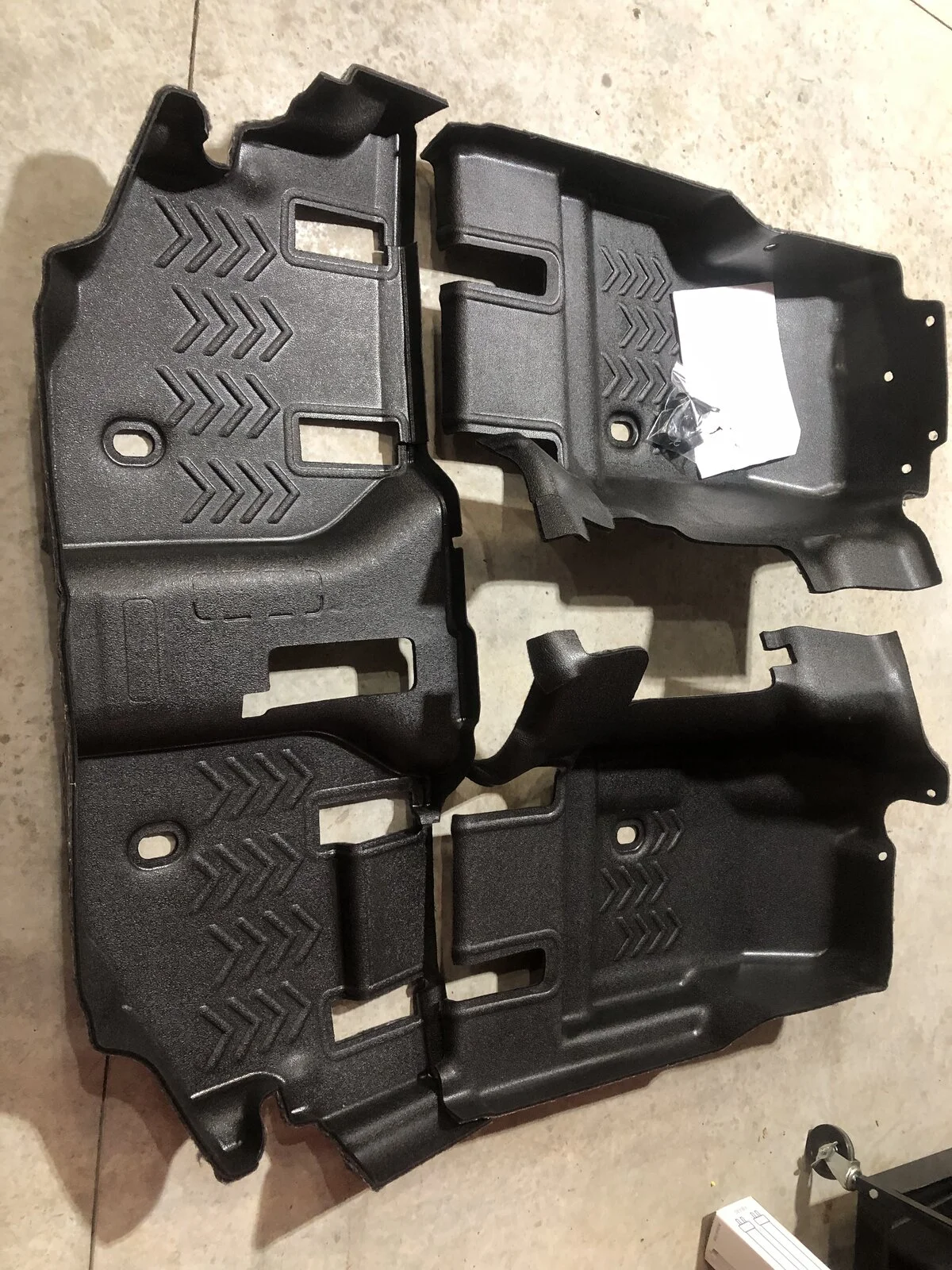

I got the Armortech flooring delivered today. I bought the front and back to start. Wasn’t cheap but so far, I’m impressed. Appears to be very well made. I won’t get it installed before Monday but if I can post pics, I will. Extremely well made. We’ll see how well it fits but just from looking at it, it appears it should fit well. We’ll see soon.

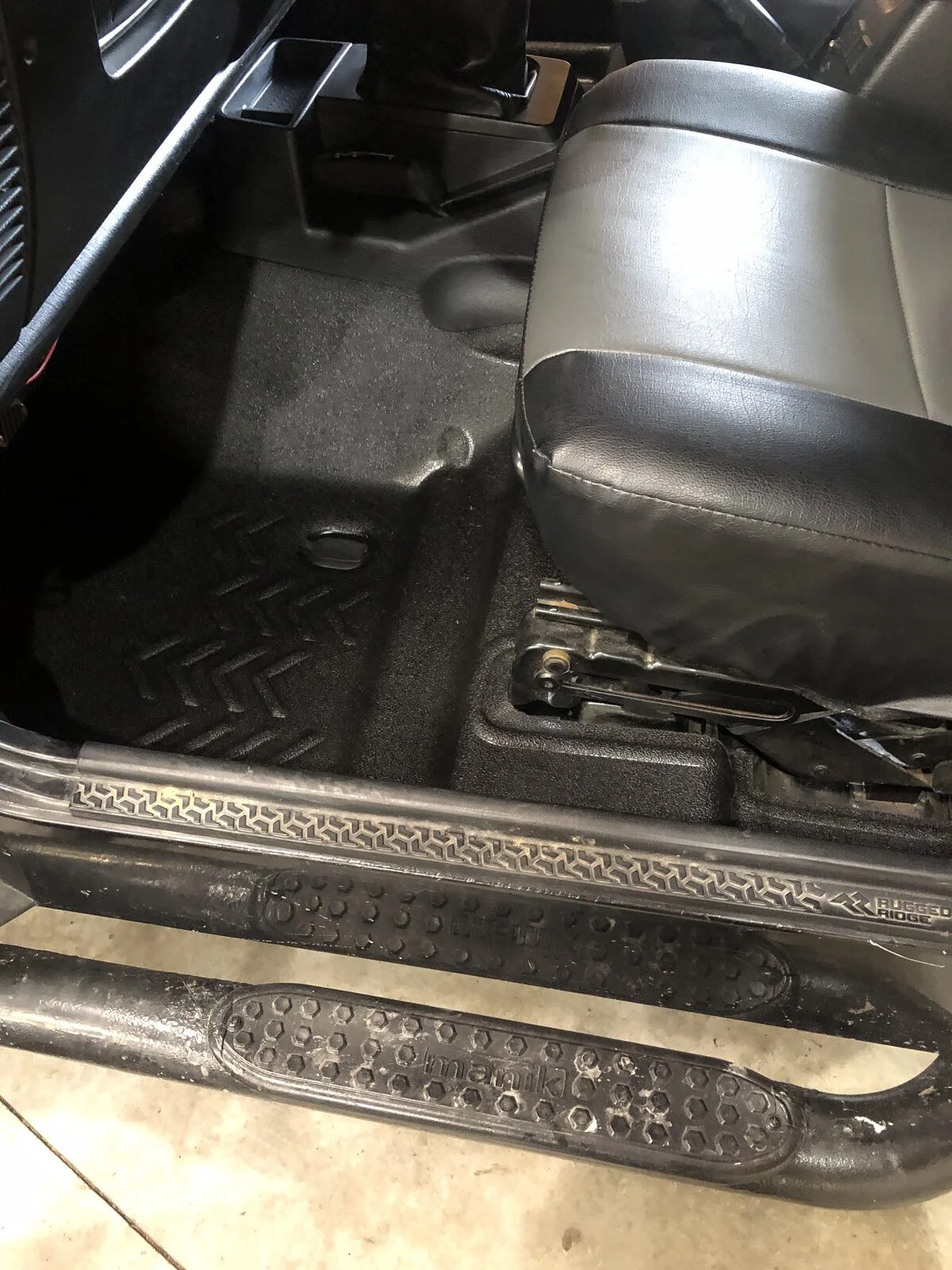

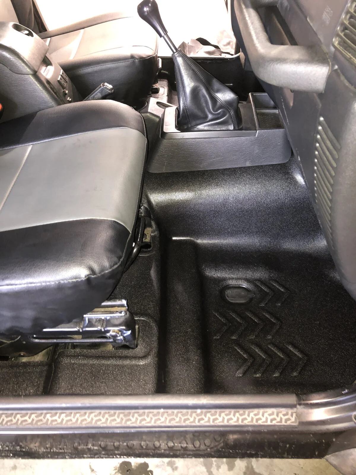

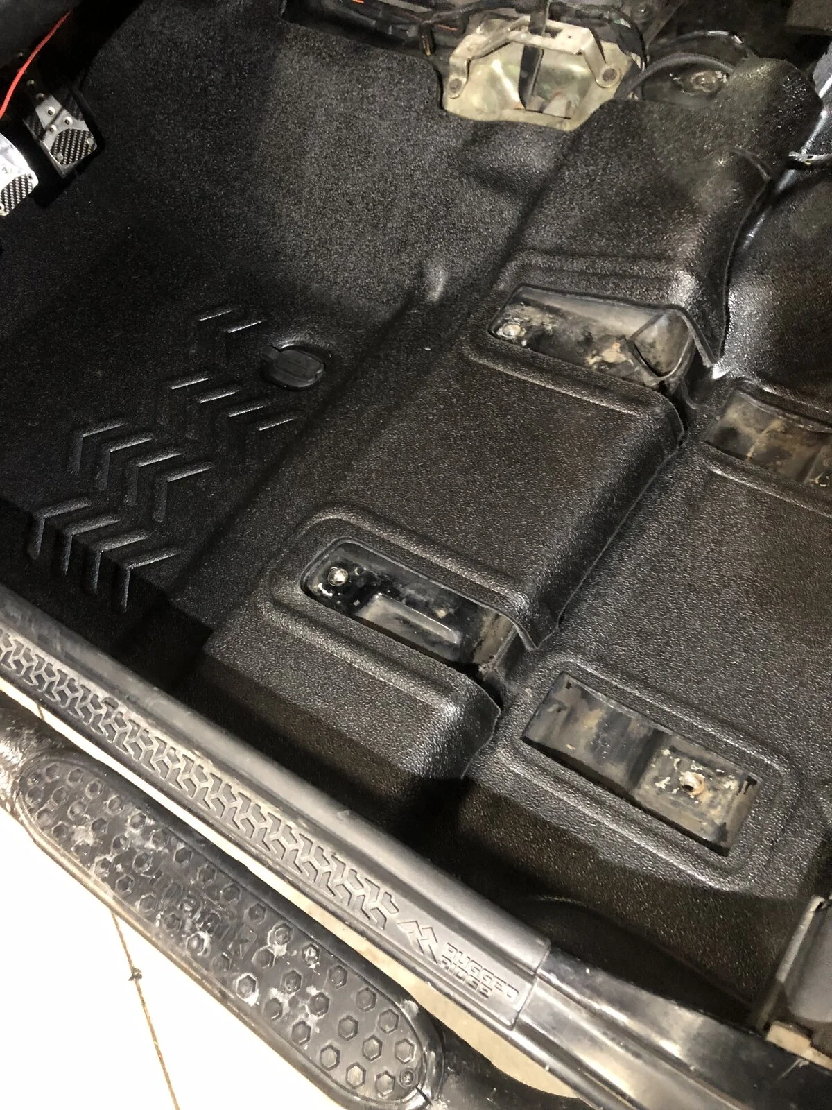

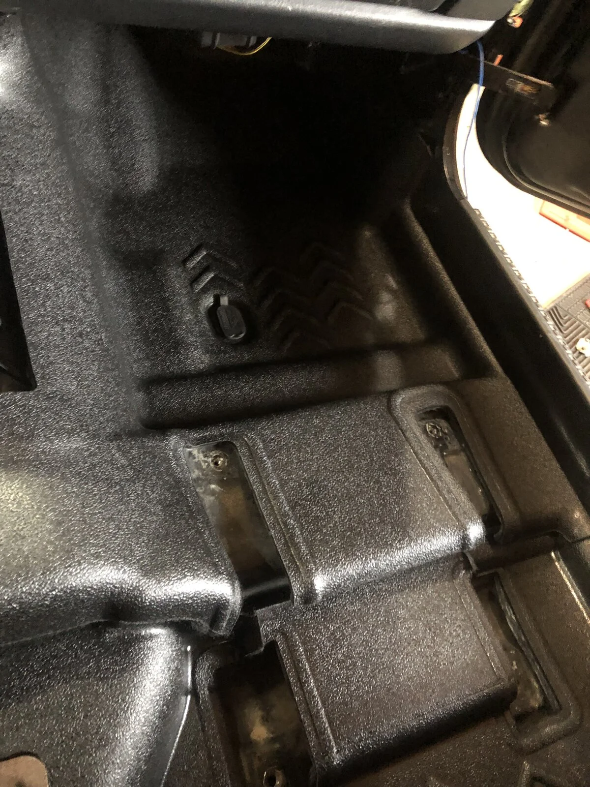

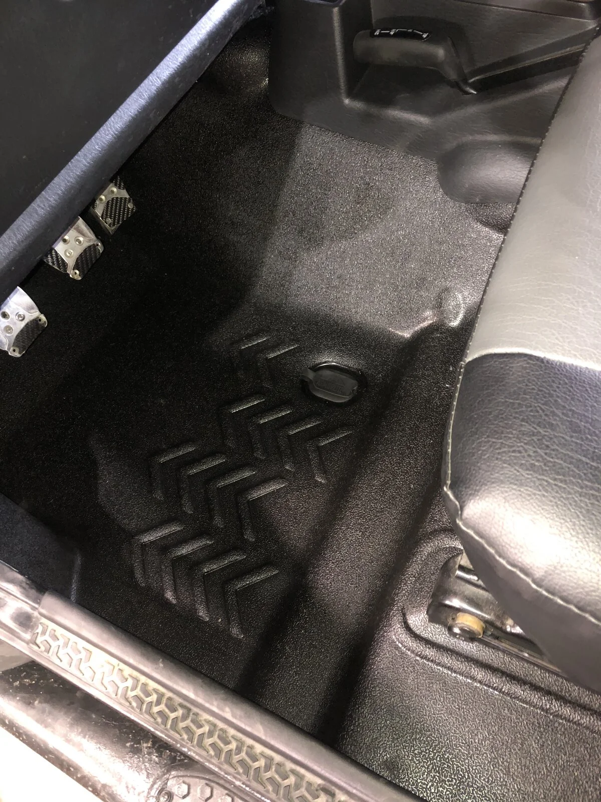

Here it is installed. Gotta say, I’m impressed. Fit perfect. I didn’t buy it for sound reduction but there is a noticeable reduction in engine/drive train noise. The first couple pics are before the seats went back in.
It looks super nice. Would love it in my tj. I’ve been thinking about doing something similar. Unfortunately a bit expensive though as I’m trying to get new tires soon! Might end up settling for a bedliner
That is definitely on my list. Can you show a picture of the area in front of the back seat?
