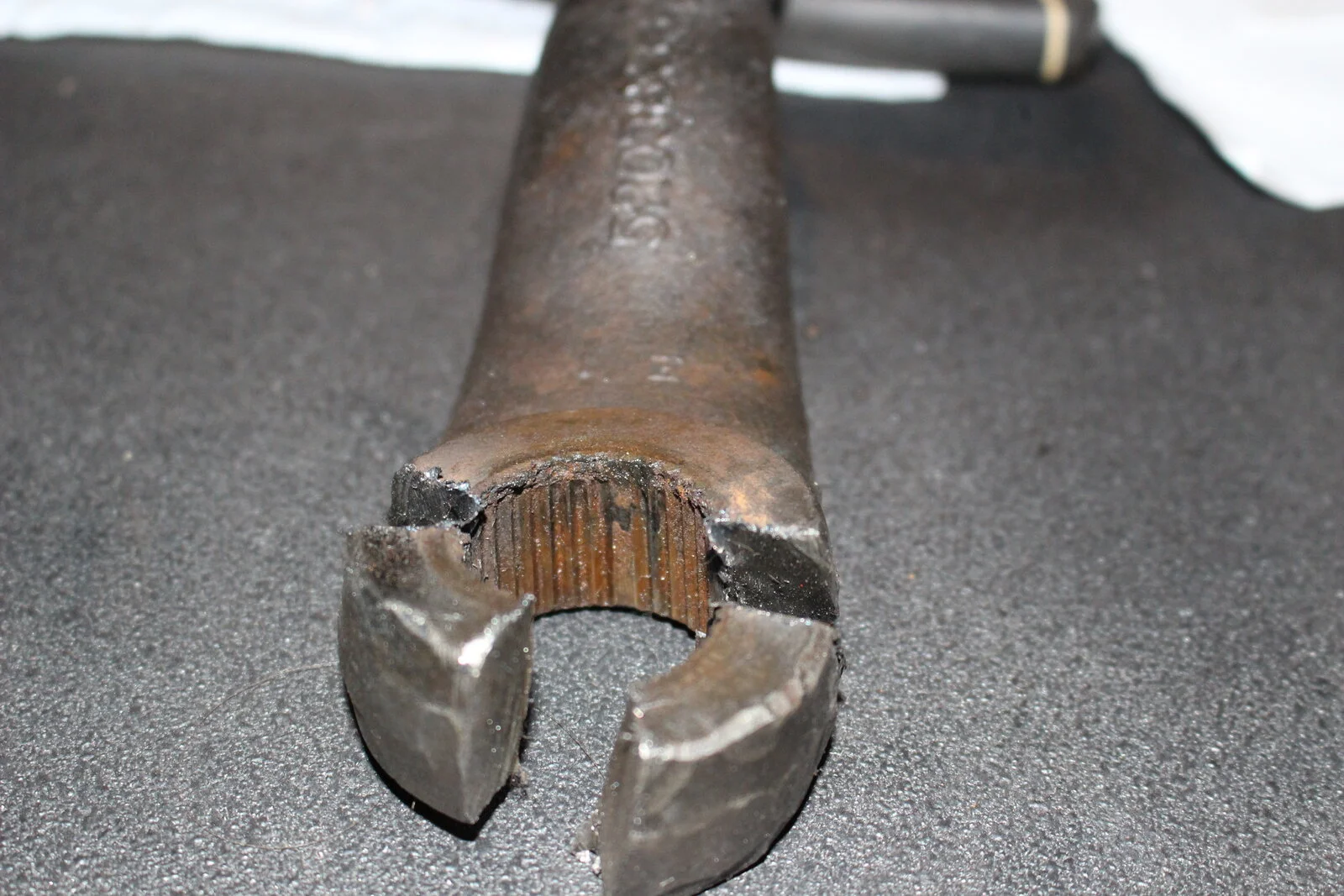

When I was installing the new Drag Link, the old Pitman Arm wouldn't come off and my puller couldn't get the tie rod end out, so I ended up cutting off the old pitman arm. It showed signs of having been beaten (severely) with a hammer by the previous owner, perhaps that explains some of the slop in the Steering Gear Box today?

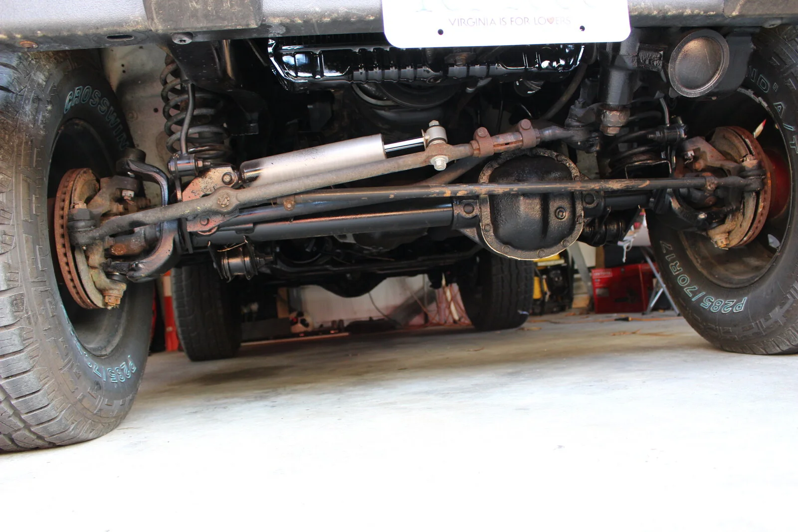

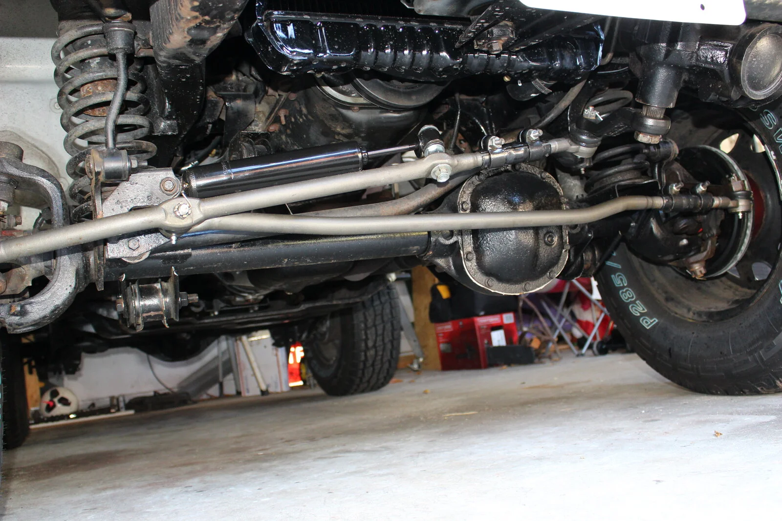

Before & After pics attached.

I plan to paint my Moog parts because they look like they are bare steel and will start to rust easily.

Yep, I’d recommend giving those a coating of self etching primer spray and a few coats of spray paint
