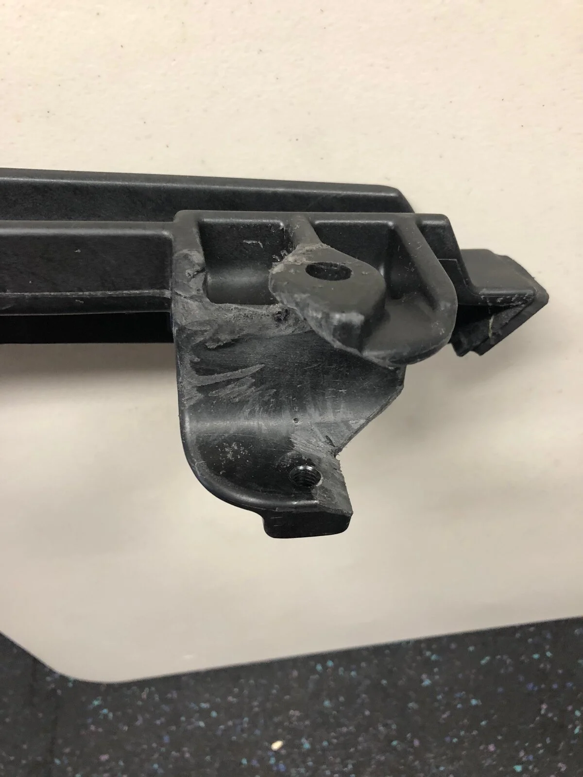

I am in the process of installing this top on my TJ with the Genright Cage. In order to get the door surrounds to fit, I need to “trim” the forward cage mount. Anyone have one of these that they installed? I would love to see some pictures. Genright is pretty much useless with information. As usual, they have no pictures, instructions, etc.

“Well, none of us have our tops on right now since it hot in Cali. Notch the bottom front half of the door surround to make it clear the a pillar to go down the windshield. You will need to trim off a couple inches on both sids across the back window to get it to sit flat and zip up.”
Which is fine but some pictures would really help.

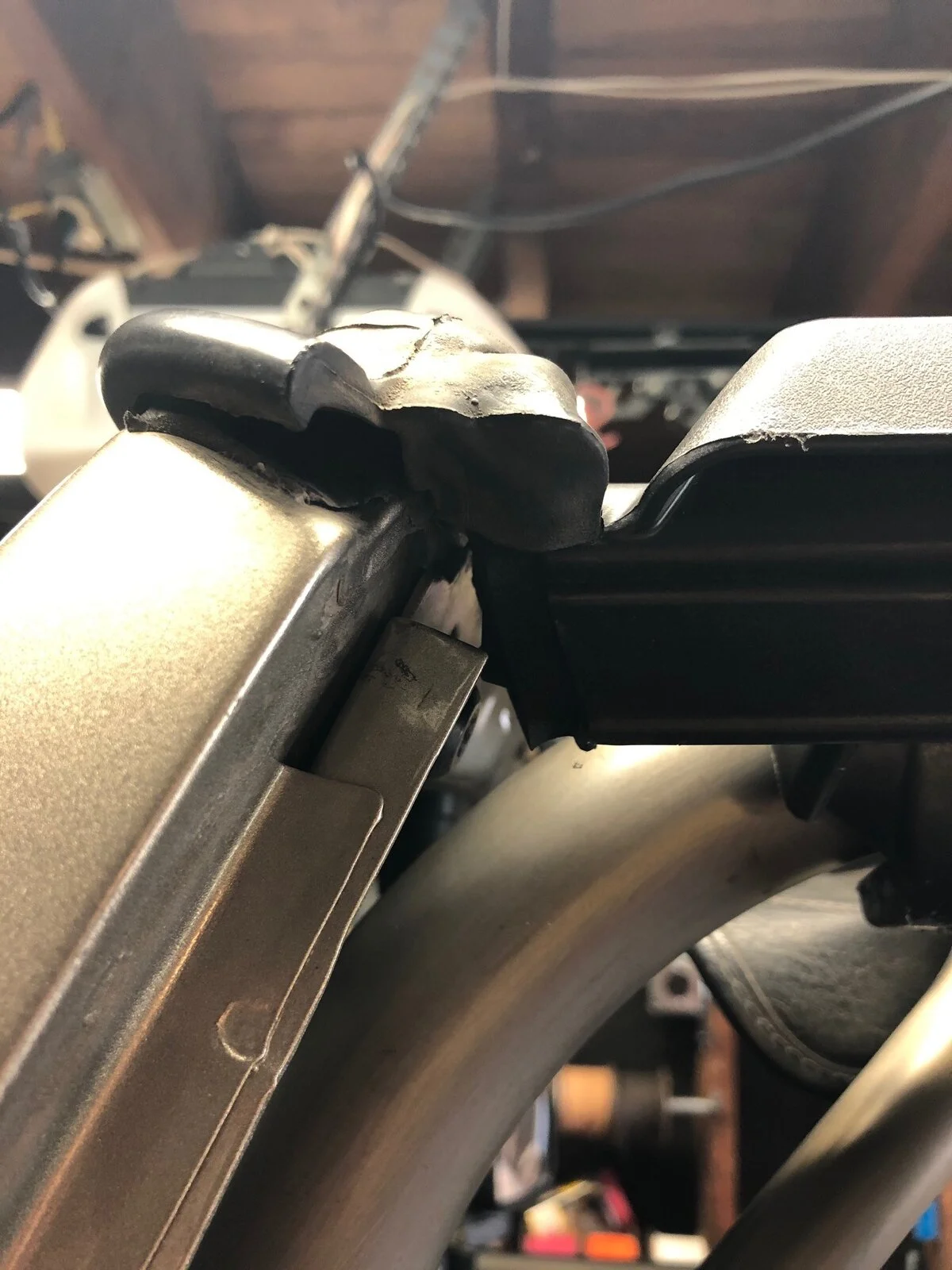

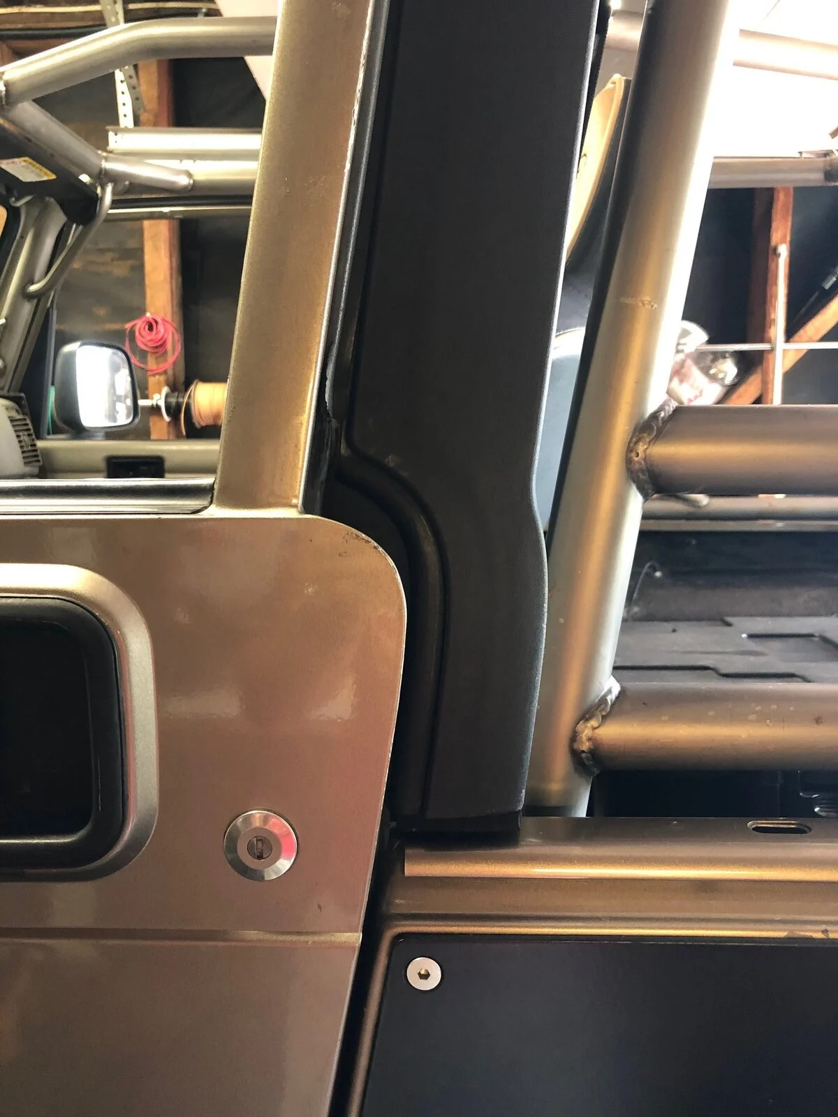

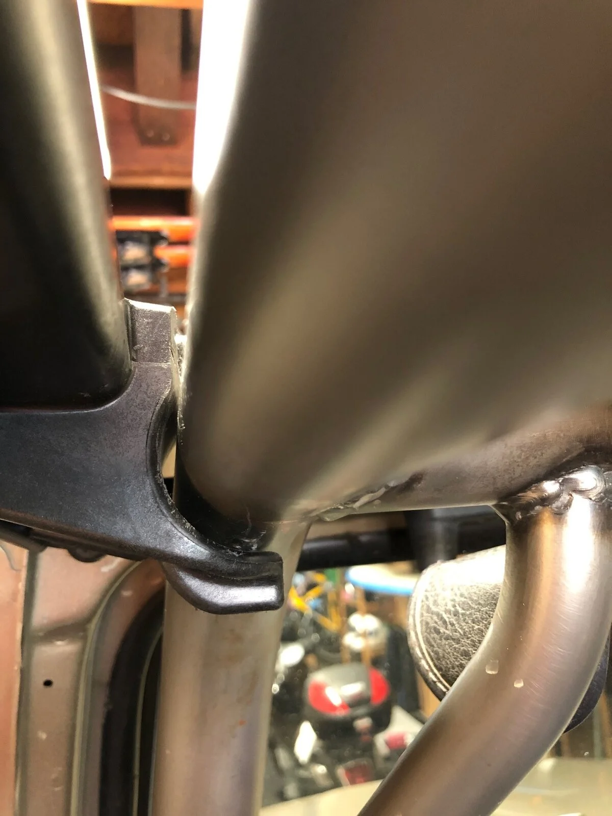

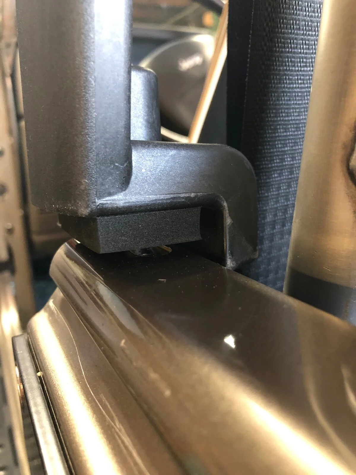

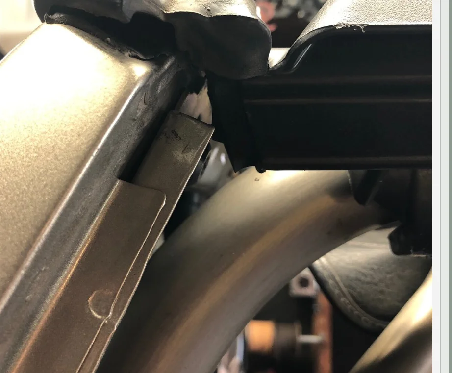

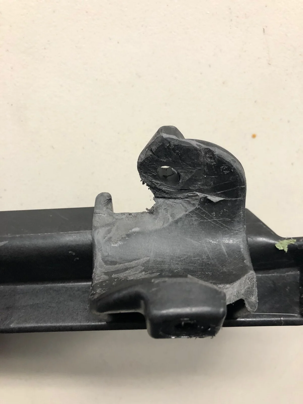

So please excuse my ignorance. I'm usually pretty good about figuring this stuff on my own but I would really benefit from some advice here. Here are pics of what I got. I trimmed up the forward surround mount to get it to fit but I'm not sure what the final product is supposed to look like and I want to 100% sure before I drill holes in the cage.

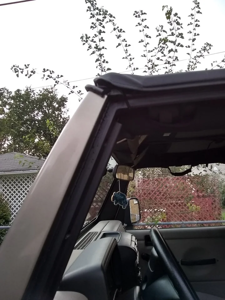

As you can see, the door surround doesn't sit on the tub rail, nor does it reach the windshield. This particular cage was welded and installed by Genright so I'm going to assume that there is nothing wrong with the installation. The cage does NOT connect to the windshield (the brackets they sent me don't fit :rolleyes: ) but I'm guessing that if I can make some brackets, I might be able to suck the windshield back a little to close that gap.
Anyhow, here are some pics. Hopefully, I can get some assistance. This forum seems like my best bet as getting some answers.
1st it looks to me like your missin the window trim that meets up to that
