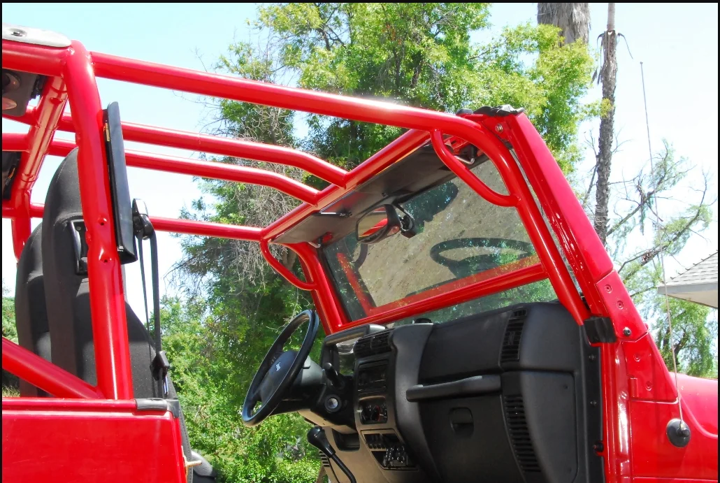

Not with the dash out but the pic should give you an idea of how far we pushed the tubes forward and over. They are right against the inside corner of the sheet metal.
Here’s a couple of pics from when I did a Poly cage in my old Unlimited. The dash bars are way, way easier than it looks in the pics. The only trimming was the dash pad corners and minor cutting of the metal dash support, I don’t recall doing any modifications to the vents at all.
Who said you had to have a dash?
