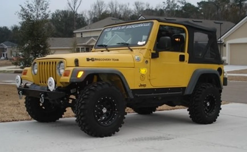

I have a 2001 TJ with a 2" lift. I currently have the stock rims with a tire size of 31x10.50x15....I bought rims from some that are 16x8..what would be the biggest tire I could put on this new rim with my current lift without modifying all the other bells and whistles? I would like a tire with a more aggressive look also. Thanks in advance.
The biggest tire depends upon the Offset or Backspacing of the rims.....
Probably around a 31" (245/75-16) tire IF you are not installing spacers or longer bumpstops.
Get 31" MT tires for a more aggressive look. Tires for 16" wheels will cost more also.
