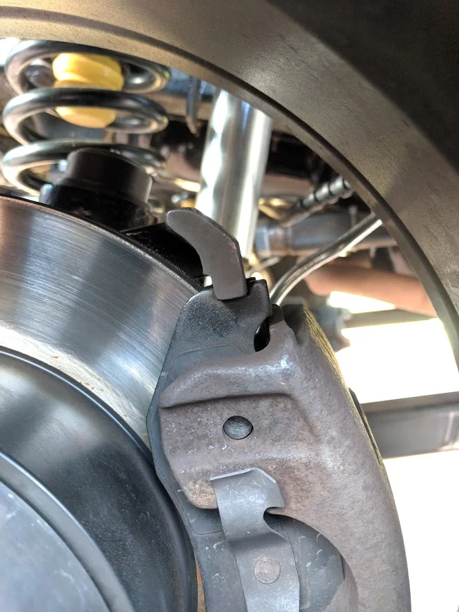

Double check their orientation, like has been mentioned--these are absolutely quiet when broken in correctly.
This is the wrong way to have the pads.
Two sets of BMB on my past Tj, and a big brake kit on my present Tj's, not a peep out of any of them.
