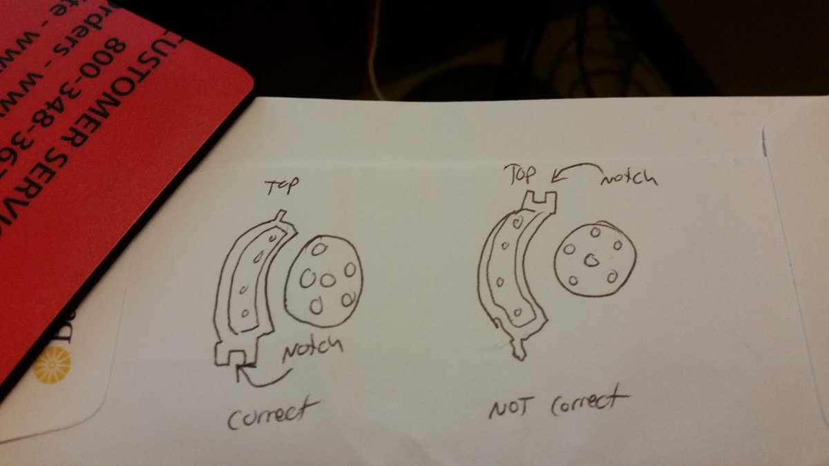

Mr Blaine.Yeah, they are upside down.
The pads are oriented in the caliper so you have to drop the lower end on the slider first and rotate the top of the caliper forward to seat the pads on the slider. If you put them in upside down, they wind up on opposite sides of the vehicle which means they can go in either way.Mr Blaine.
Forgive my ignorance but what do you mean by these being upside down? My black magic pads on the right side are starting to have the same issue.
I'm am amateur wrench and was under the impression pads could o.nly be put in one way. I actually had a local shop put mine in. Do they just need to swap places in the caliper?
Would love to hear what you have to say.
Your non computer aided drawing is exactly the visual i needed.Forgive my non computer-aided drawing.View attachment 123670

If the fork is up, can you set the caliper with pads on the lower slider and rotate the top forward to install the caliper?Mr. Blaine, partial answer, at least from me. When reading the responses from the OP and yourself, when you mentioned that they were upside down (and not listening to your installation instructions), I struggled for a while to find exactly what was wrong on the pictures that were posted. Took me a bit to finally figure it out. I consider myself to be well above average when it comes to working around the garage. (I can give references, LOL.) But I had to ask myself, "Why am I not seeing whatever it is that is wrong?" Once I figured it out, I understood it this way: the end of the pad with the "fork" goes down, the end with the single nub, goes up. (a more layman's explanation?)
I guess but I can NOT for the life of me figure out how anyone can look at a brake pad that can only be installed by placing the "fork" on either slider and then the other end slides in and not tell that. The caliper simply won't install without the "fork" going on first. If it has to go on first, then it can only go on top first and rotate the bottom forward or bottom first and rotate the top forward. There are only two ways it can go, one is right, one isn't.Nope.
But look at it this way, as I did. Going only by posts #1 through #11 where you identified that they were upside down. If someone read your post, and then went back up to the pictures, as I did, and tried to see in the picture what you were seeing, that is where I was, LOL, not seeing it. Hadn't gotten to your post (#24) yet explaining the caliper installation.
