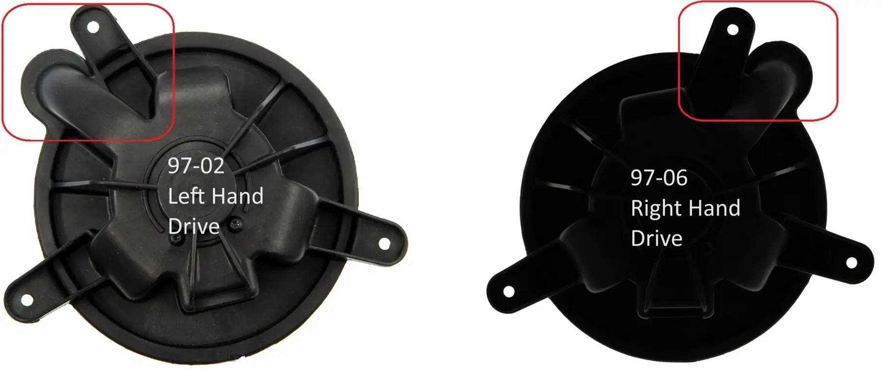

I don't know if you are aware, but the RHD blower is mounted behind the battery. In later LHD models the fan motor is accessed under the dash. In RHD models the HVAC unit remained a mirror image of the early model HVAC units.

When I mentioned that the HVAC system in RHD models is a mirror image of the early LHD models, that also includes the blower motor. It is an exact mirror of the early LHD blower motor right down the the shape of the fan vanes and the direction of rotation. An early LHD blower motor will not fit.

Here's a pic I made previously that shows the motor being a mirror image.
