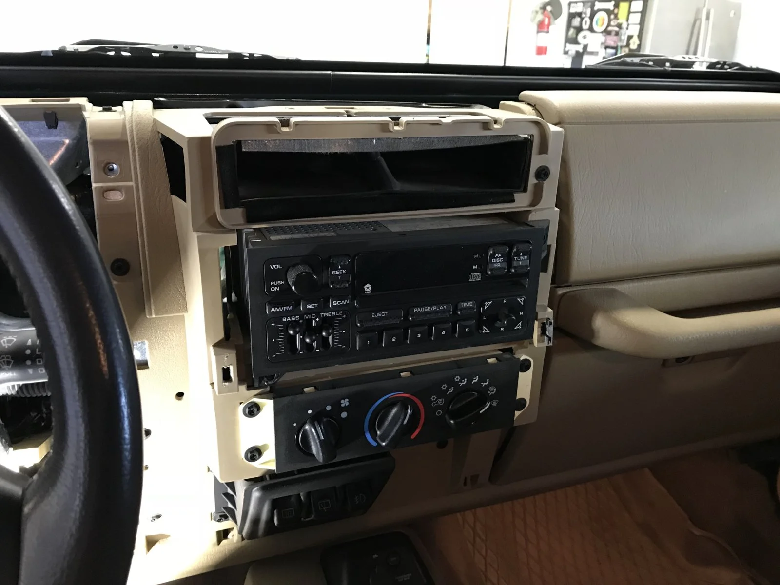

I decided to get some better sounds this weekend. I had already installed Polk Audio speakers. Now I wanted more power and Bluetooth.
Enter Kenwood 400w marine amp:
Comes with a Bluetooth controller. I wanted to stick with the factory radio. Sentimental I guess.

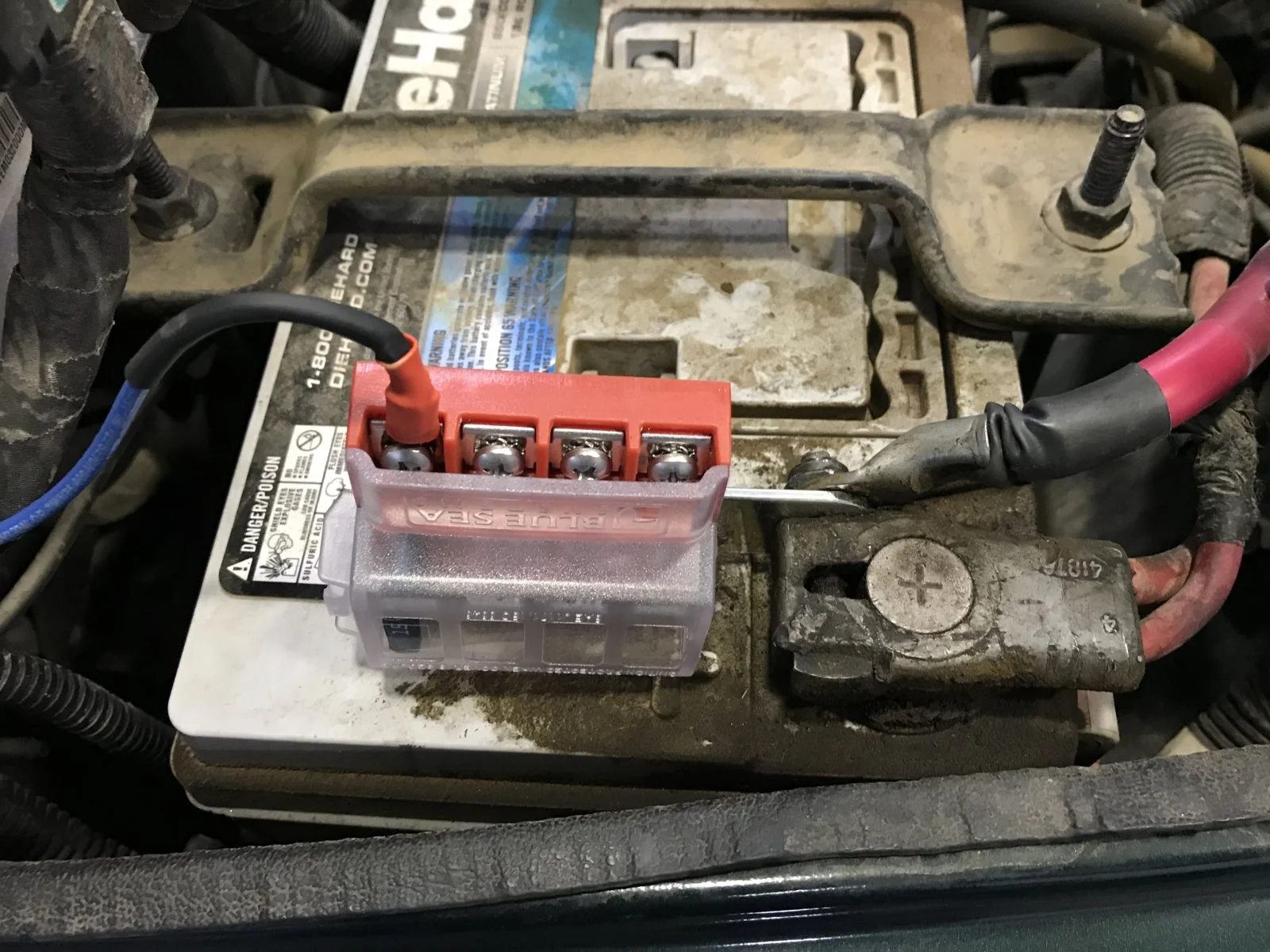

First step, add a mini fuse box to the battery:

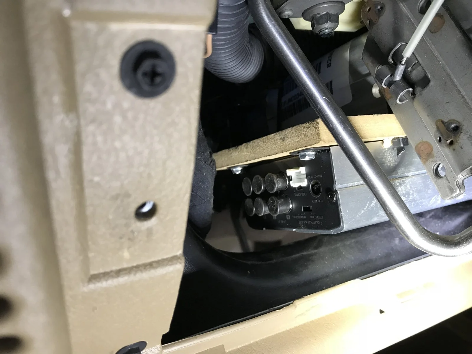

Next step, mount the amp to a board and attach to steering column:

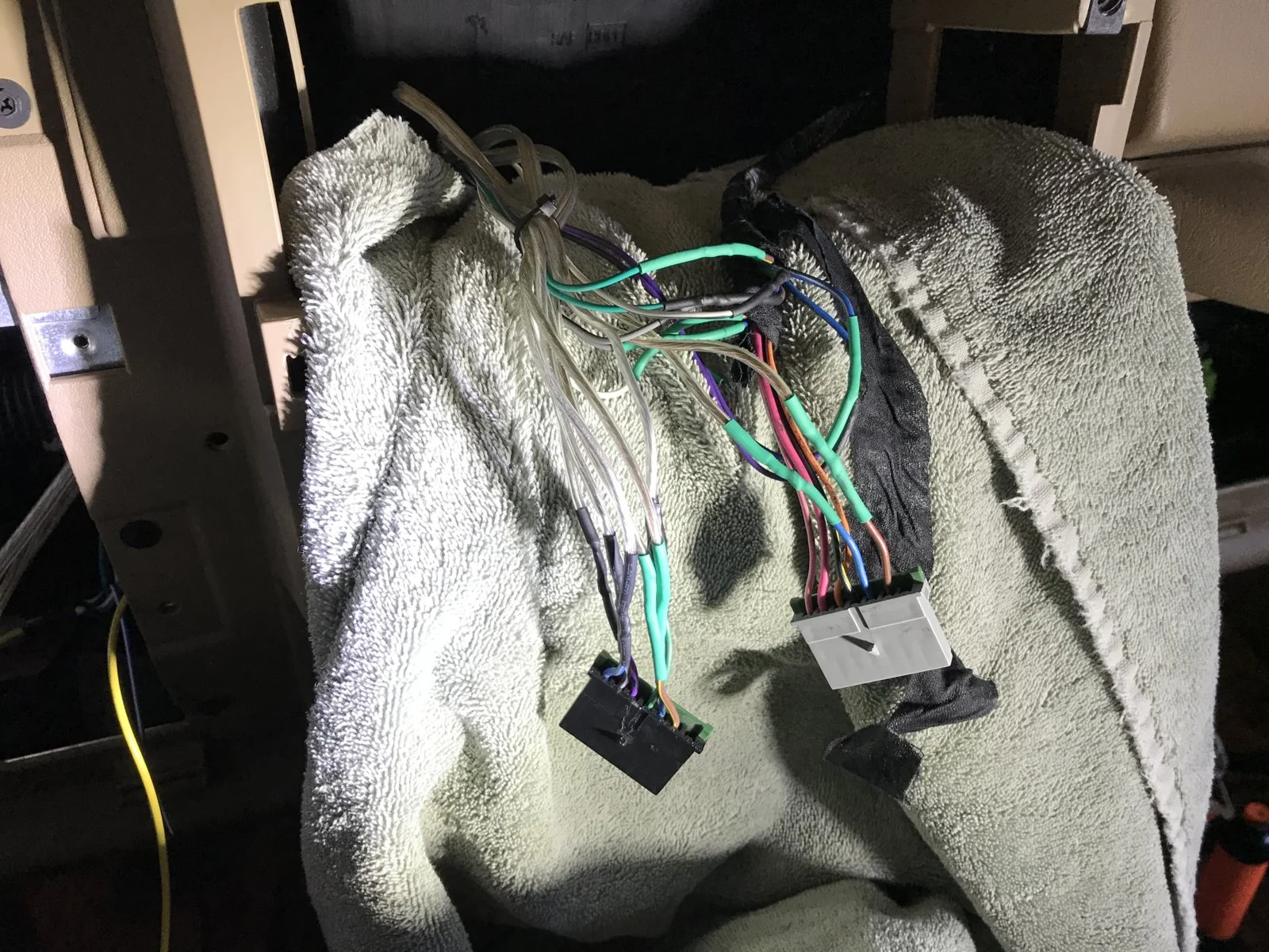

Now for the hard part. Tap into the factory harness. I always solder and shrink tubing. 8 cuts, 16 solder joints.

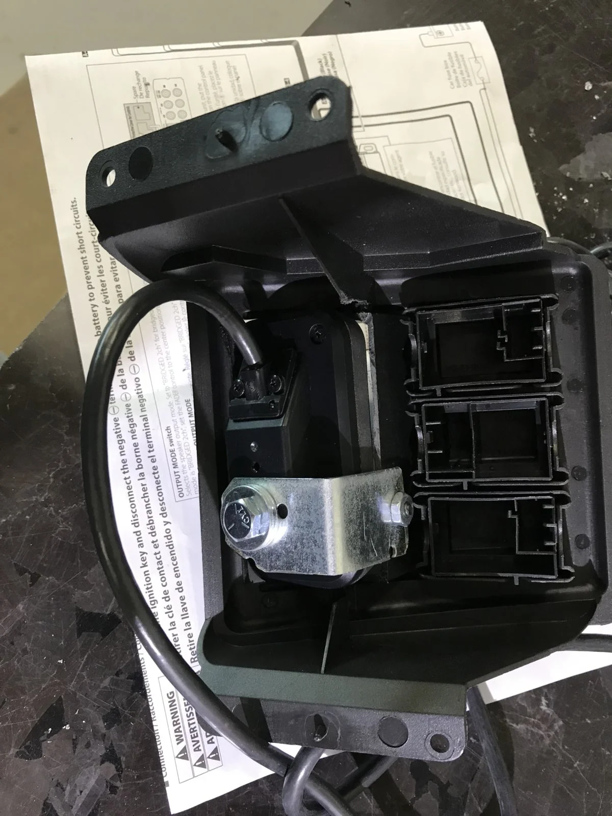

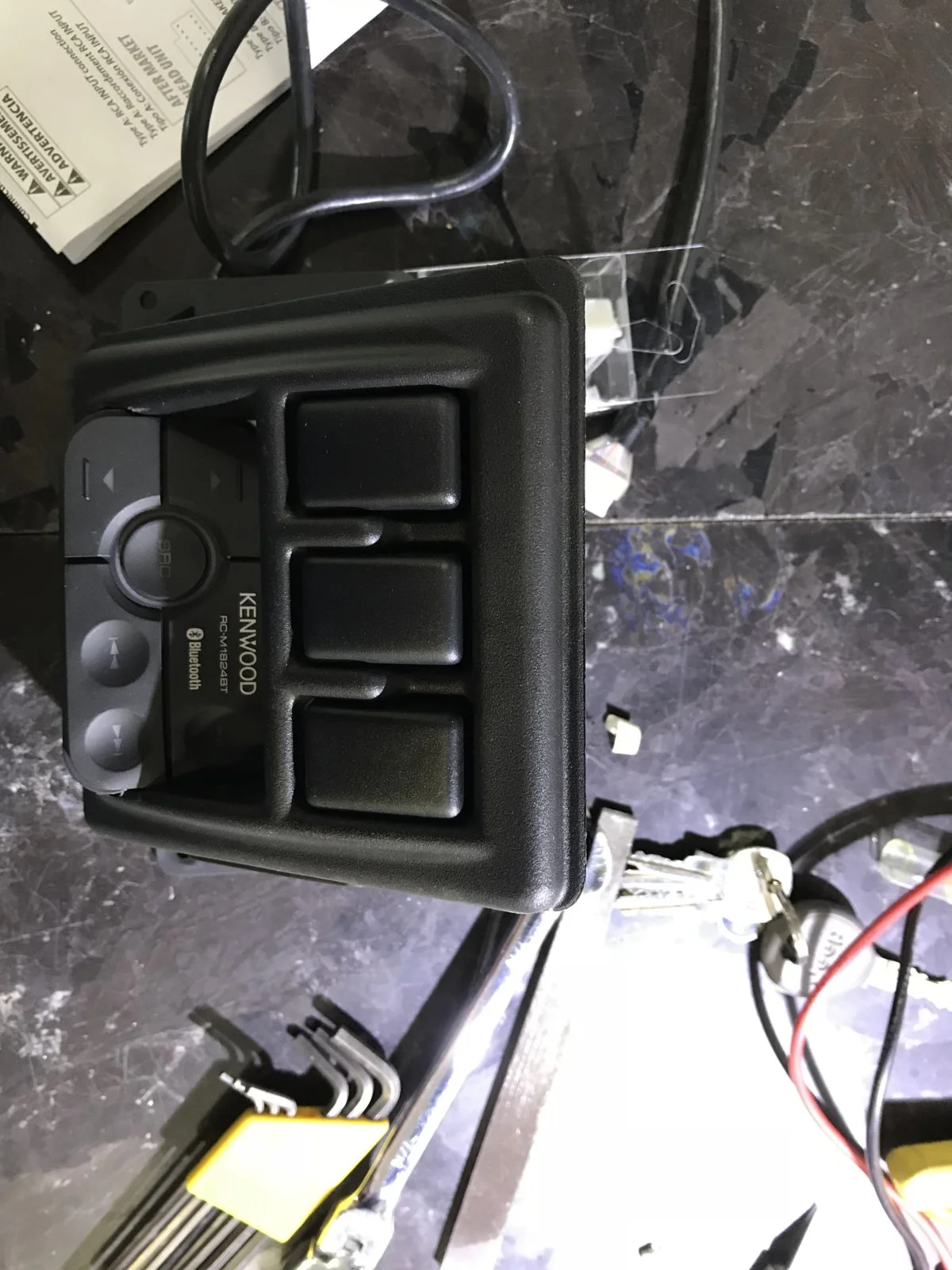

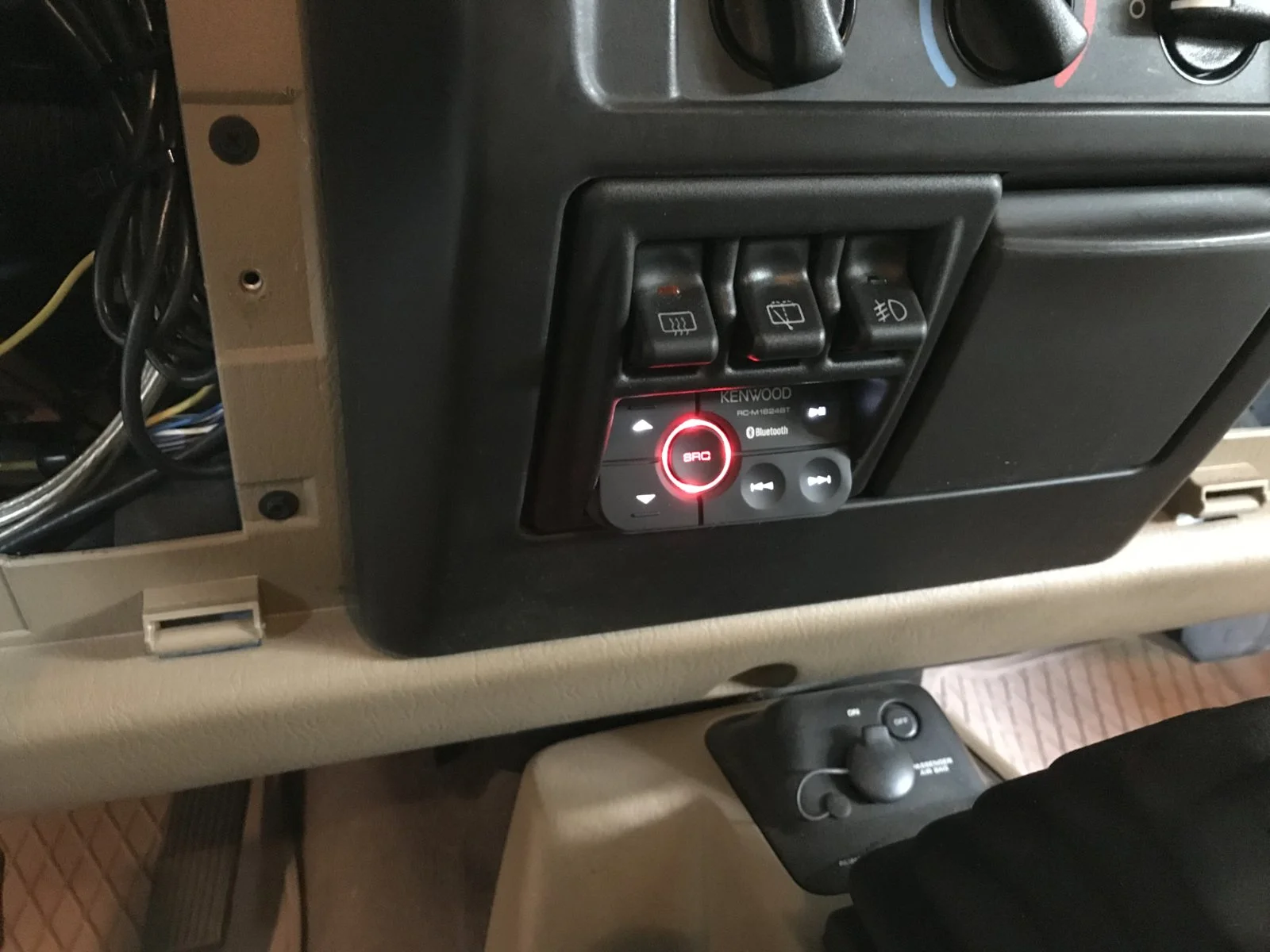

Now to mount the Bluetooth controller. With some careful cutting with the dremel I got it nicely tucked into the switch panel:
Really liked the way that came out. The amp has a usb for charging the phone, so I won’t miss the lighter outlet.
The amp really makes a big difference and I love having Bluetooth now. Highly recommended amp.
Hi Todd! Could you possibly go into more detail on how you tapped into the factory radio harness? I would like to do this mod but I am very much a novice when it comes to audio wiring. Which wires were cut and soldered from the factory harness to rca for the new amp?
Crutchfield has a lot of wiring adapters the plug into the factory plugs and give flying leads. If you're not familiar with soldering I would give them a call and see if they have something first.
