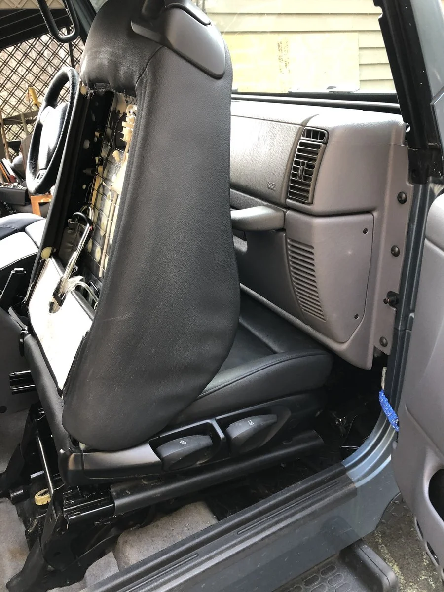

Got them dry fit today, looks like they need to go about 1 1/2" inbound. So much for measuring.

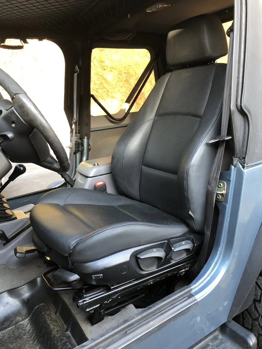

Okay, I don't think I have any more pics, but I'll check. Key notes are the factory seats (at least on a '98) are not centered. So I believe my adapters got re-drilled inbound in the front only, about 1 1/2" as stated above. These are the manual seats, so the only thing elec on them is the side bolsters, which I did not hook up because they fit like a glove as is. I gained a little height over stock as well which gave more visibility over the hood.
If anybody has any specific questions or wants pics, post up here or PM me, I'll keep a closer eye on WTJF.

How has it been holding up @scottgraham
Have you made any new modifications after moving it up. How’s the comfort been?
