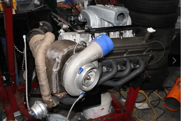

Banks has the turbo kits at 10% off right now. They are a little cheaper than the blowers and they are comparable in power. Plus they are TURBOS! Sorry I'm a turbo guy. My home brew for my '67 Mustang. I may end up with a small DIY turbo at some point.
