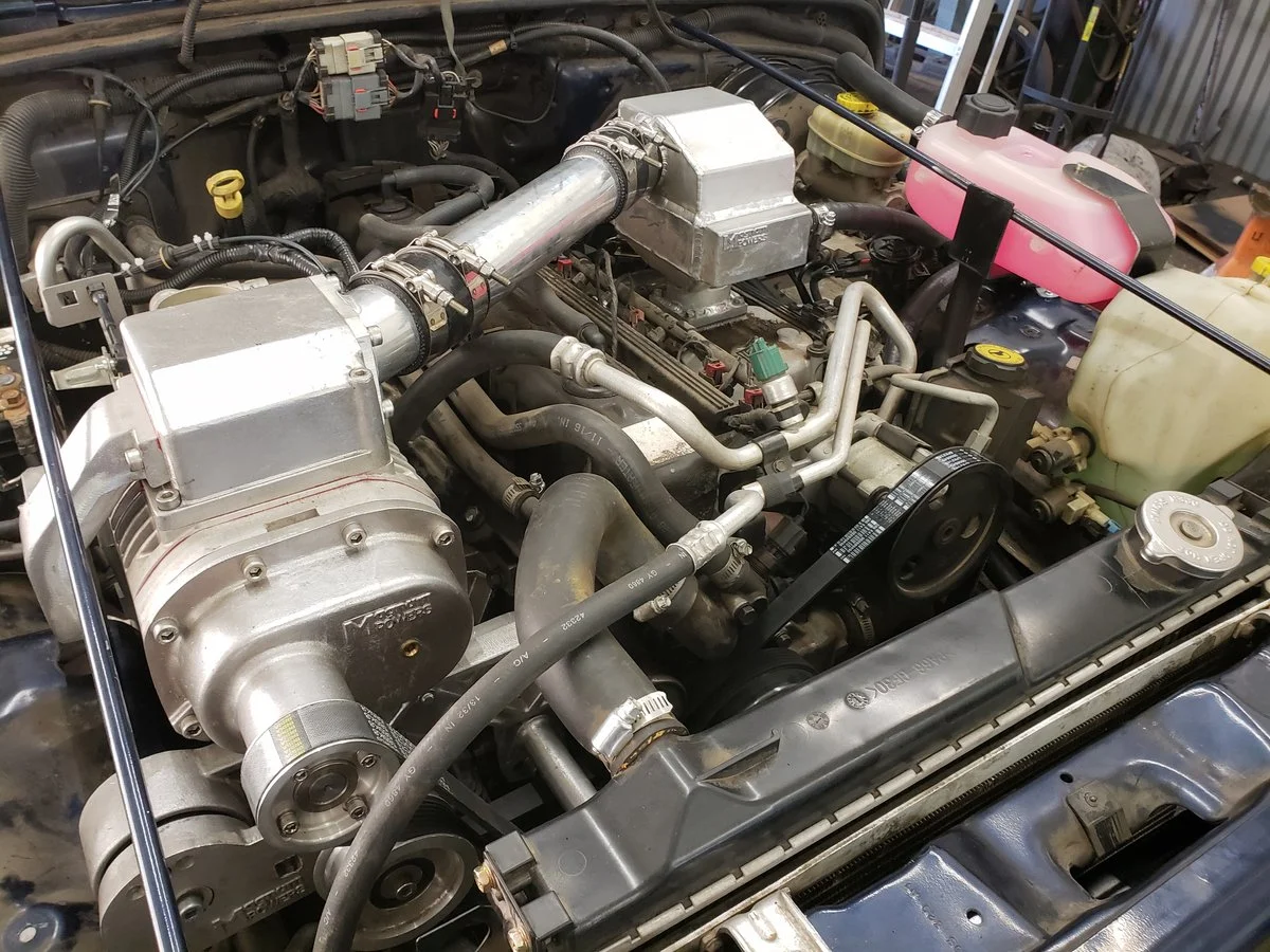

We are in the process of running a unichip on the magnum powers units now and they will be sold with with the kit having a good base tune with a stock engine. My 05 LJ is being tuned now in Beaverton.
We also have 505 performance stroker that will getting a unichip running 25psi in an 04 tj.
It looks like you've got it on meth?
No, meth.
Mopar coolant in the early Cherokee reservoir bottle. We're stepping a few things up to make a easier install and likely putting AIT and map sensors in the bottom of the intake charge air cooler.
I'm interested in seeing more details and charts.
If you can figure out how to fit an intercooler, power steering, and large transmission cooler in front of the grill I'd be very interested. I think it'd have to be a custom one piece unit of some sort?
Reactions: Kevlarr
we haven't even messed with trying a put a air to air intercooler in yet besides a cheap e-bay turbo kit mounted on top of the engine we did. the water cooled charge air cooler works well but does get warmed up. a psc dual cooler bracket seems to work fine for the transmission and steering.
