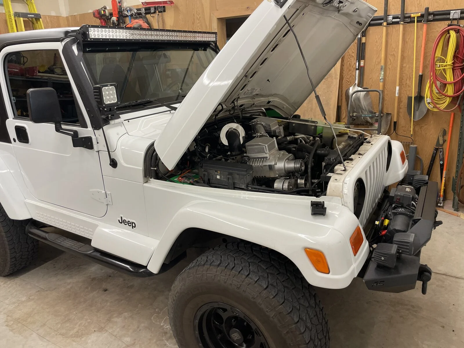

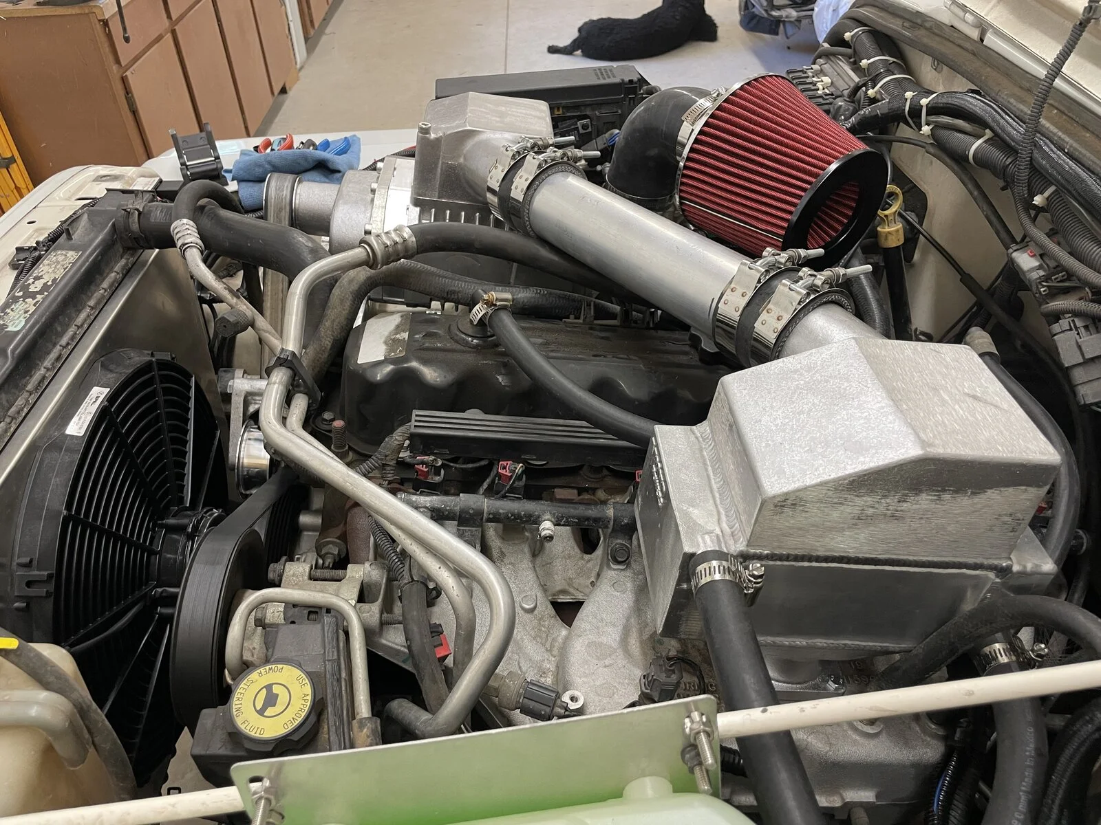

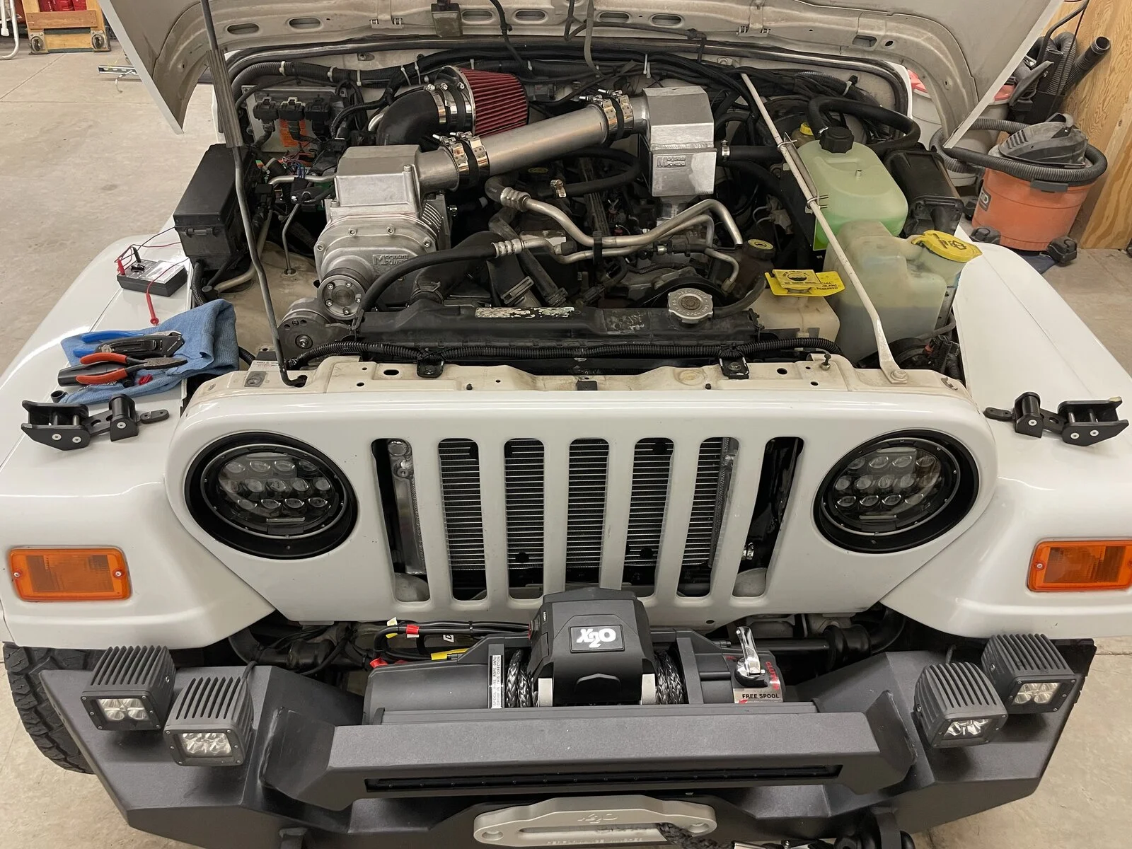

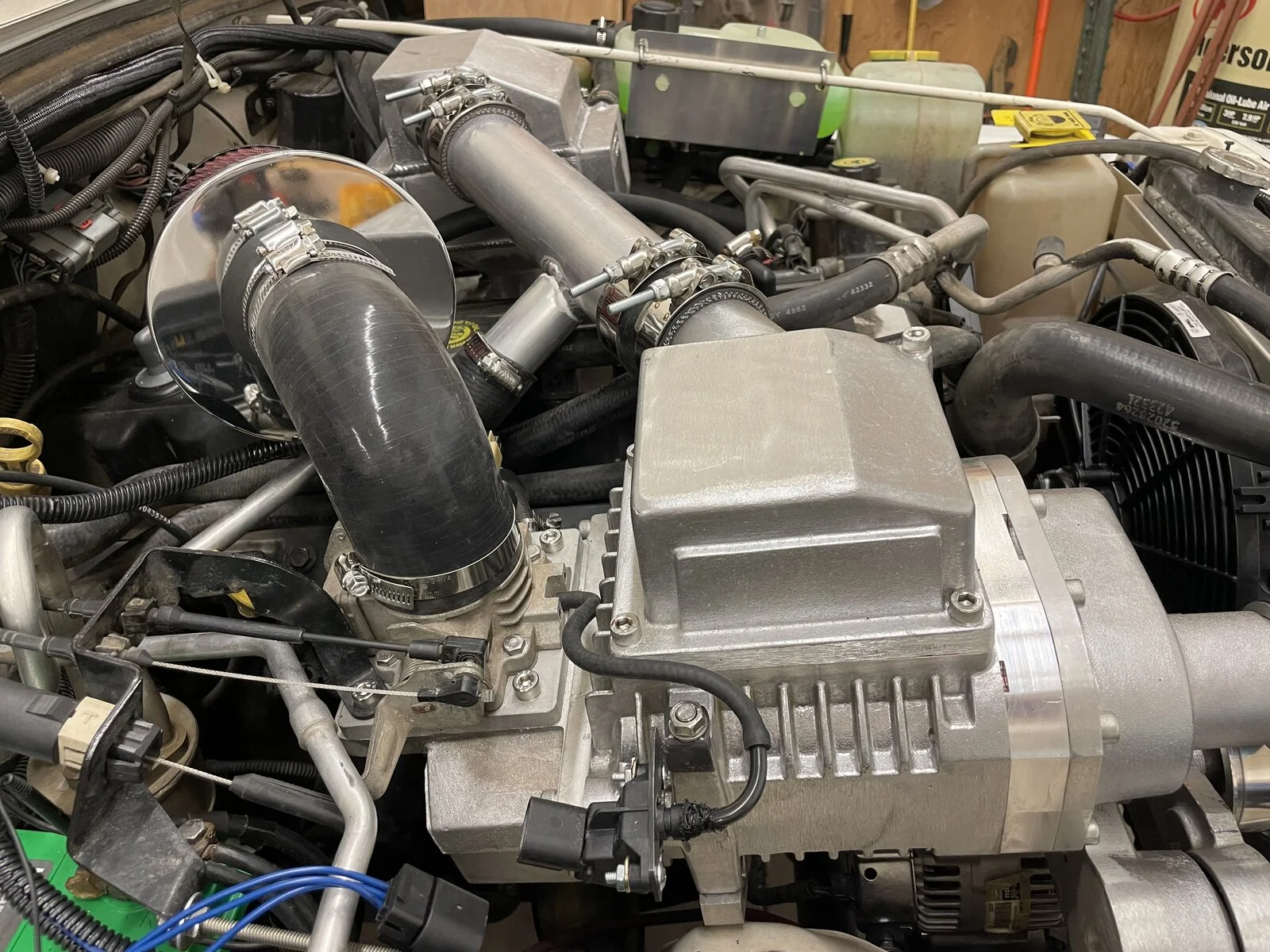

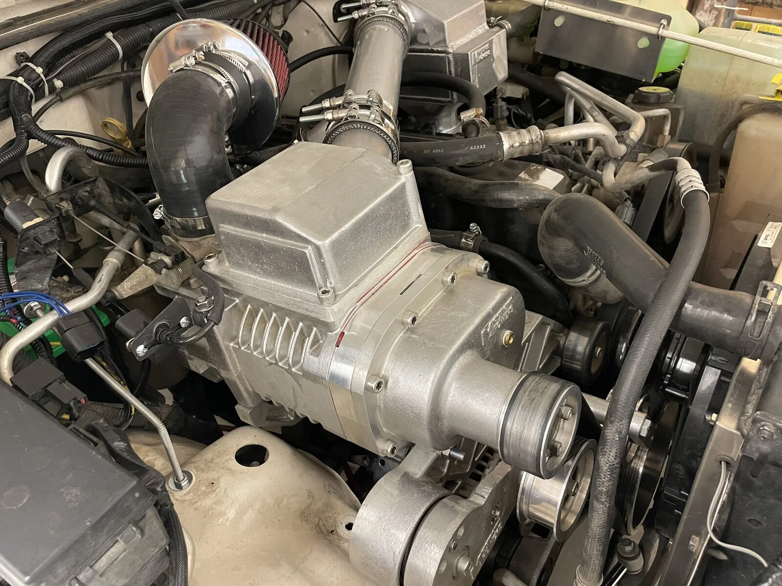

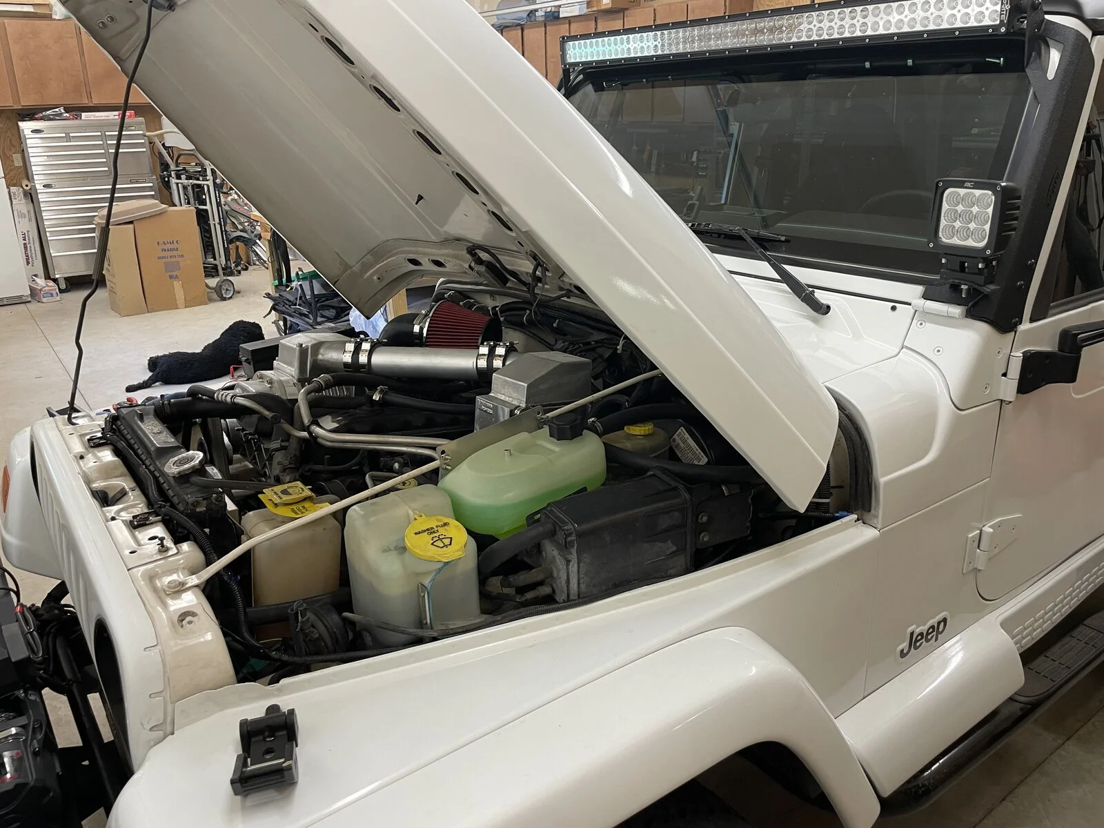

Pictures!
Here are some pics of the Magnum Power Supercharger installed on my 2002
