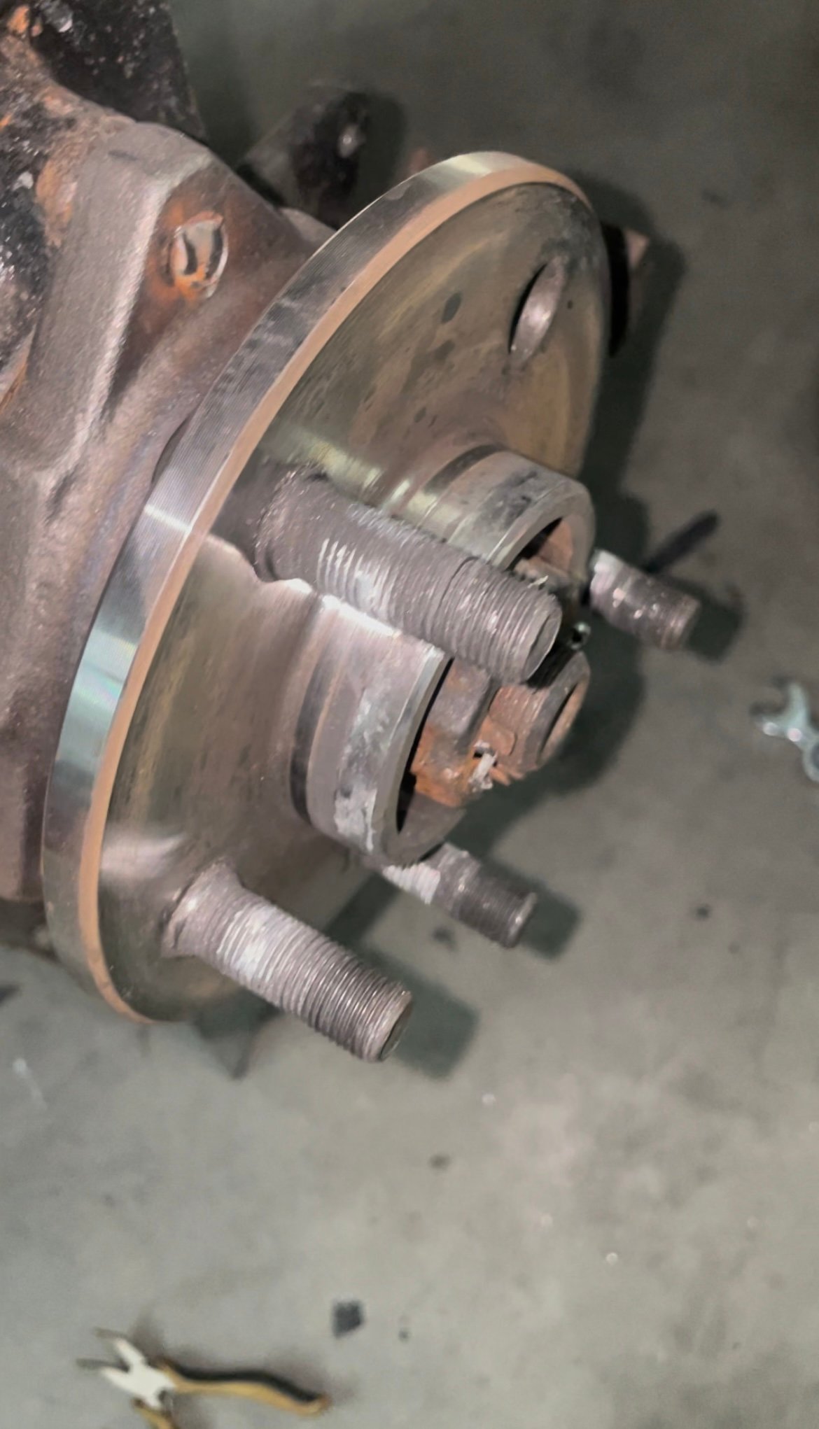

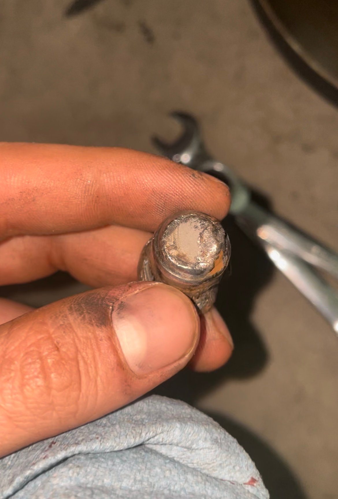

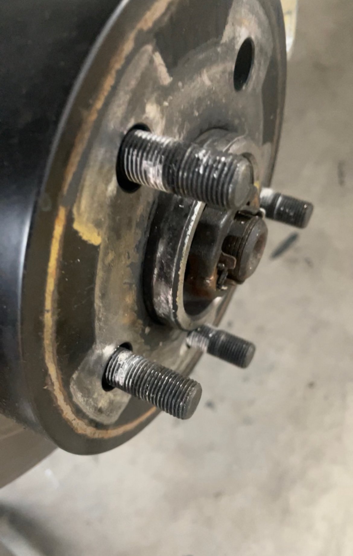

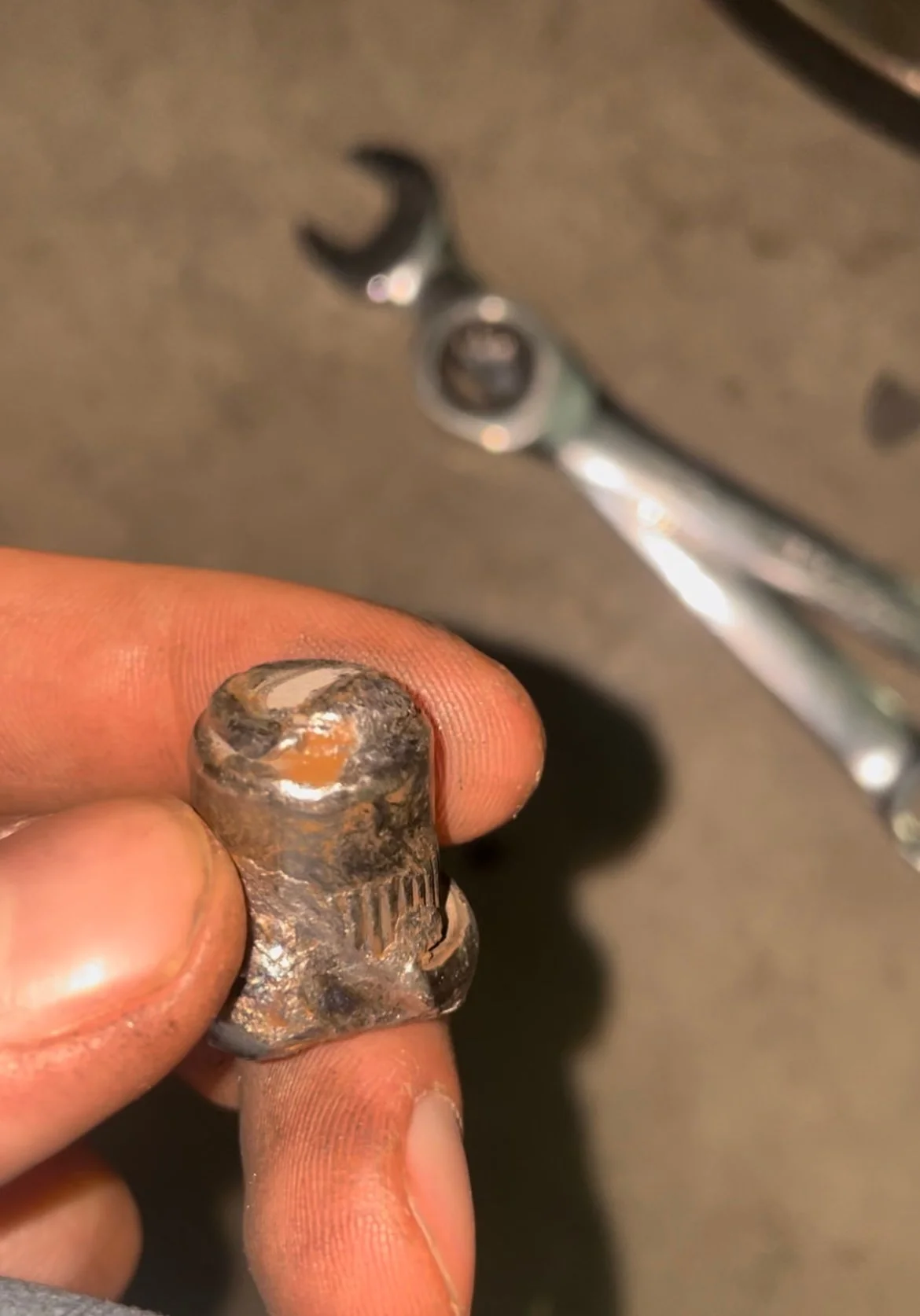

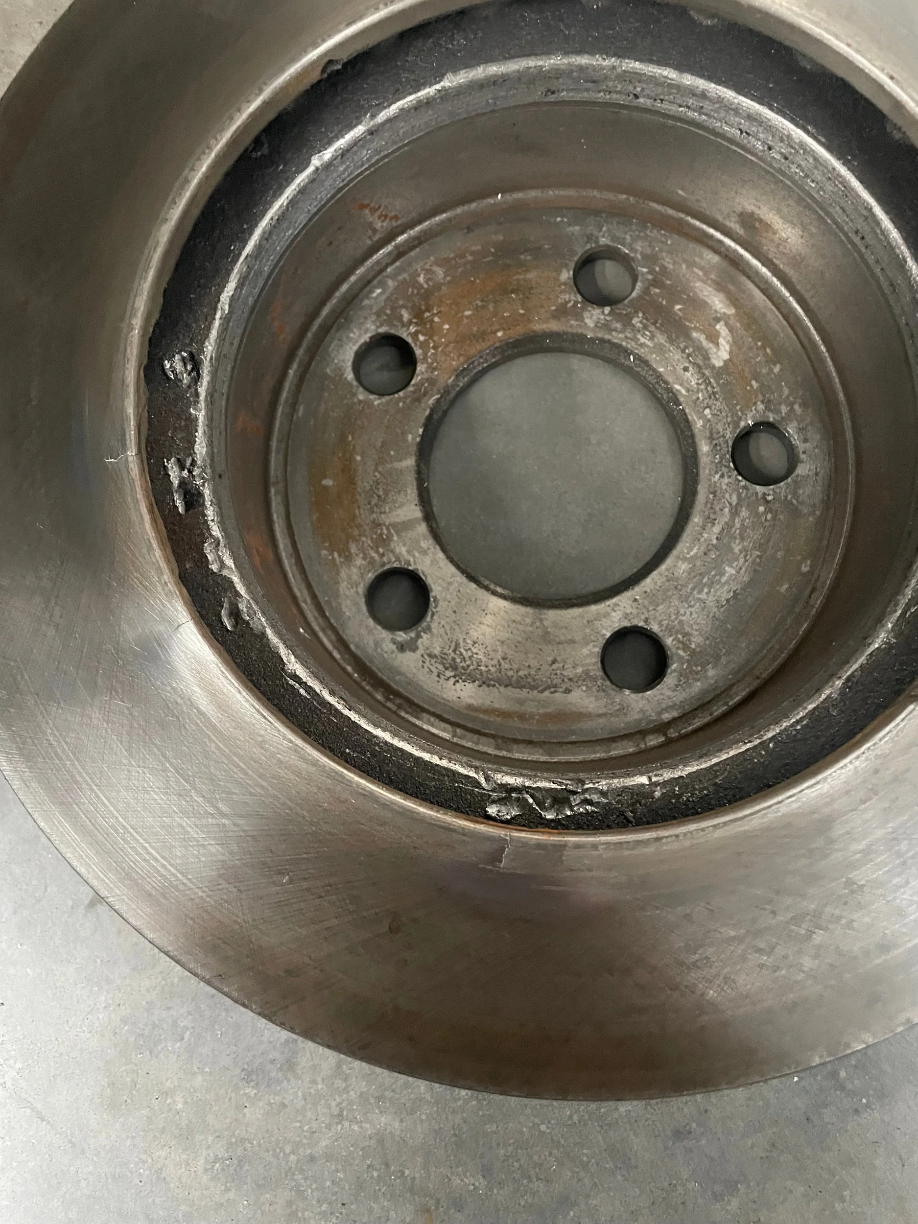

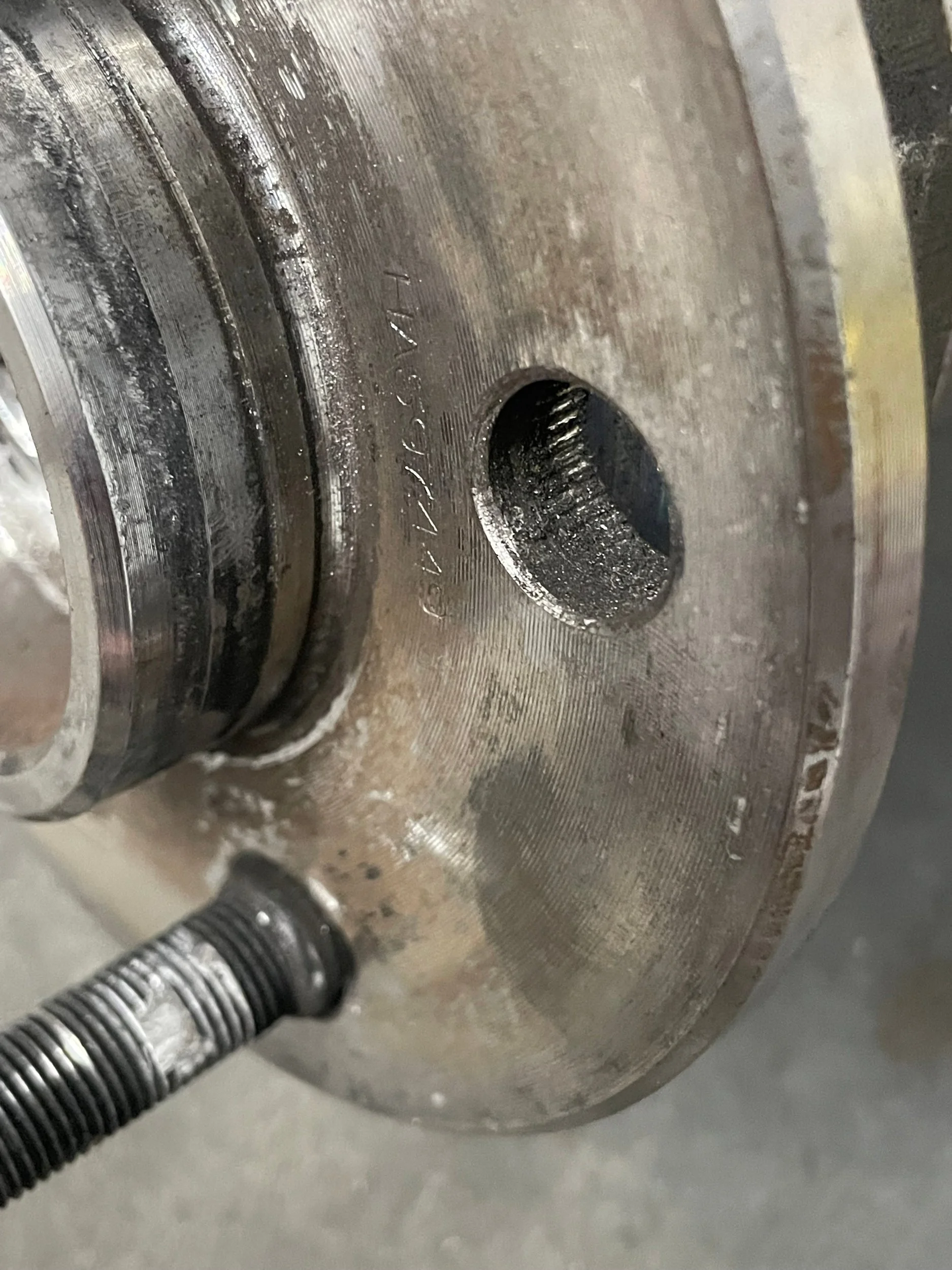

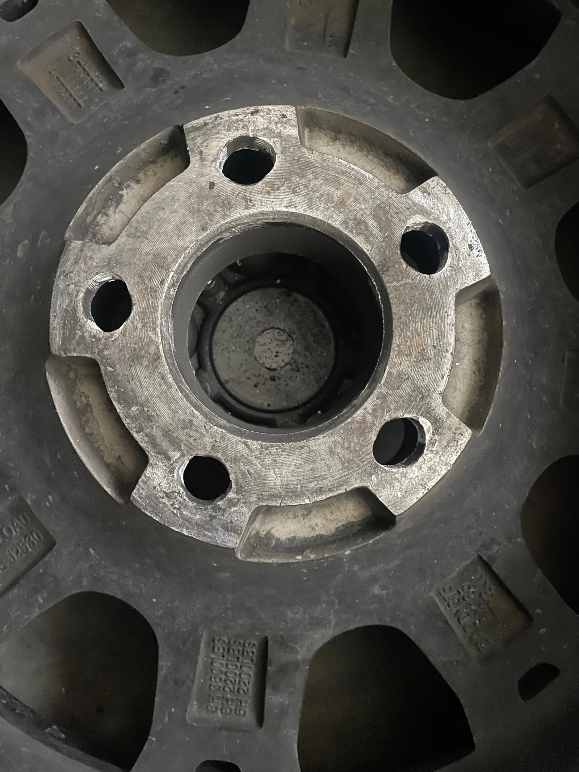

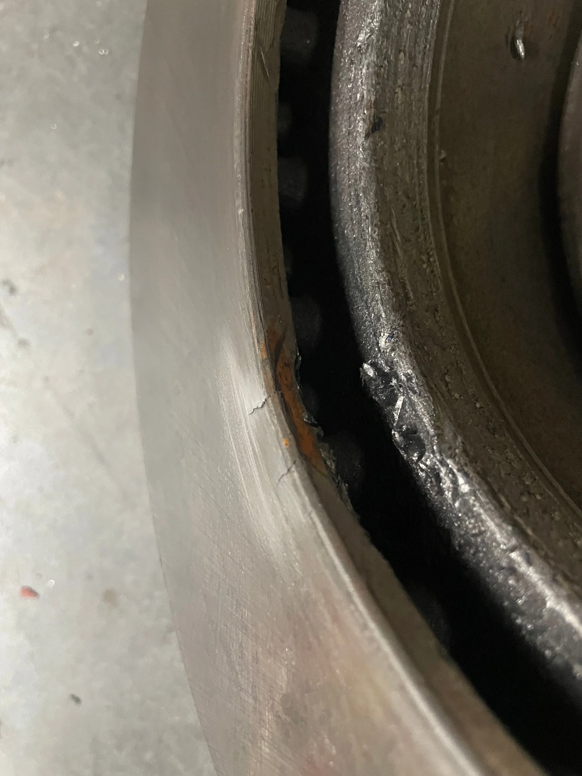

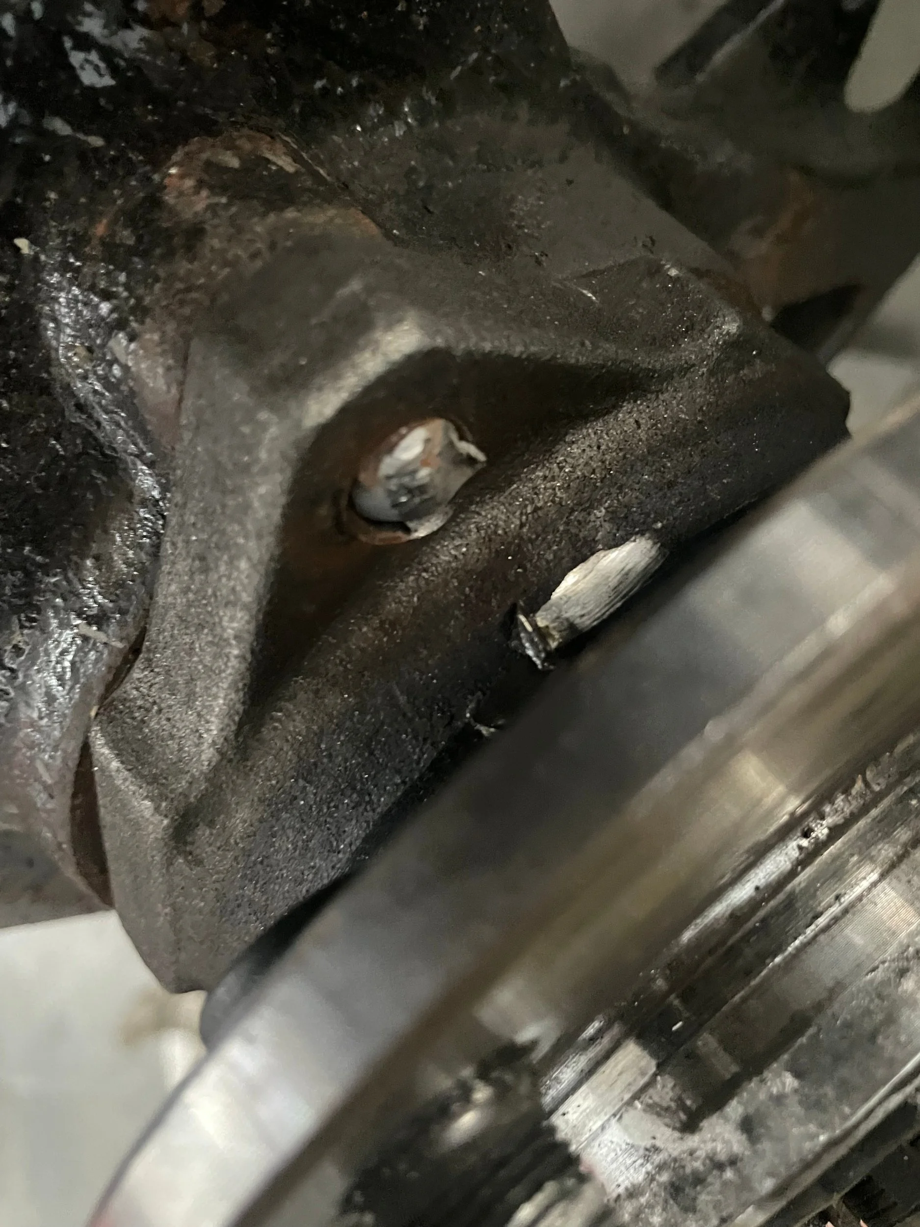

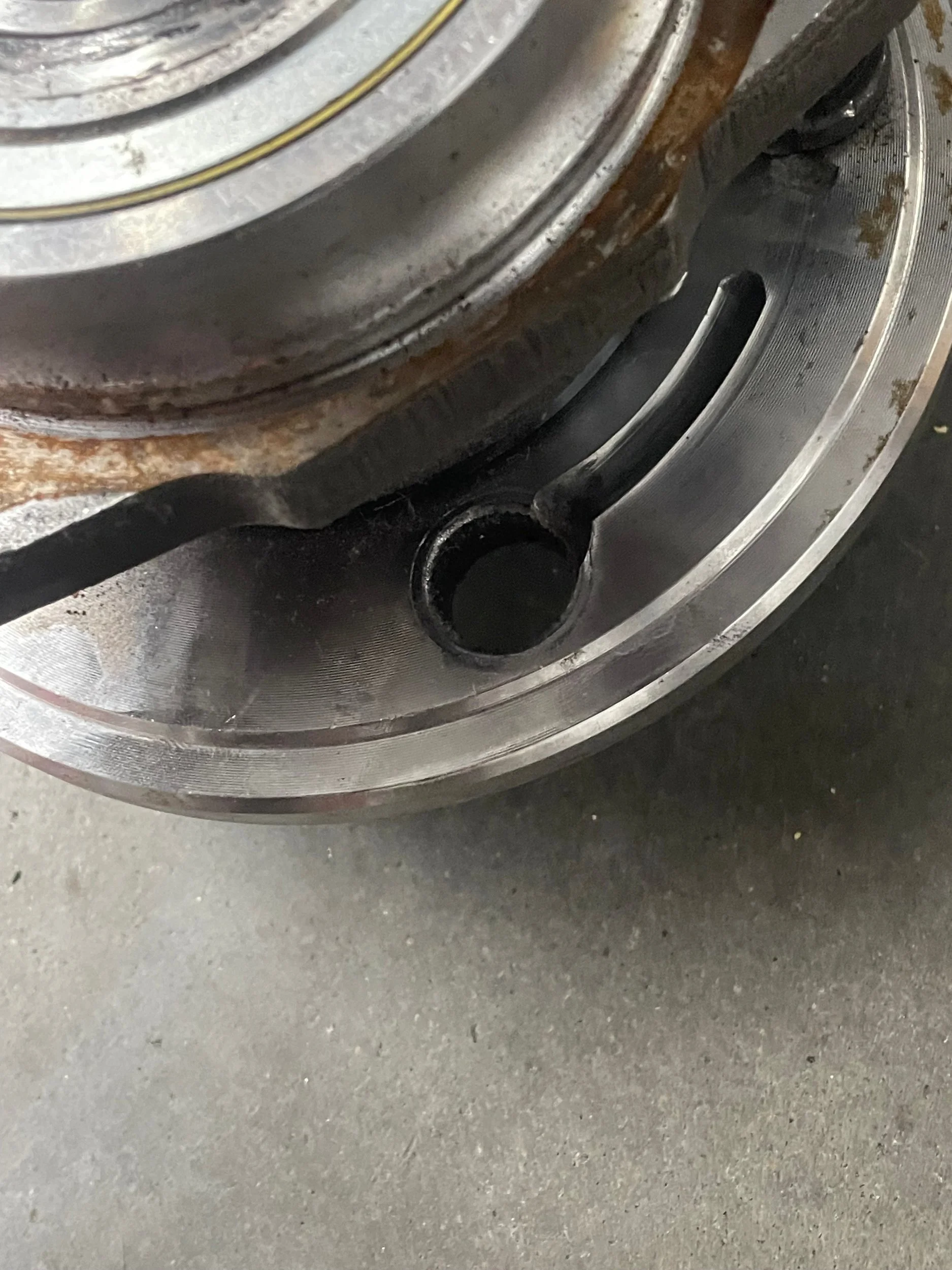

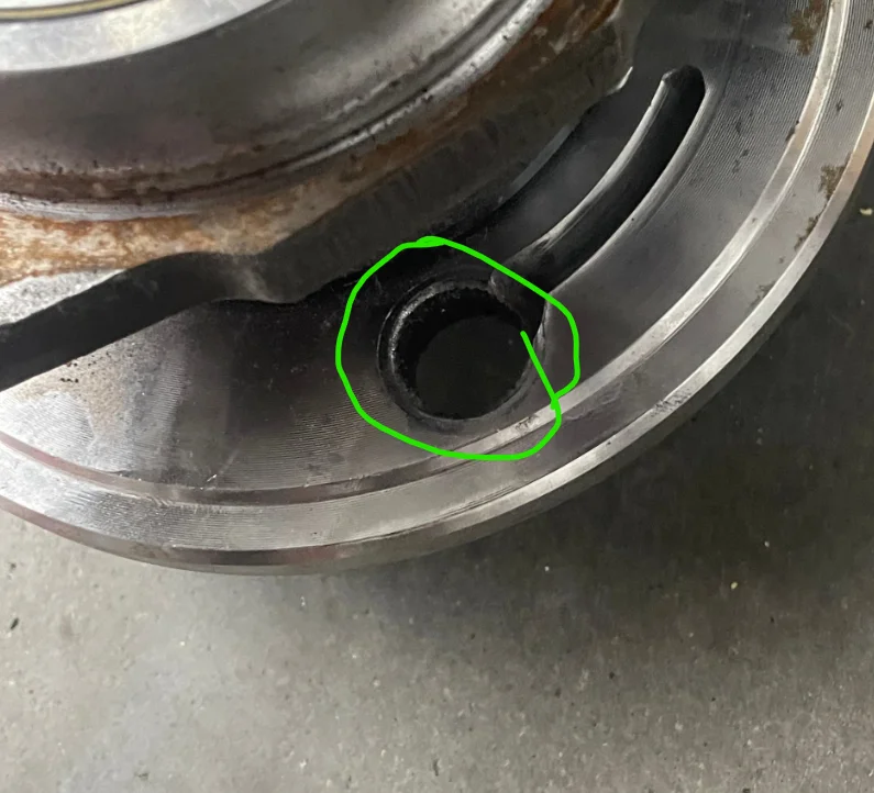

Just finished putting together a project jeep I acquired a couple months back and took it wheeling for the first time. Coming back from the trip (less than 10 mile drive) and driving around the next day I started hearing a banging noise from the front end and the brakes seemingly start to grab. I thought it was my new Spartan locker engaging and disengaging at odd times but decided to jack up the front end to inspect. What I found was my driver side wheel about to fall off. Upon closer inspection, it seems one of the studs on my brand new timken hubs has broken off, and left some damage in its wake. I also noticed the remaining 4 lug nuts to be loose, even though I'm certain I torqued everything to spec twice, once in the air and once on the ground. As a result of the lug nuts loosening up, all the threads on the studs that remain are severely mangled. My new rotor is chewed up and cracked from the piece of stud that fell out the back of the hub. And my hub mounting bolts have been sheared at the ends in two of the three bolts. I just wanted to share my experience and see what others think the main culprit for the failure was. Can one stud breaking off really cause the whole wheel to loosen in less than a total of 20 miles since installation? Is it really possible I left the lug nuts loose? Or maybe I overtightened this one causing it to eventually snap? There really was no early indication that things were loose. It was wheeling perfectly fine on some tough terrain. The tires sat square on the pavement. The tires didnt wobble at all. Then I heard that bang the next day or so that I thought was my locker and things started acting and looking funny. Attached are some pictures of the damage, and the remains of the snapped hub stud. I've already ordered parts to get everything fixed, just wondered what others thought about how this problem started.
