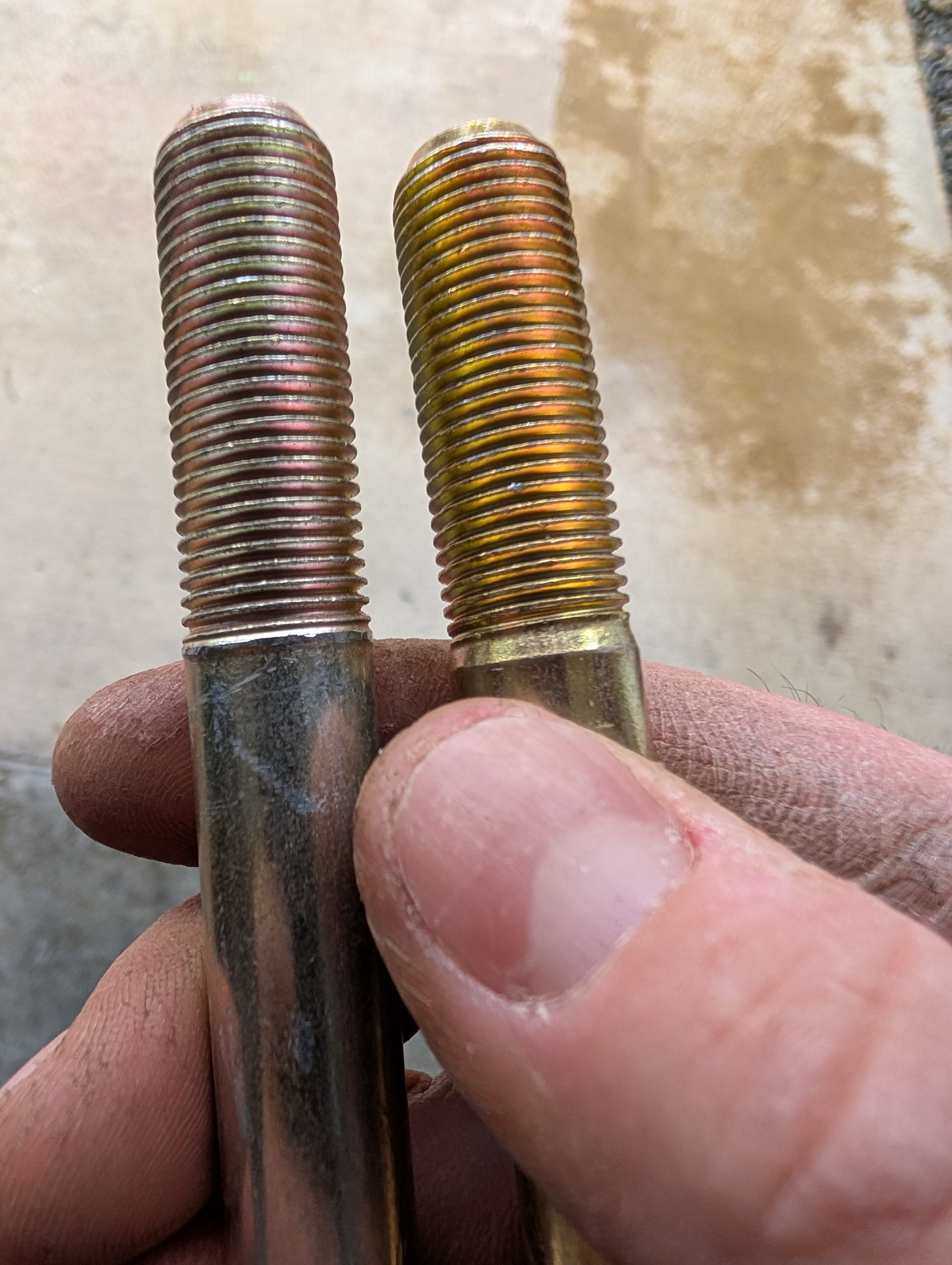

Started working on installing my control arms and the second bolt wouldn't fit. Looked closer at the hardware and two of the lower bolts have a flare instead of a taper at the base of the threads that is too thick to fit into the JJ. Emailed Savvy and had a shipping email about an hour later. Got one arm installed then had to stop when the kid woke up from nap.

Fronts are in. I'm using factory bushings on the axle mounts for the uppers and decided I didn't want to drill out the bushings to fit the new hardware. Seemed like a good chance of spinning the sleeve and not actually drilling. The factory bolt couldn't be reused due to the flange to catch and hold wouldn't reach the edge of the Savvy arms and if cut off or flattened there was nothing to hold the head of the bolt. Made a quick run to the store for some grade 8 hardware and got them done. Still need to do the rears, hopefully make some progress today. Then just double check some measurements to be sure the axle is square and tighten down jam nuts.

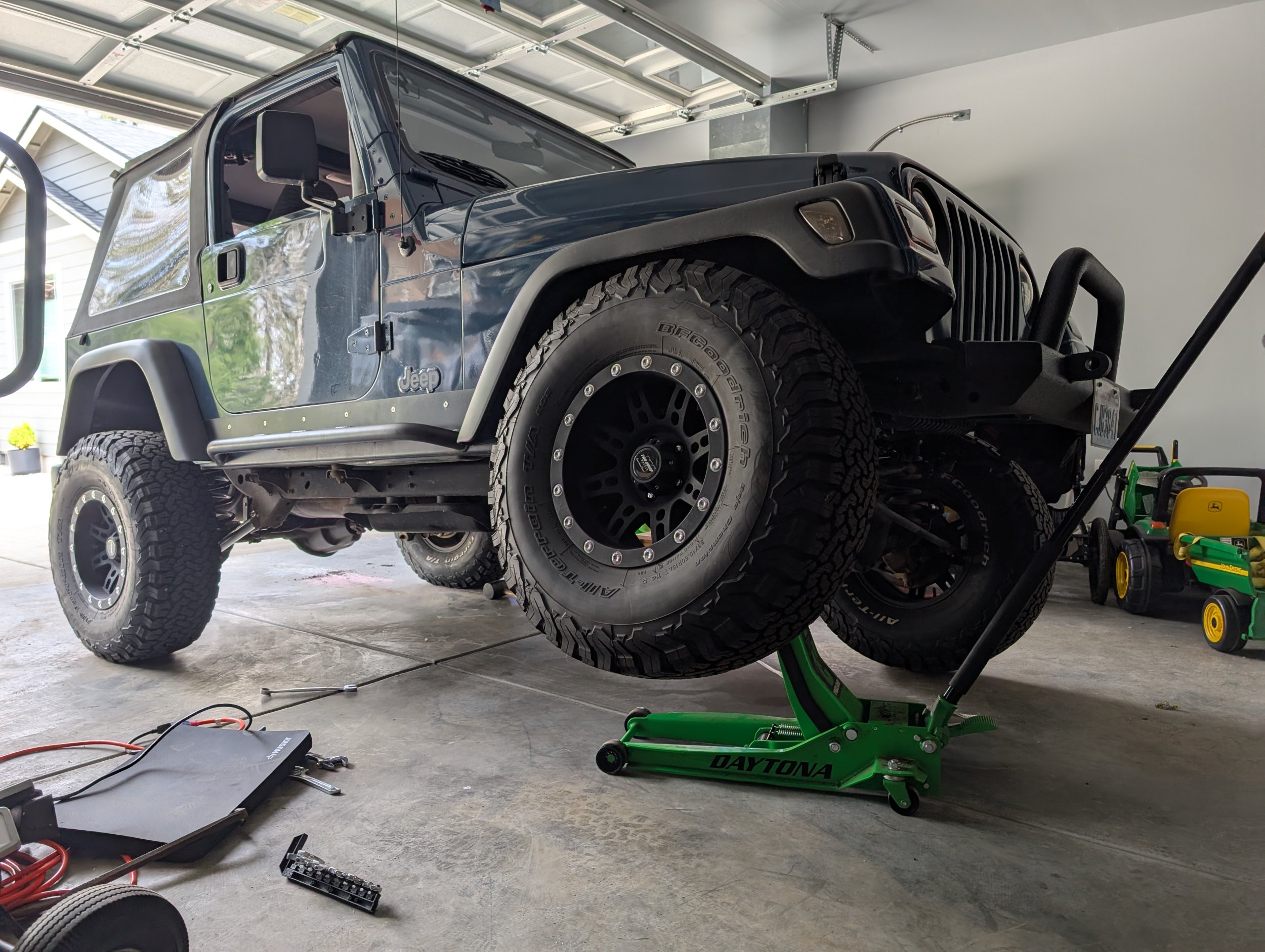

Finally got a chance to make sure everything was square, tighten everything, and get it out of the garage. Just a small drive around the house but no more pops and clunks from the factory arms. Hopefully get up in the woods tomorrow to actually drive it.
Pulled the disconnects and jacked it up checking for binding. Everything seems good so far.
