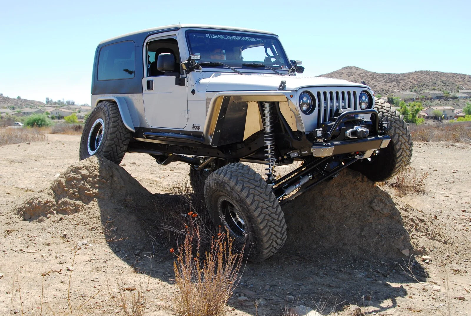

You are starting to figure out the how and why of my wheelbase, tire size, and belly height balance rules of thumb we use.
All these fucks want to stretch their rigs for 35's and we know that 104 is just too much wheelbase if you wheel where it matters unless you want to build it stupid tall.
Avoid the Genright plate, it sucks since it is open on the bottom. If you want to go that route, look at the one from Poison Spyder or SWAG. No experience with the MB so do your comparisons.
An Unlimited in JV really needs 37's. 35's make for a longer day but not the worst day.
As for TJ versus TJ Unlimited, I challenge anyone who thinks one is better than the other to give me the specs for their perfect rig and very few will be duplicates depending on region. Build for what you do and don't generalize that for everyone because it won't work.
My rules work very well for where we wheel.
If you want to fix the tank problem, I have a way to do it. You won't like it if you value ALL of your cargo space.
I'm definitely struggling with this one. On the plus side, whenever we come to a long steep hill climb, I generally walk up it, with very little drama. When I watch them climb, I'm happy with my LWB, and glad I'm not a passenger riding along with them. As with everything, it's a mixed bag. Sometimes I'm at an advantage, sometimes they are. Maybe I just need to be content with that!
Fine tune all the little things and you're on the right track. Raised body mounts, raised gas tank skid, low profile rear bumper and then see what needs work after that. As you've noted, you kick their ass on some stuff.
That's also the thing that everyone misses about JV. Yeah, my 40" tires look good but they add width that forces me to take stupid lines to get between stuff that guys on 35's never even scrub sidewalls on and just sneak right through. The difficulty level is very close because of the lines we have to take.
