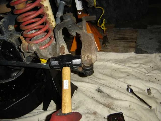

Have you tried post #7? Put the nut on so that if it comes loose it doesn’t slam to the ground.
Then hit that right there with a sledge hammer, smaller hand sledge, but a Big Fing Hammer. I have my shooting ear muffs when I do it..(can’t lose any more hearing ha)
The big f hammer guys know what they are talking about. It’s not rust holding it, it’s a taper fit and stuck because Jeep intended for it to stay stuck. Get the new puller on it with some tension then wack it with a big hammer. You can possibly break the better puller by trying to pull it off without hitting the pitman arm

Pay more attention to the advice given above that says to give that knuckle a SOLID whack or two with a BFH and that stud will pop right out. No this is not knuckle abuse, this is just the time-honored method of separating tapered studs. Don't be afraid to give it a massive whack with a BFH (big effing hammer), put your big-boy pants on for this job. I can break 3 tapered stud joints free in well under a minute with no pickle fork or puller needed.
Girly-tapping it with a brad hammer won't do it. 1-3 manly-man whacks with the BFH does it every time.
