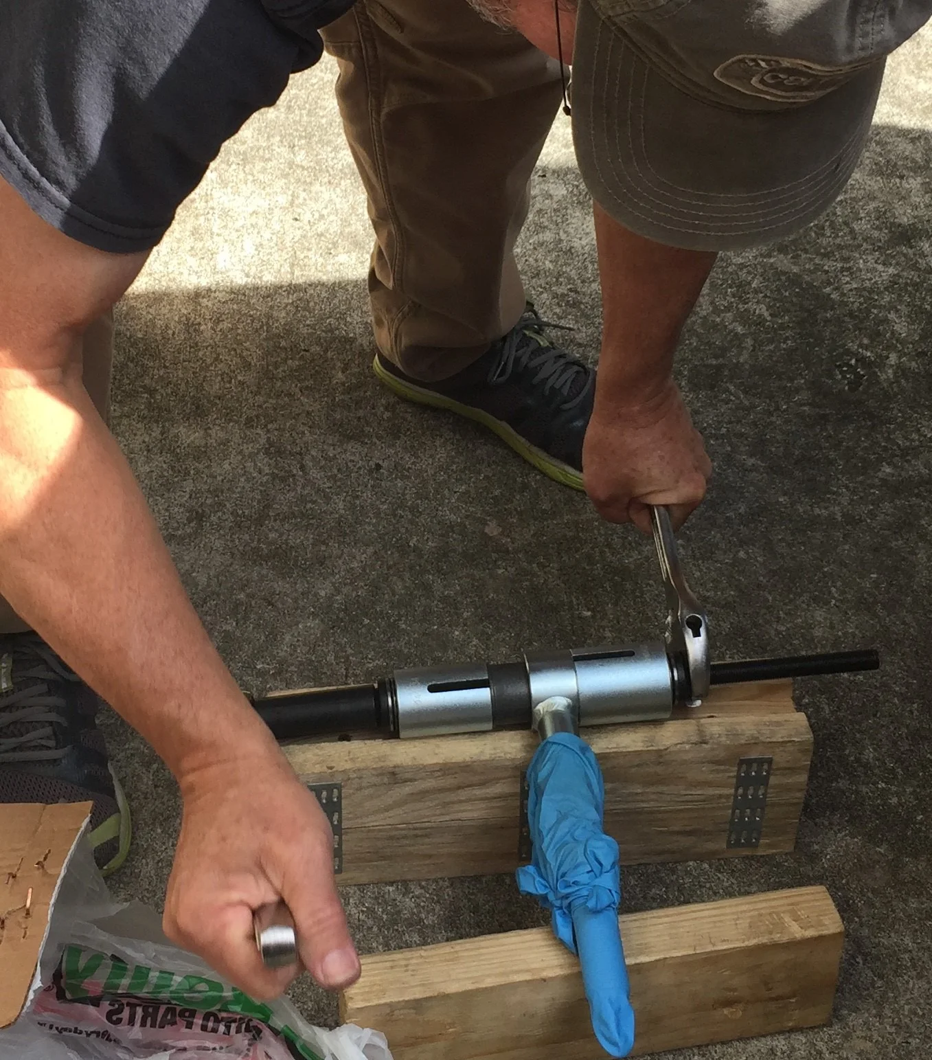

Just use a ball joint press and a block of wood/metal to keep from crushing it out if you are budget minded person. If not then there are a lot of options to install johnny joints or even 3 link.
I guess I will try the ball joint press and a block of wood then... Thanks.

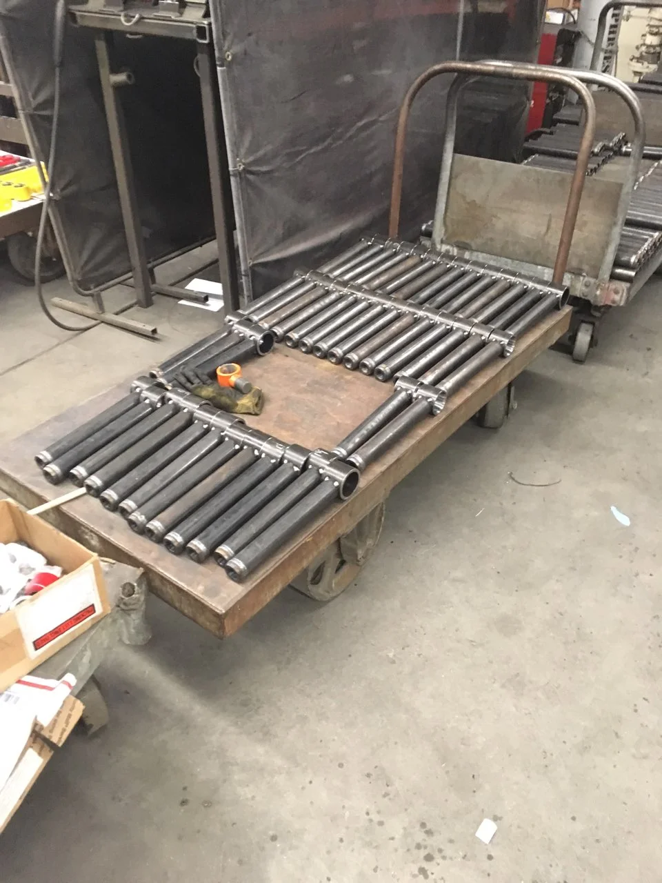

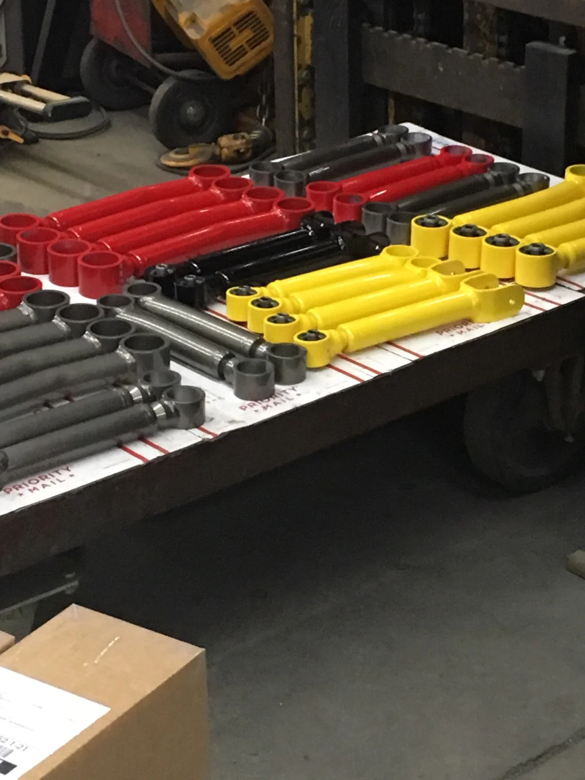

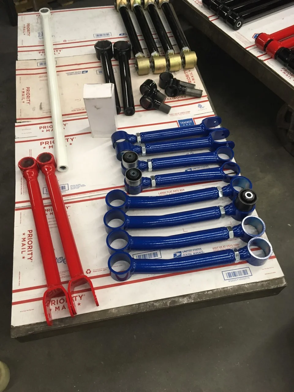

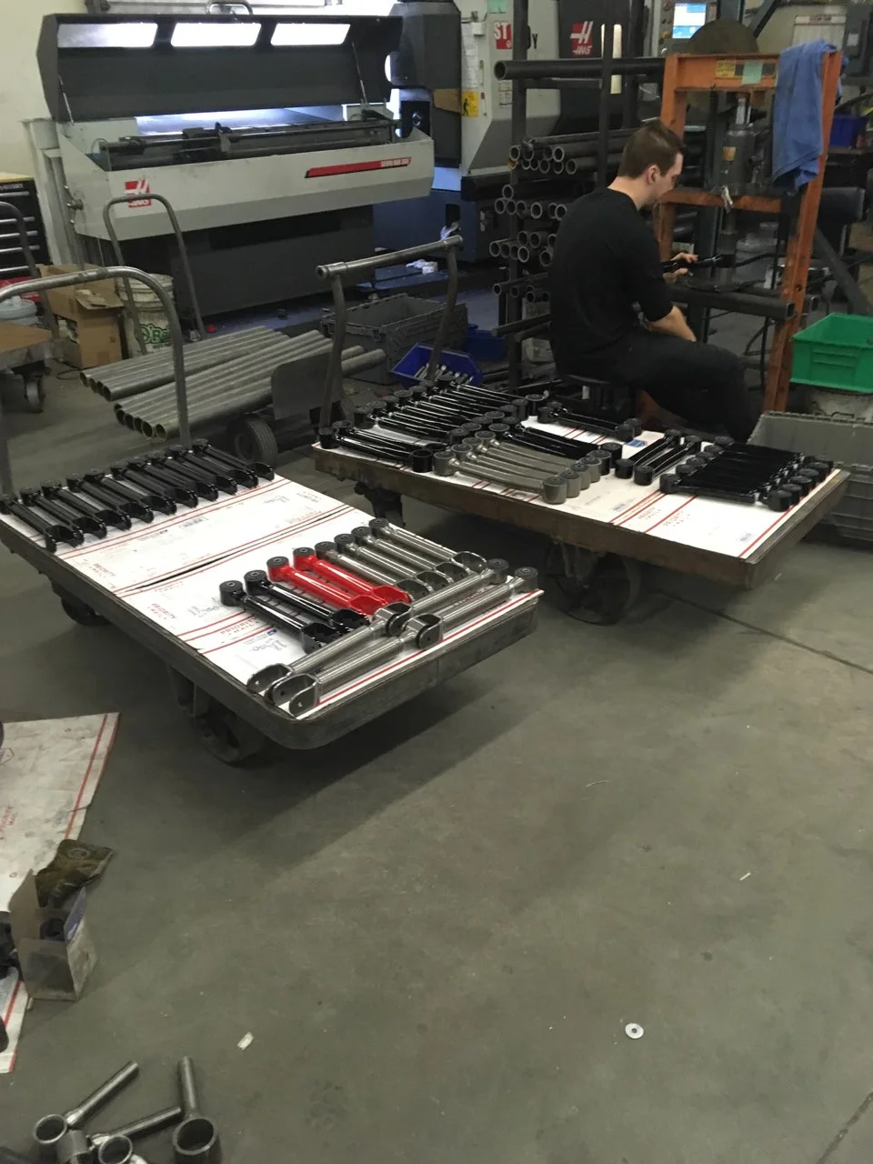

I went down to their shop with the bushings, they pressed them in while I waited. I took some photos of their shop. It was $550 for the arms from Core in the color and length of my choice, single adjustable. I provided the synergy joints so my math may have been off a little. I hope to pull the fronts this fall and do something else like a 3 link. I just wonder how well the ddb track bar bushings could stop death wobble. Do you want the Girro Joints if you go the Core route? Tim
The arms look nice. Thats a bigger operation that I expected too.
