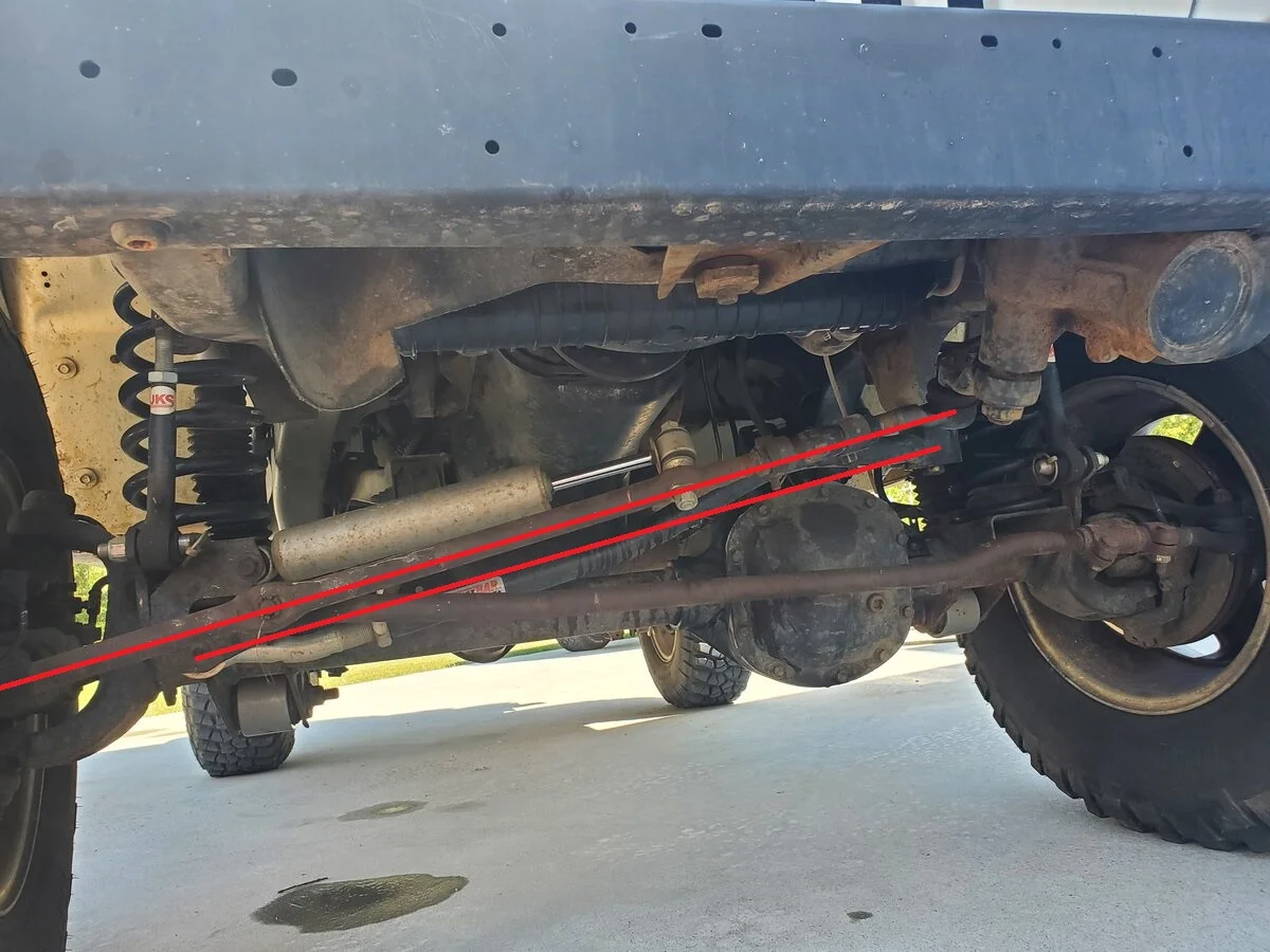

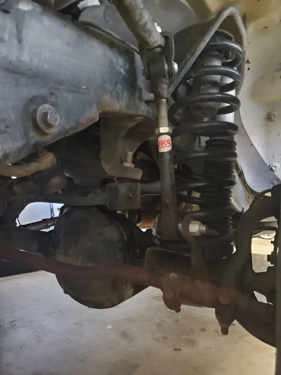

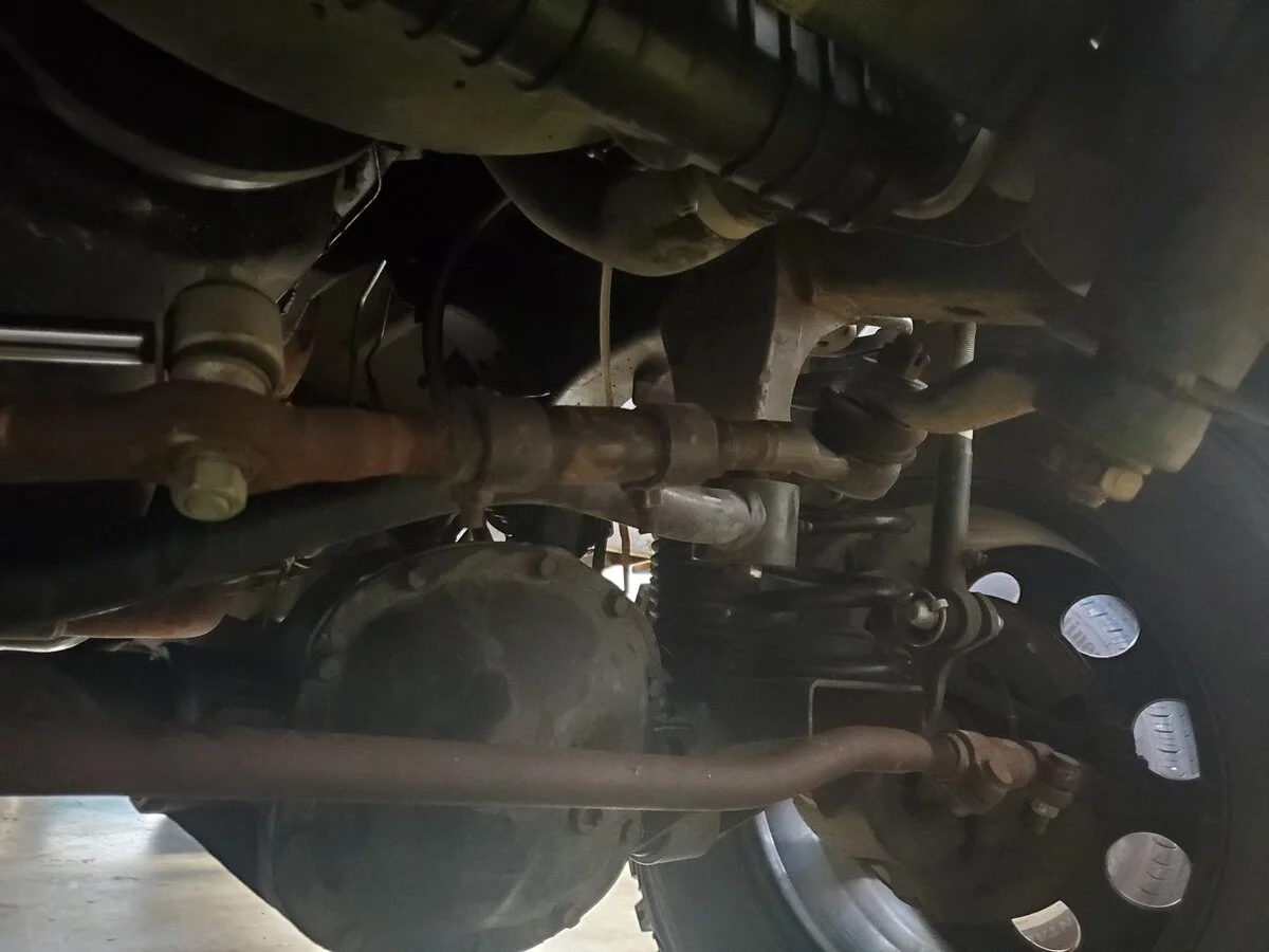

I swapped my dad for his 33s for my 31s. I wouldn't call it bad at all but I definitely have some wandering a little bit and a little slack in the steering wheel. I have a Jks 2.5 lift and I'm pretty sure it's the stock Pittman arm. I just got this jeep this weekend. I'm having new wheels put on tomorrow and I think it's more of an alignment issue than anything. Like I said it's not bad, but I noticed it more after the bigger tires. Tire pressure is 29 psi. Does everything look OK on my front suspension?
Bump Steer is defined as the vehicle changing directions as the suspension moves. Bumpsteer is normally caused when the track bar and the drag link are NOT parallel to each other. Your Jeep's arrangement looks good.
Your Pittman Arm looks stock to me too. The most likely culprit for whatever driving changes your are feeling is the wheels/tires. The only easy adjustment regarding alignment is toe in. Toe in can be checked in the driveway. I run my 33 inch tires at 24 pounds.

OK good. I wanted somebody else to put eyes on it and make sure it was OK. I'm actually probably around 30 psi right now. I'll drop it to 26 after my new wheels are installed tomorrow and see how that handles. It's a 97 Sahara and I think the steering stabilizer may be stock. I have a new teraflex one on the way maybe that will help a little bit too.
It looks like your jounce bumpers and the cups they reside in are missing on the upper spring perch.
Reactions: rasband

There should be an upside down cup there with a rubber insert. It’s to help bottoming out events Be softer. There are cases where that cup is missing and is instead replaced with something aftermarket to adjust your bump stops.

There is an illusion or there is something wrong with the frame side trackbar mount. The bolt does not look vertical and the angle of the lower part should be parallel to the ground. It doesn't look that way.
It does look a little off, like the track bar is adjusted too long. I know that internal piece isn't rigid and that it kinda moves around, that could be it.
