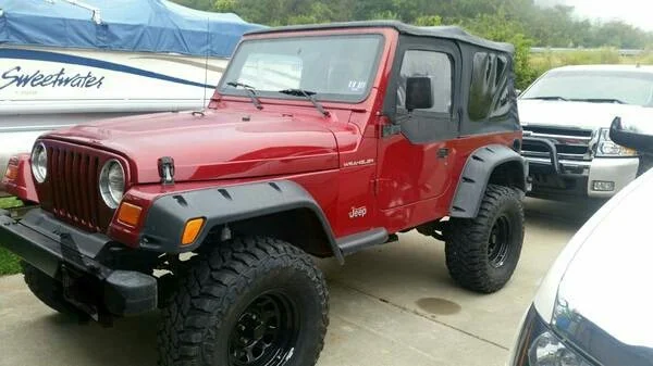

i'll have more pics of it tomorrow

That's what I was saying a minute ago, its all new underneath. The steering and stabilizer aren't touched, but when the lift was put on 20 miles ago he gave me receipts for ball joints, sway bar, traction, bushings, alignment and the whole nine. dude put like 1500 in the front end and then bought the pro comp wheels which weren't much and those are brand new mastercraft axt 33x12.50x15 tires, the blue is still on the white letters on the inside
