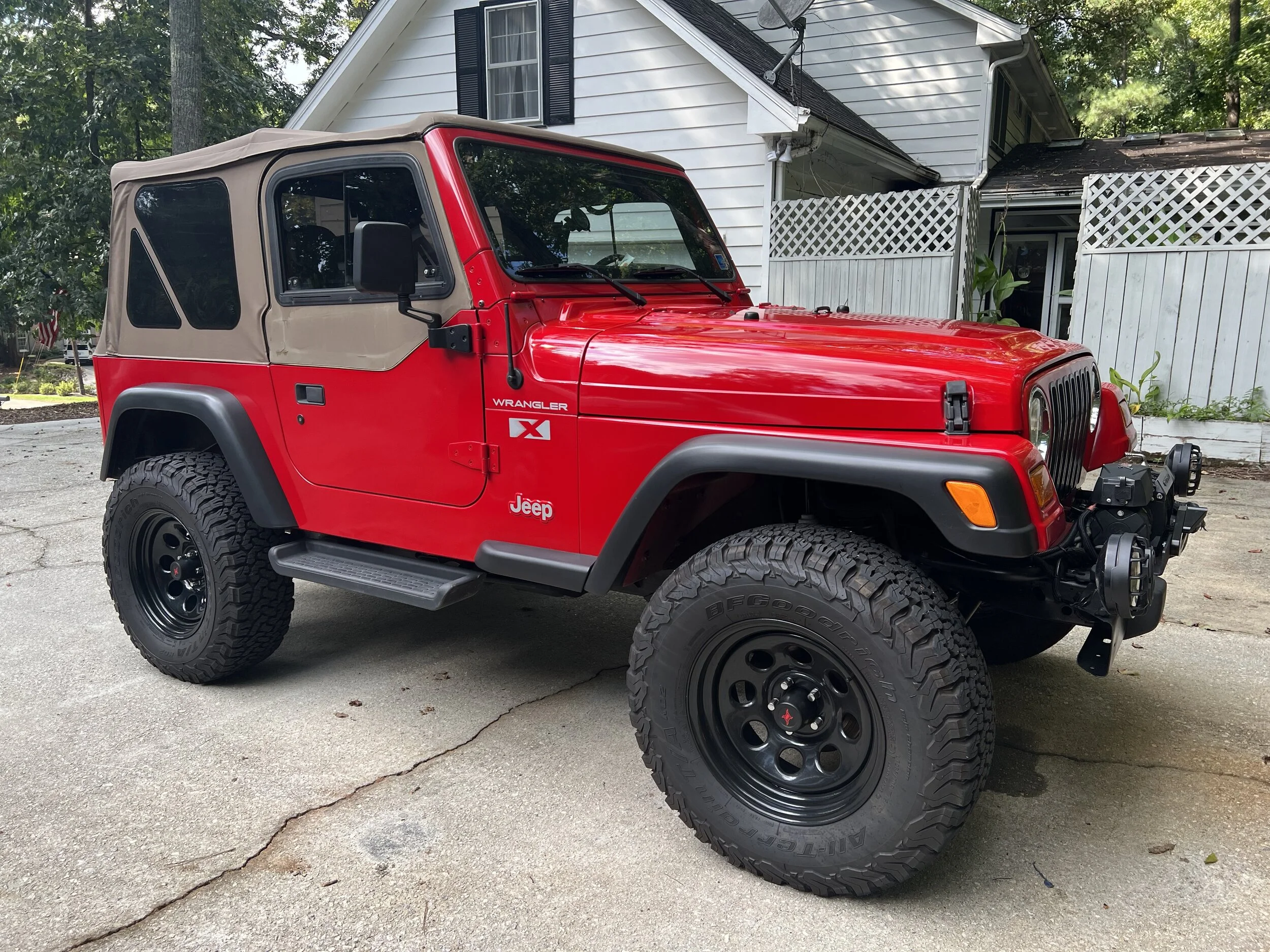

Hello I'm new to the forums and jeep ownership I appreciate any advice you guys have that being said i have my heart set on 33s I'm really trying to avoid a 4 inch lift and all the headaches that come with it I live in Florida and don't do any crazy rock crawling it's mostly mud and sand so my plan is a 2.5 inch lift and metalcloak flares i would also consider a 1 inch body lift but I'm a bit weary of it it I've read bad things about body lifts any thought or suggestions are welcomed I appreciate it

Check out this thread. Has worked well for many of us. 2.5in lift, 1in body, 17x33

11/4 body lift, and if you like Metalcloak fenders go for it.
Honestly I would do 2 1/2 springs and a 1 1/4 BMB body lift.

Metalcloak fenders provide almost the equivalent clearance of chopping back the factory fenders toward the hood. This translates into about an inch upwards that is only usable when the axle is fully articulated. Additionally, reaching a tire into that space is decreased with smaller tires and shorter shock travels.
All of this points toward Metalcloak fenders being of little functional use, especially on smaller builds. They are not a substitute for a spring lift or a body lift. And they are ugly.

Yeah for sure to clarify I'm going for complete functionality this is purely a weekend toy not a daily I was mostly trying to avoid 4 or 5k in upgrades for 33s my main goal is functionality and reliability I do like the way aftermarket fenders looks though It already out performs my brothers gx completely bone stock I was mostly just worried about headaches the body lift can cause so I've read

After looking at your profile, honestly you would money ahead doing the Zone 4 1/4 lift and regear for the 4 cylinder under the hood.

That will cost you ~$1k more than you need to spend. Check the thread I posted about earlier and get the body lift from Blain https://blackmagicbrakes.com/ols/pr...its-97-06-tj-and-tj-unlimited-all-trim-levels
Or atleast one that’s aluminum like MORE and not poly.
You also don’t *usually* need new track bars with 2.5 lift.

The included JKS body lift is incorrectly designed. It is a soft material and will not allow the body mount bolts to ever be properly tightened. It is known to allow the rear crossmember bolts to punch through the tub. All the while transmitting vibrations into the body. See mine from when I had one. You can even see how the JKS allowed the body to shift before I replaced it with a proper body lift.

You will need a tcase linkage relo bracket or cable shifter,a spacer for the steering shaft support bearing,redrill and relocate the fan shroud,undo the gas filler so it doesn't break and then adjust/retighten.possibly reposition breathers and wires. None of those are difficult to do.if you have a manual you may have shifter interference with the center console.
The awesome thing about the body lift is you can then raise the gas tank and do a tummy tuck in the future. Also makes it so much easier to work on the trans or exhaust.
