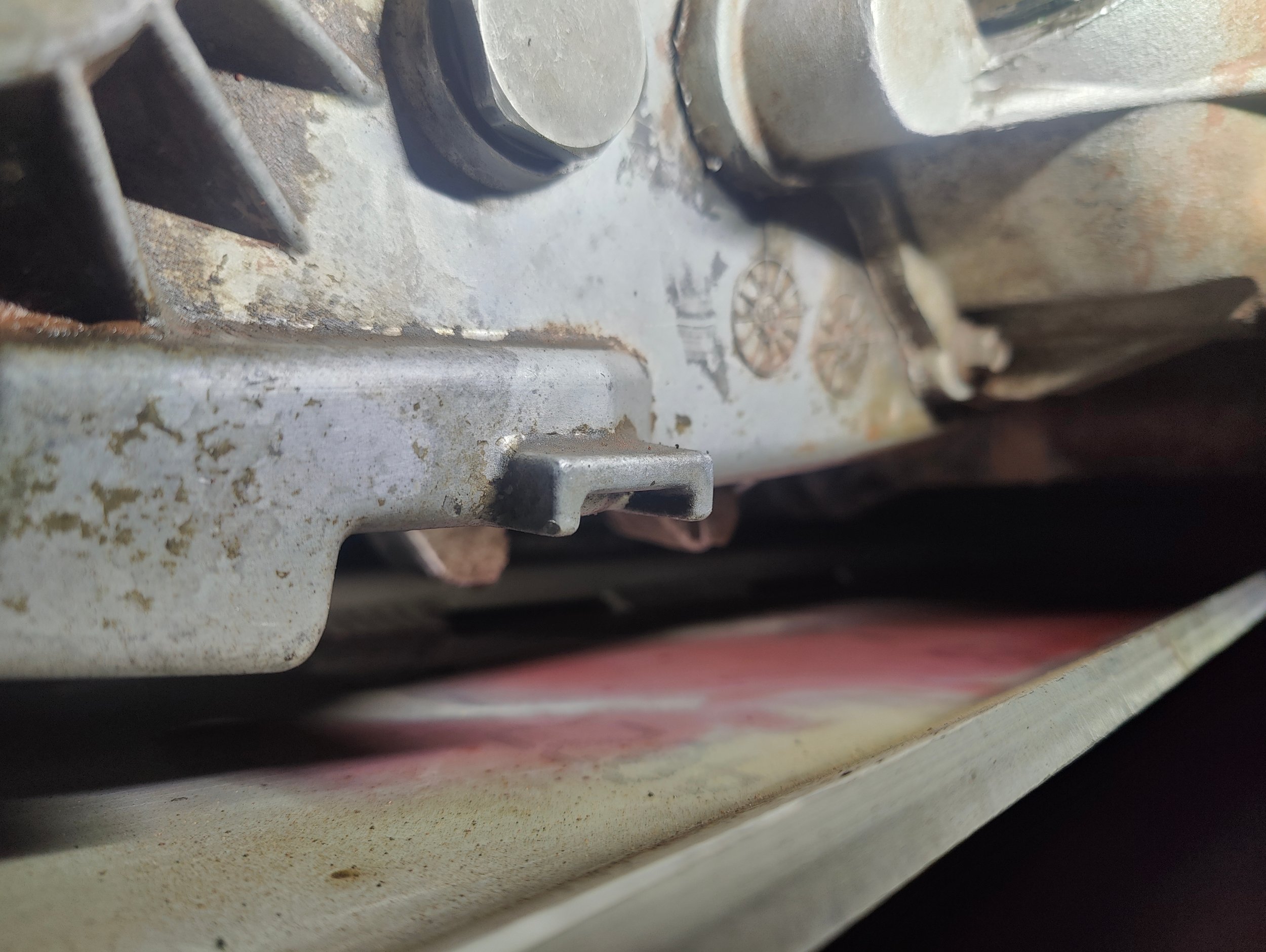

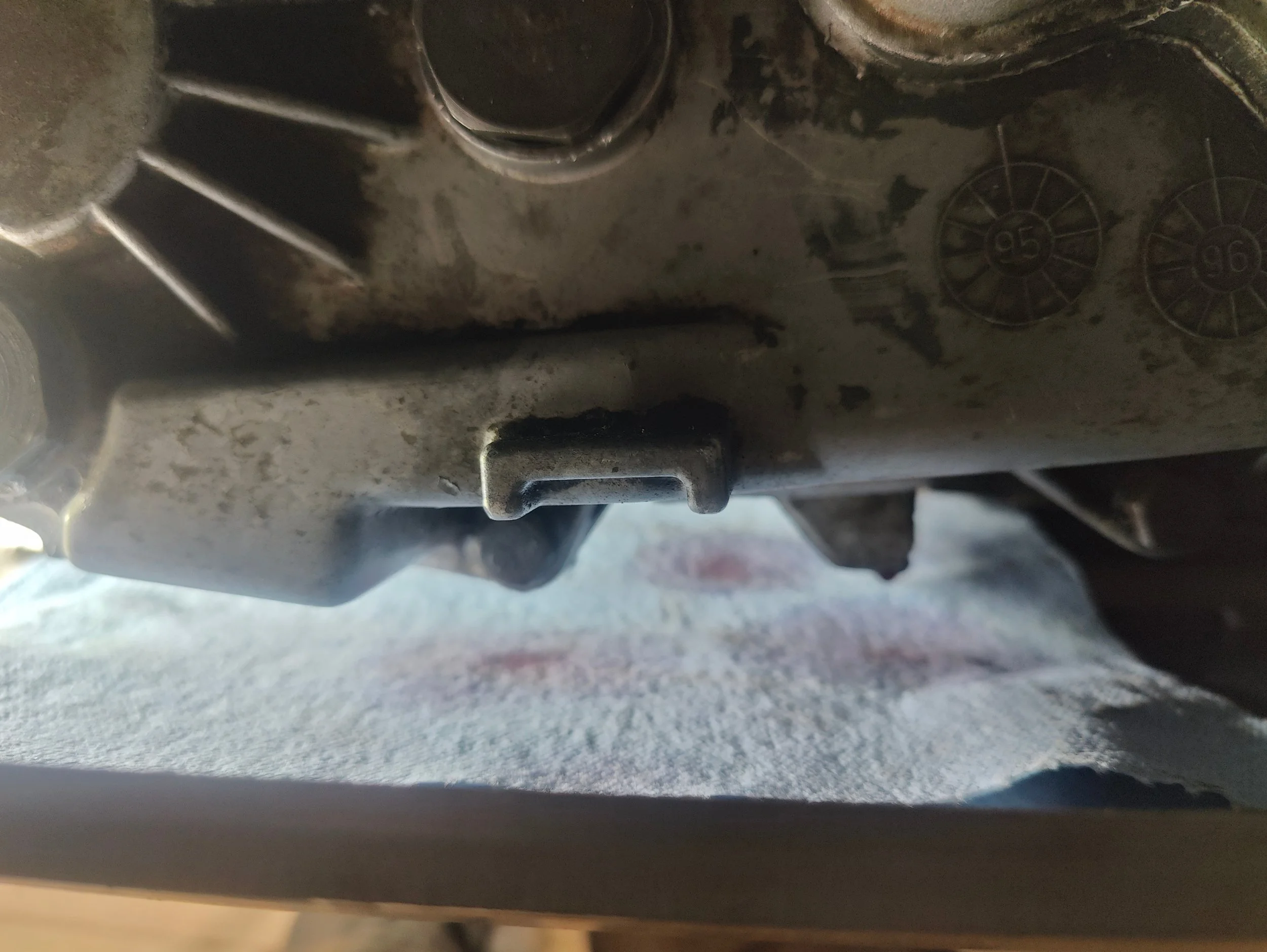

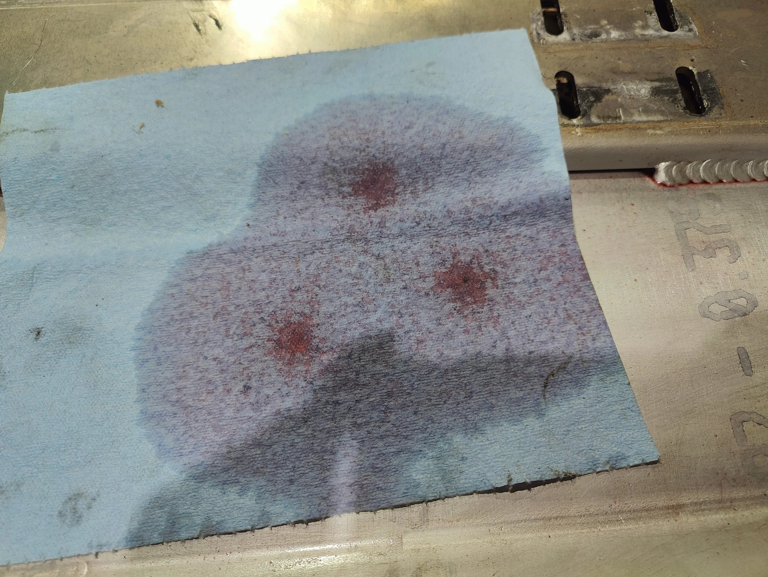

Chasing 231J leaks
Dammit...
-Mac

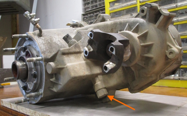

If so it will be coming out of the weep hole in the extension housing.

Nope. I already changed that one out and the bushing.
This is the shift detent and it doesn't even show on some of the exploded diagrams.
-Mac
Reactions: bbaldwin237

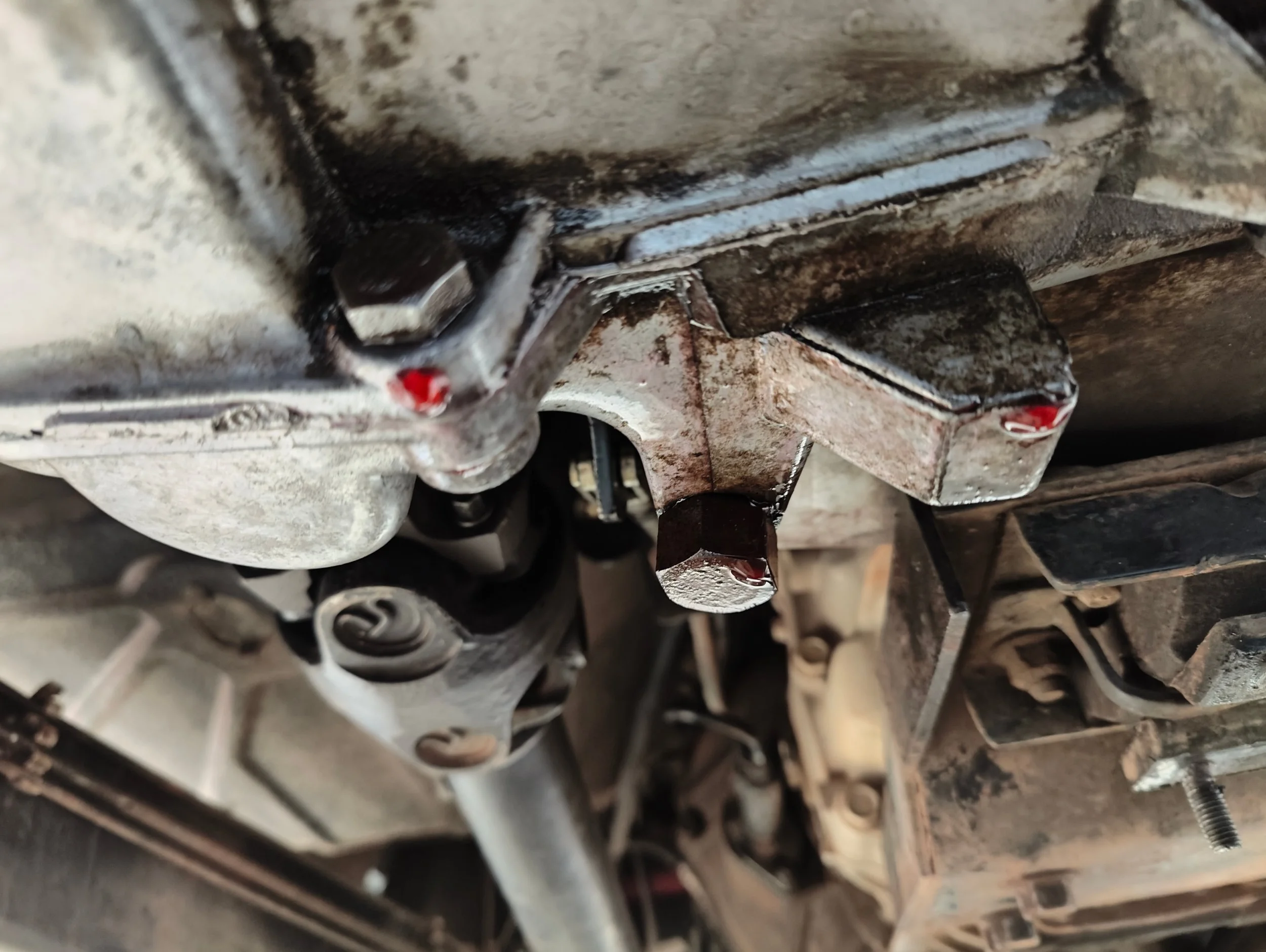

I have a Rubicon with the 241or. I thought the input seal was leaking. Wrong.
It turns out 1 or more of the mounting studs go through to the fluid reservoir. One of the lower ones wasn't 100% sealed.
I had bought a seal and a new set of studs. Installing the new studs with some red loctite stopped my leak which was barely seaping but could leak a lot if that studs was really loose.
Reactions: macleanflood

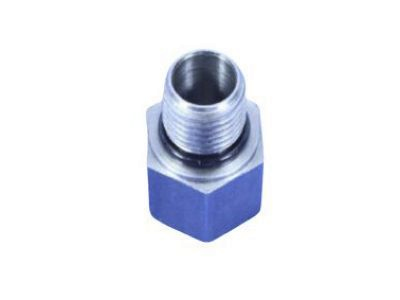

According to the '05 parts list, it's the O-ring for this Mopar 4886473AA "screw":
That's the one we're hunting for, right?
