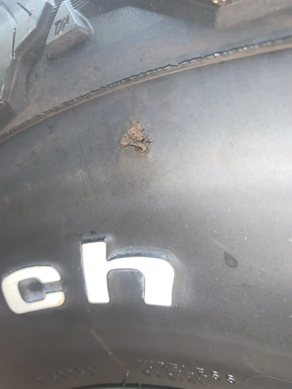

Found this today when checking my tire pressure. Assuming it’s not safe to ignore, so I’m going to swap it with my spare because it should be good in an emergency. I was planning on rotating my spare in when doing tire rotations but I guess I can’t do that now.
I’ve only had these tires for about a month, really wishing I bought the warranty
  • Wow
Reactions: Vasq
Where did you buy them from? that looks.. defective.
Discount tire. And yeah I am very confused how it happened, the little rubber edge right next to it is untouched so I couldn’t have hit a curb or anything. The 20 day window to add on road protection ended on June 15 for me but I’m wondering if they’ll still add it on if I call now

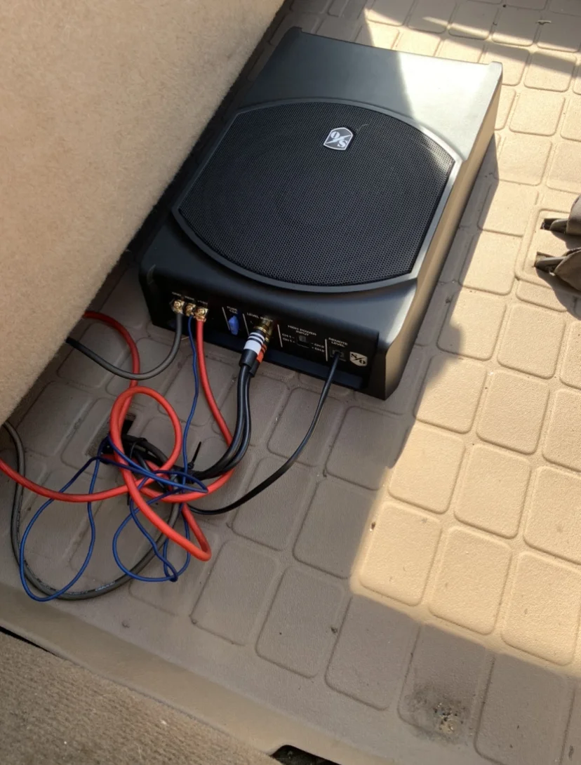

Installed a sound ordinance b-8pdt powered subwoofer under my rear seat as well as some new Polk 5.25” speakers for my sound bar. Tried to move my old speakers to the front but they were still making a lot of static so I went back to my old cheap 4x6 speakers.
(I’ll cut the wires to length eventually I’m just leaving them to make sure I like how it’s set up)

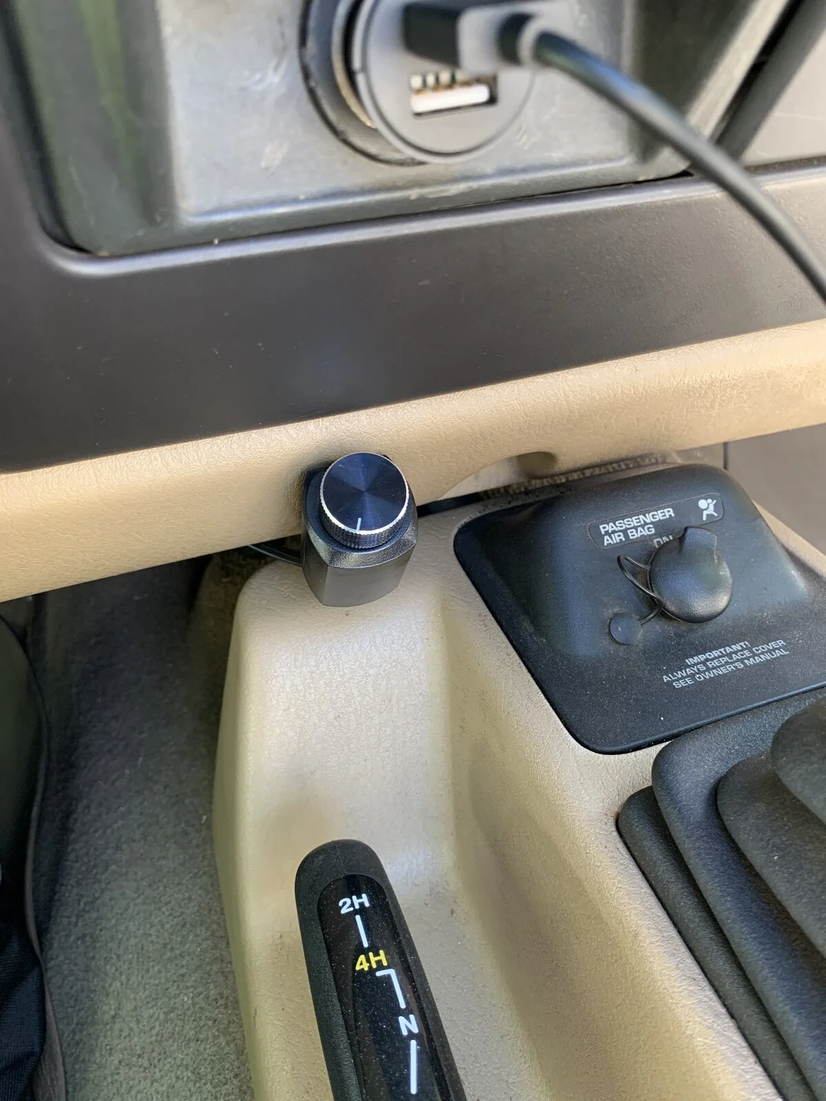

Also came with a remote bass adjustment knob I put under my cigarette lighter.
Sound is pretty great, not window shaking bass but enough that it sounds good and I can feel it in my seat which is exactly what I wanted. Took me a while to figure out how to adjust everything to get it to sound good, but I think I have it set where I like it now

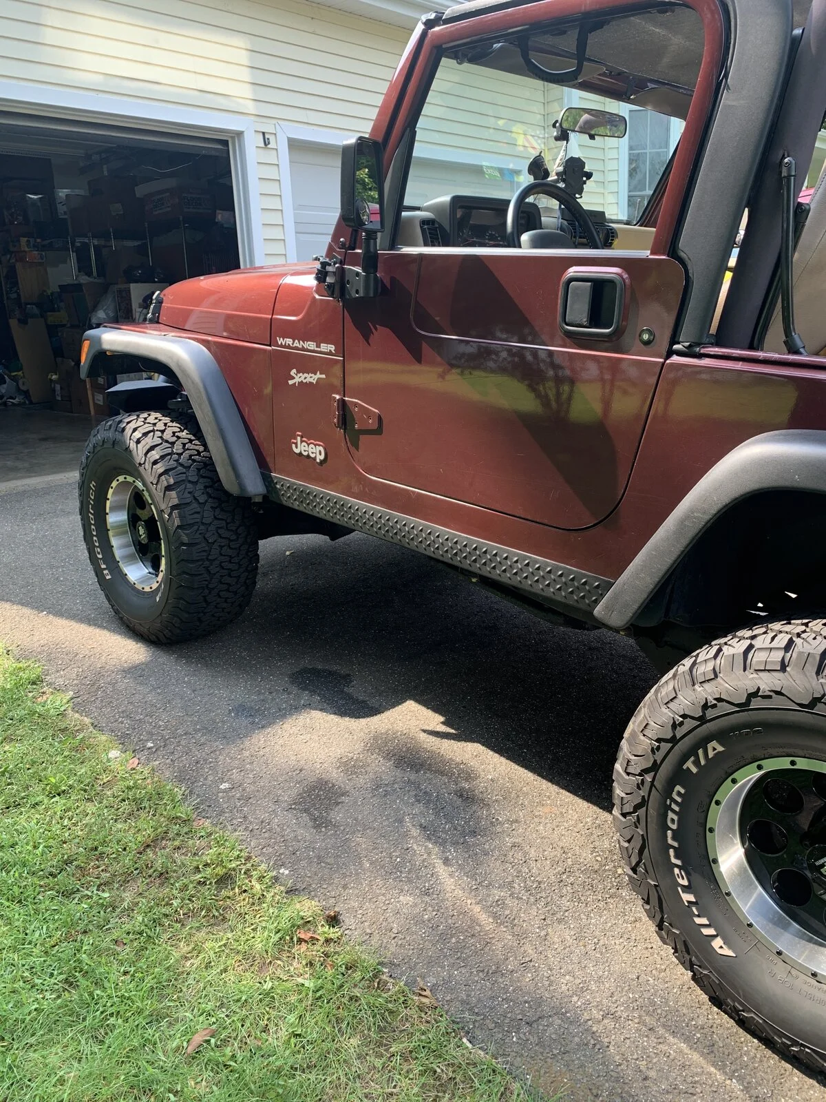

Finally grinder down my rocker rust, used some rust converter and paint, and installed plastic rugged ridge Diamond plate rocker guards. I wanted to get real rock sliders but these were $60 compared to $400+ and I don’t really have a need for real sliders so I figured I’d give them a shot. Definitely beats looking at the rust
I also ran a line of black silicone along the top to try and hide the gap and prevent water from entering, as well as a lot of fluid film on the area behind it

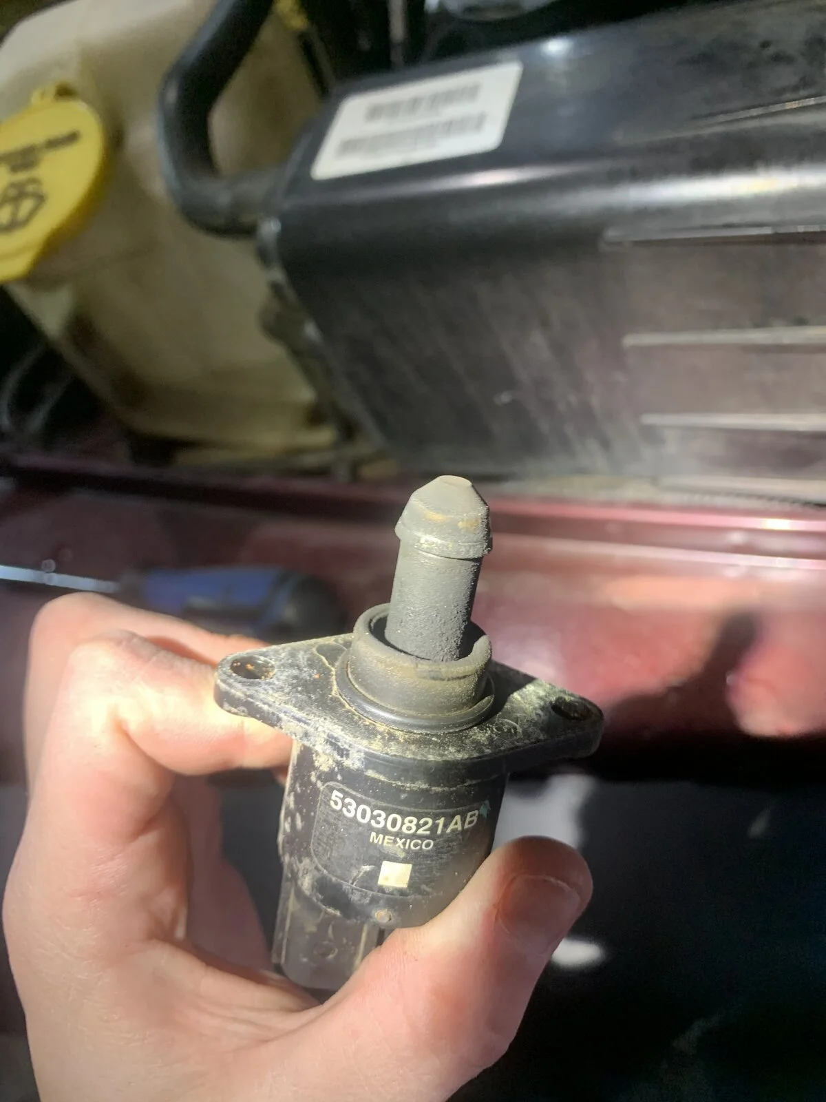

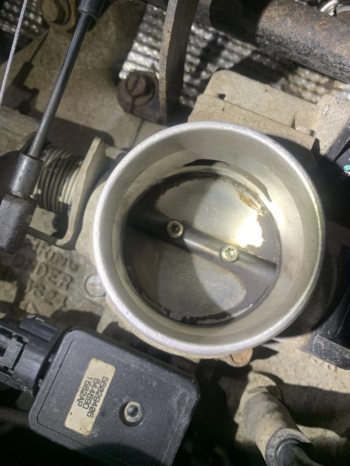

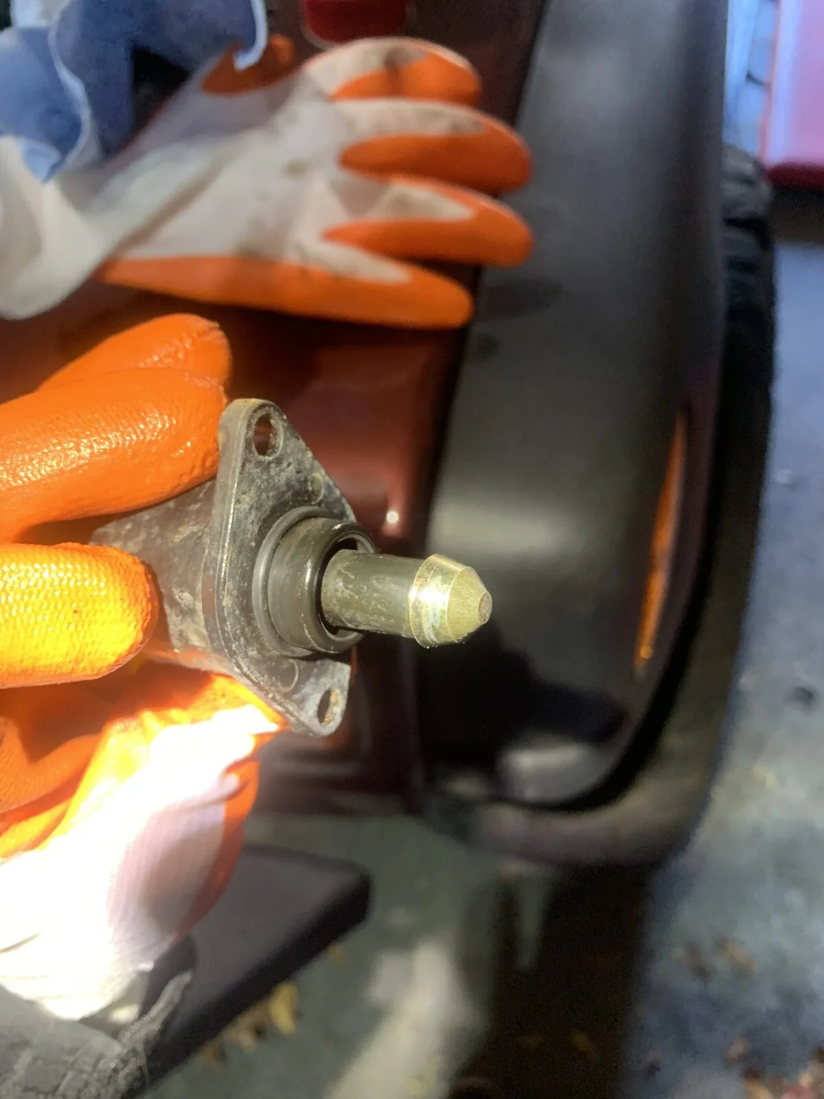

Also this week I cleaned out my throttle body and IAC sensor since I saw a thread on it, very easy so figured I’d give it a shot even though I didn’t have issues. Was definitely dirty so glad I did, although I didn’t notice any difference
Before:
After:
Followed @Jerry Bransford ’s advice and sprayed a bunch into the throttle body with the engine idling, then emptied the rest of the can while revving it a little

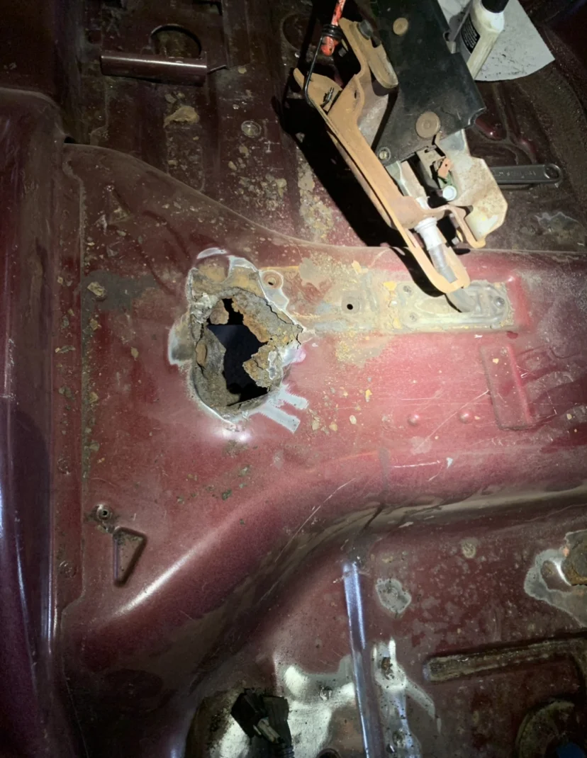

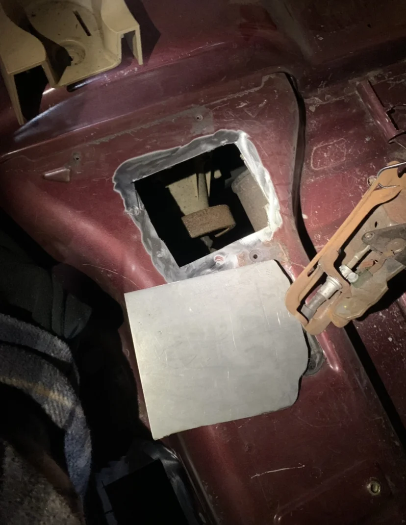

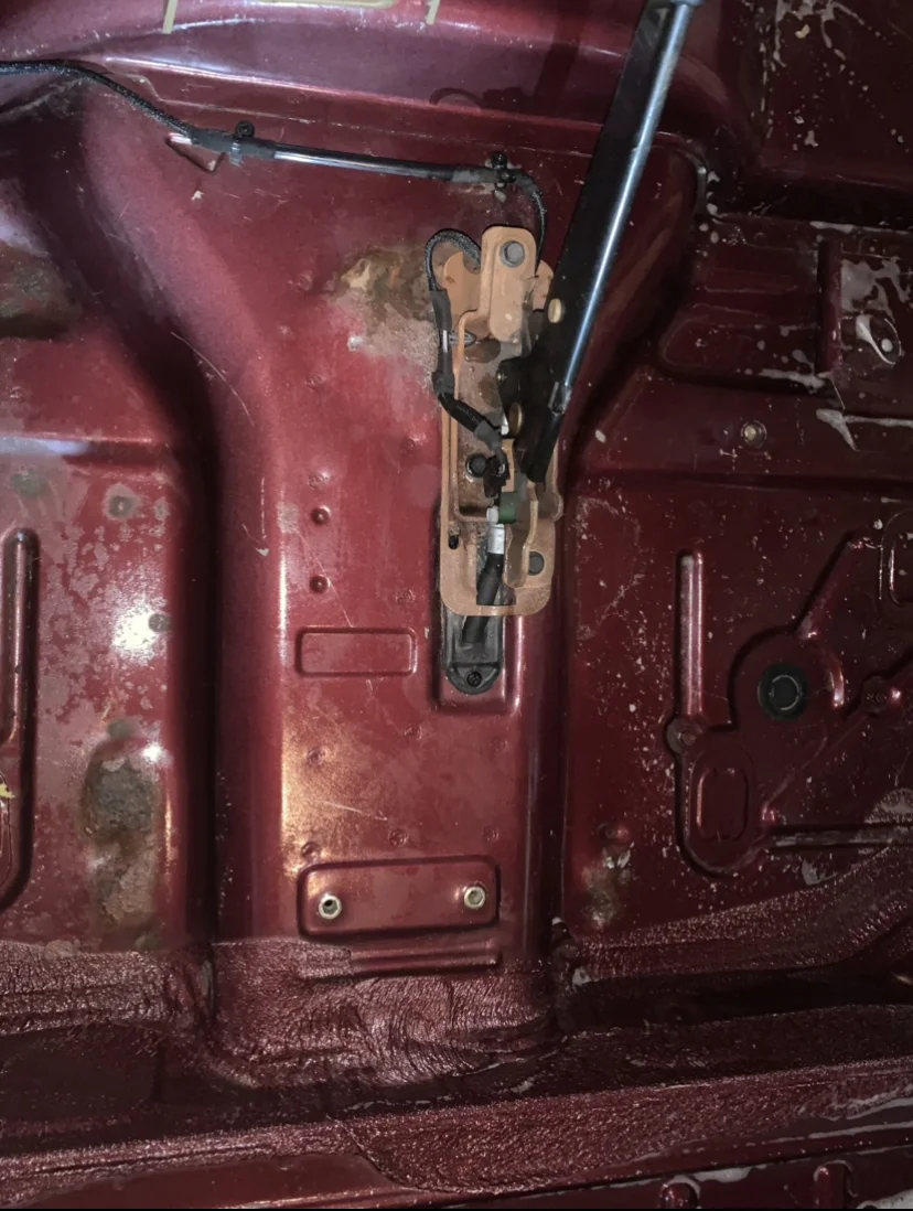

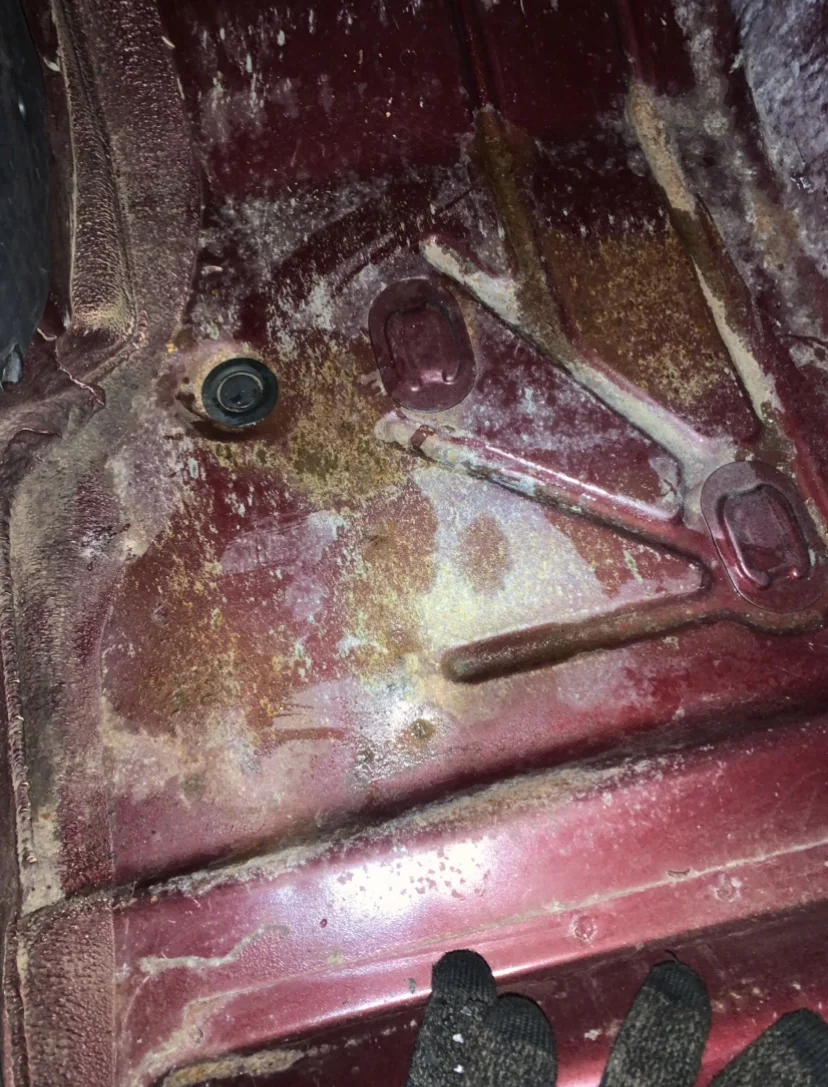

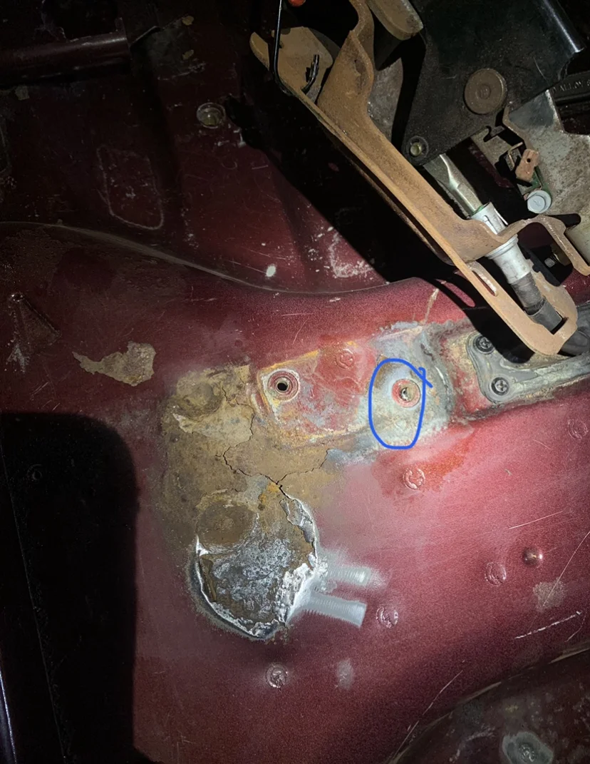

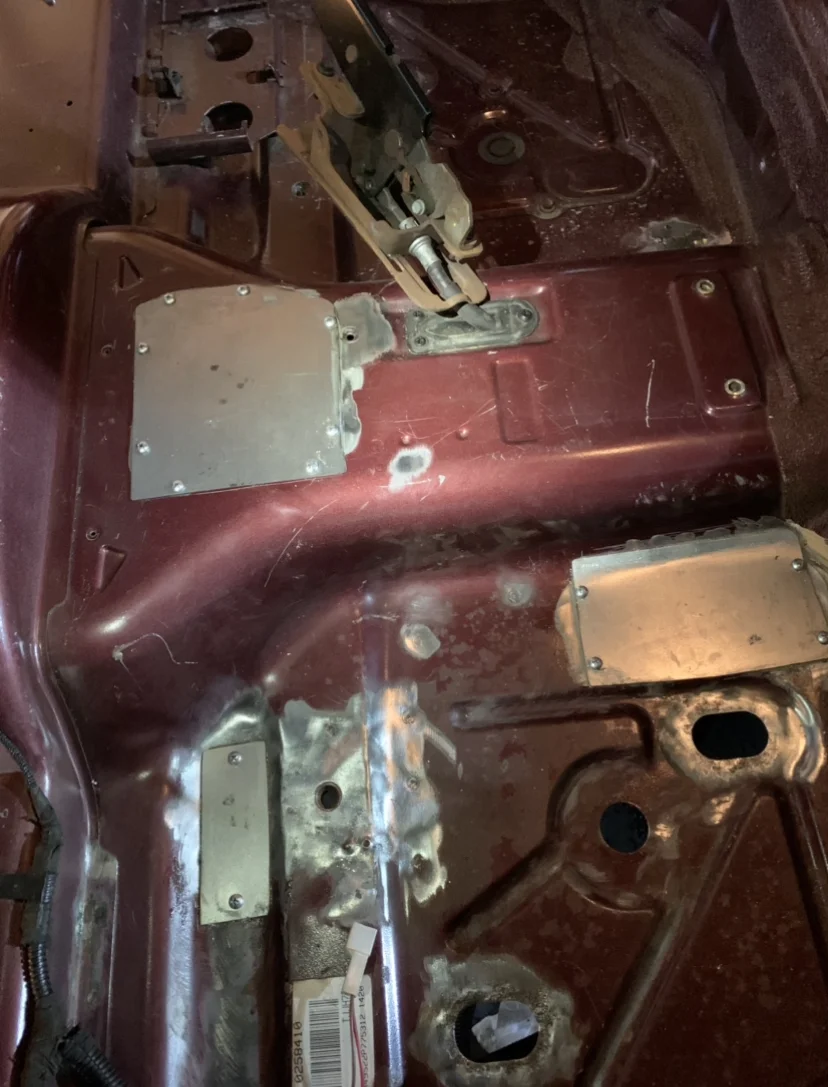

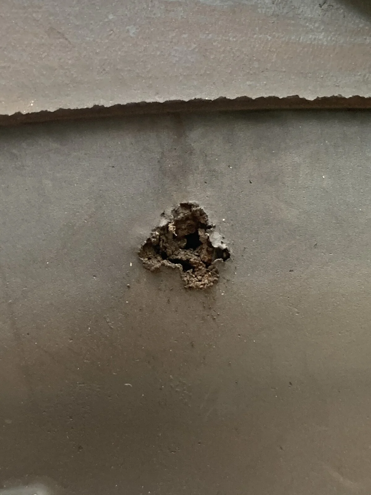

Once again the curse of New England strikes again. I began last week by going out to start my journey of soundproofing. I bought noico 80mil, rollers, and finishing tape as well as a full set of mass-backed cutpile carpet from ACC Carpets. I removed all my seats, carpet, and console to begin but I discovered the rust underneath was worse than I knew (as discussed here).
I didn't want to just cover up the rust, so I started attacking it with my angle grinder and drill with wire wheel brush. Unfortunately once it started flaking off it revealed some holes
So I cut out the rusted area, and bought some sheet metal that I cut to size
Using construction adhesive and sheet metal screws I covered up all the holes, then covered all the bare metal with a coating of brush-on Rustoleum paint (didn't get an after pic).

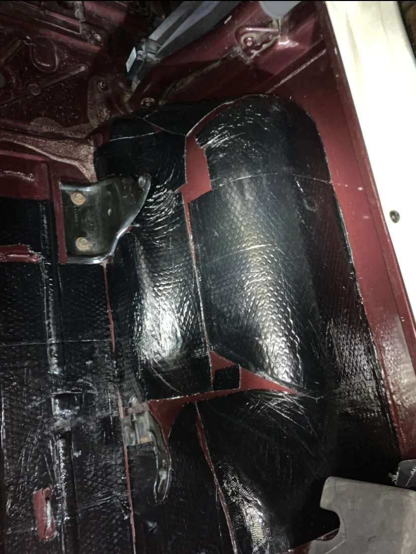

And on Friday I could finally begin what I started Monday, the sound deadening. I was only able to finish the rear fender wells and cargo area so far since I ran out of time and had to put my seats and the new carpet in to use my car. Eventually I will go back in and finish the entire tub, but it might not be until spring since I am moving back into school in a week.
Reactions: DuncLJ

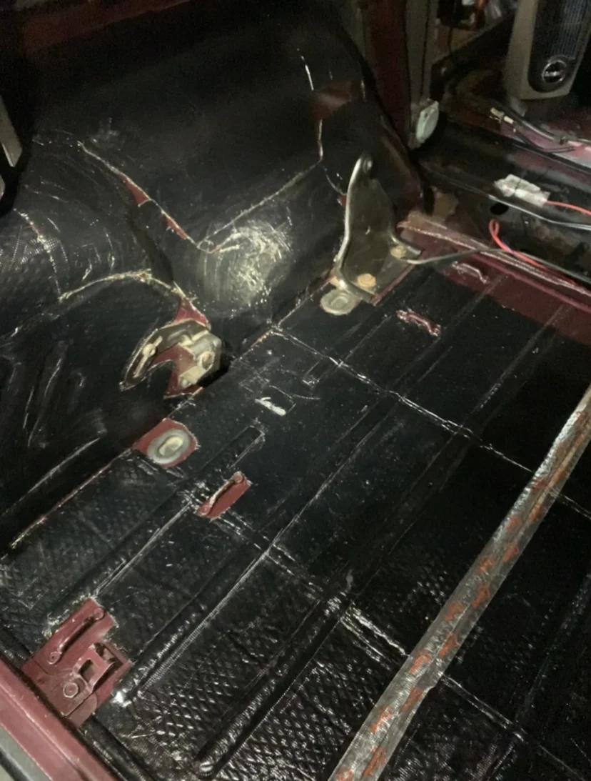

It’s been awhile… I FINALLY had time to finish my sound deadening. I forgot to take pictures but I got a few afterwards:
I did almost everywhere I could think of, way up into the firewall too. Eventually I might do the doors
I wasn’t expecting anything crazy, especially with the soft top, but I was still disappointed. I noticed almost no difference, I measured a 2db decrease on the highway at 75mph, from 81 to 79. I guess I’ll just have to hope it will have been worth it with the hard top on
Maybe in the future I can add 150mil over the top, do the hood and the doors and see if I can get any better. Just the 80mil and mass backed carpet didn’t do much

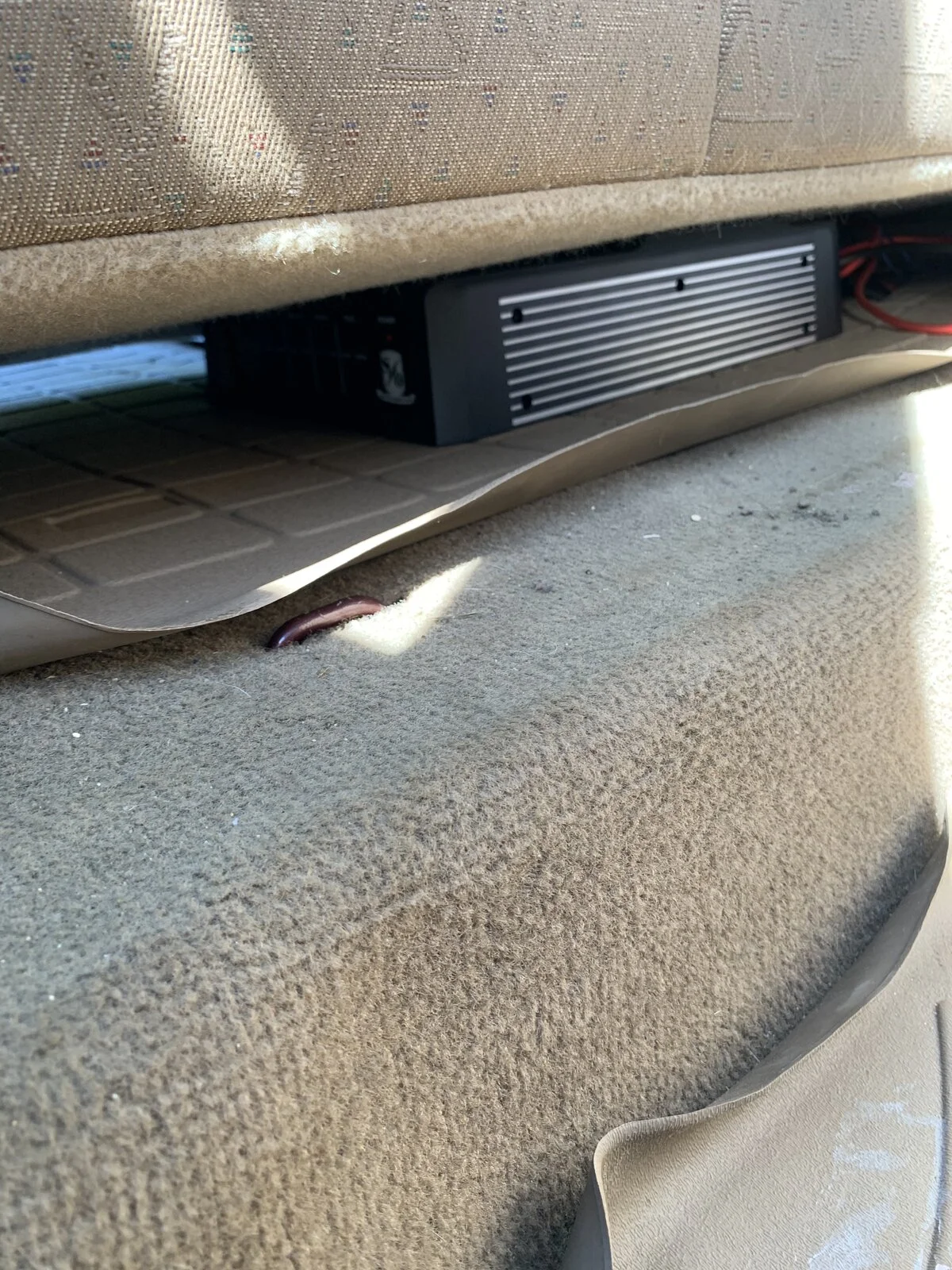

Got my new JVC marine head unit and sound ordnance 4 channel amp installed the other day. Still have to play with it to get it to sound how I like (especially with the top down). Still tempted to buy a seperate tweeter for the front, but I’ll save that for the future
