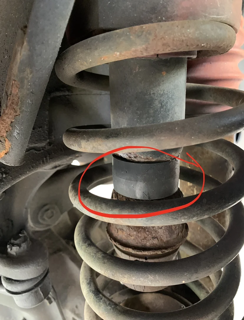

Am I correct that the circled part of the spring tower is a bump stop extension that must have been installed by the previous owner with the spring spacers?

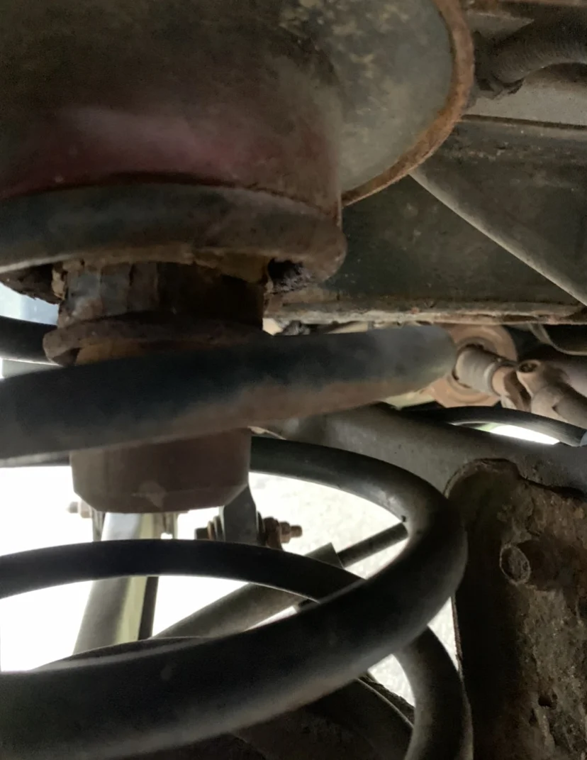

The rear one does not look extended, not sure why they would have only extended the front
My zone lift also came with the extensions that go on top, but I plan on instead putting hockey pucks at the bottom of the spring perch in front
Am I correct that the circled part of the spring tower is a bump stop extension?
Yep. Factory setup has the cup where that spacer is. If you have a rear trackbar relocation bracket and no extended bumps, be careful not to smash the trackbar into the tub or the fuel lines that run right above it.

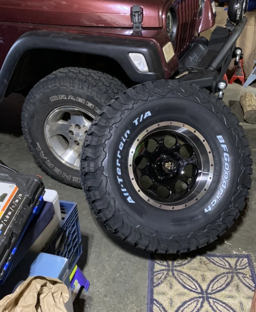

Wheels and tires from discount tire finally showed up today finally, I'm very excited. I will be starting my lift install in the morning, praying I don't break any body mount bolts (I've pretty much accepted the rear shock bolts will likely break, even with a ton of penetrating oil)

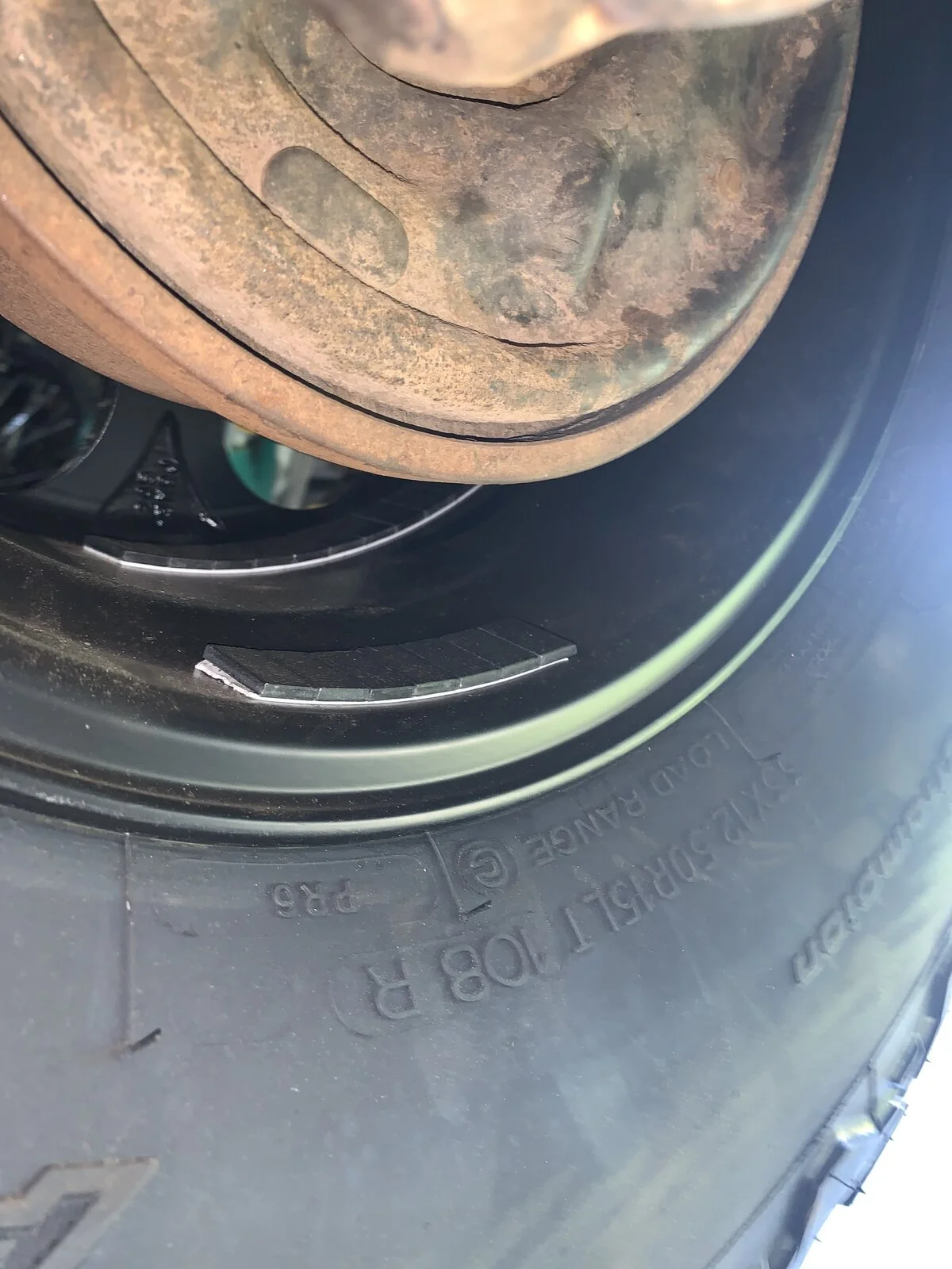

Is this an acceptable amount of wheel weights? I counted 19 on this wheel, the others had a lot too but not as many. It seems excessive to me, was balanced by discount tire and shipped to me

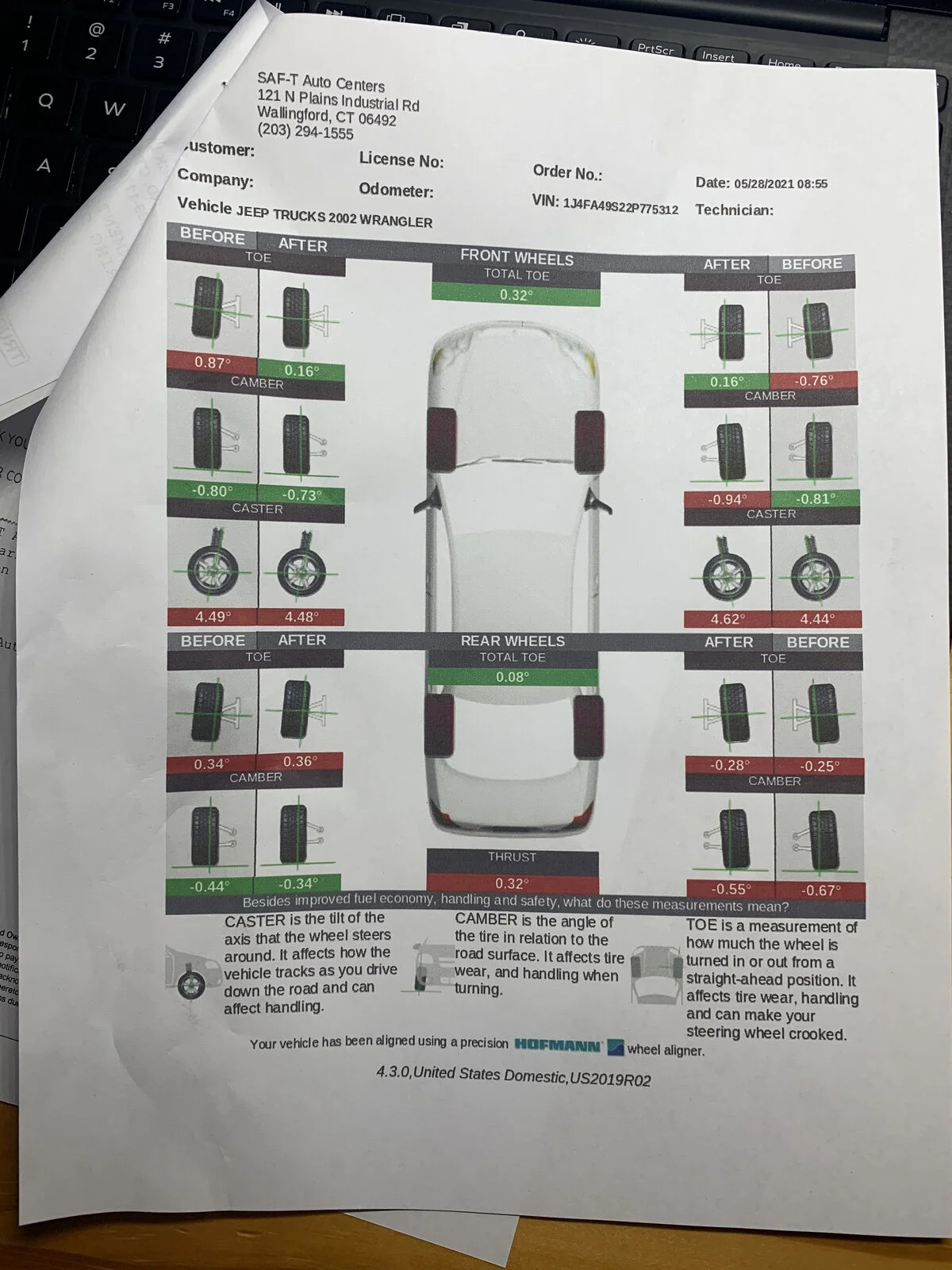

Got my alignment done yesterday. Do my caster angles seem okay to stick with stock control arms? I recall seeing @Jerry Bransford saying around 6 degrees is ideal with 33’s
I plan on replacing my arms because the bushings look really cracked and am debating between a set of stock arms or some cheap adjustable arms like the core 4x4 tier ones. I am tempted to buy the savvy double adjustable, but they are way more expensive than what my uses

I'd suggest the tier 2, so you have at least one flex joint. Caster is a bit low, but if it's not wandering at speed, run it.
The tier 2 is $300 more, and if I'm spending that much I'd probably rather spend another few hundred for the savvy
It does seem to be wandering a bit, but my steering box has a lot of slop so it's hard to get a feel for it. I think I'll first swap in a reman box from napa and then get more of a feel for it before deciding on arms, if I can stick with the stock ones I can get a full crown set from summit for $192

That caster is a tad low for 33's, it's time for adjustable front control arms. As above, how quickly they're needed depends on how well your Jeep is tracking on the highway and if you have sufficient steering return to center after completing a turn.
