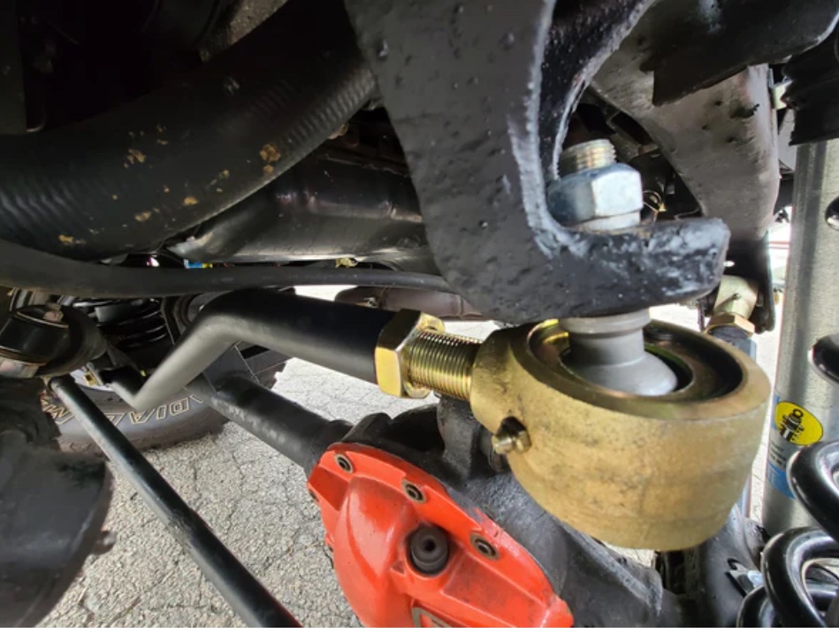

Thats a great choice if you want it to hit the gas tank skid and bind up on droop so you can barely get coils out. I chucked it for a 10 year old rockjock and have no regrets
This is what I don't like about the front RC bar...even less flex when I swapped the bushings for larger bolt size. Maybe time to try the currie...
This.
I had RC track bars front and rear. The rear smashed into the tank skid and caused binding in the rear. Swapped it for a JKS and have not had an issue with it coming in contact with the gas tank skid. The JKS has a kick towards the front coming off the frame mount to clear the gas tank skid.

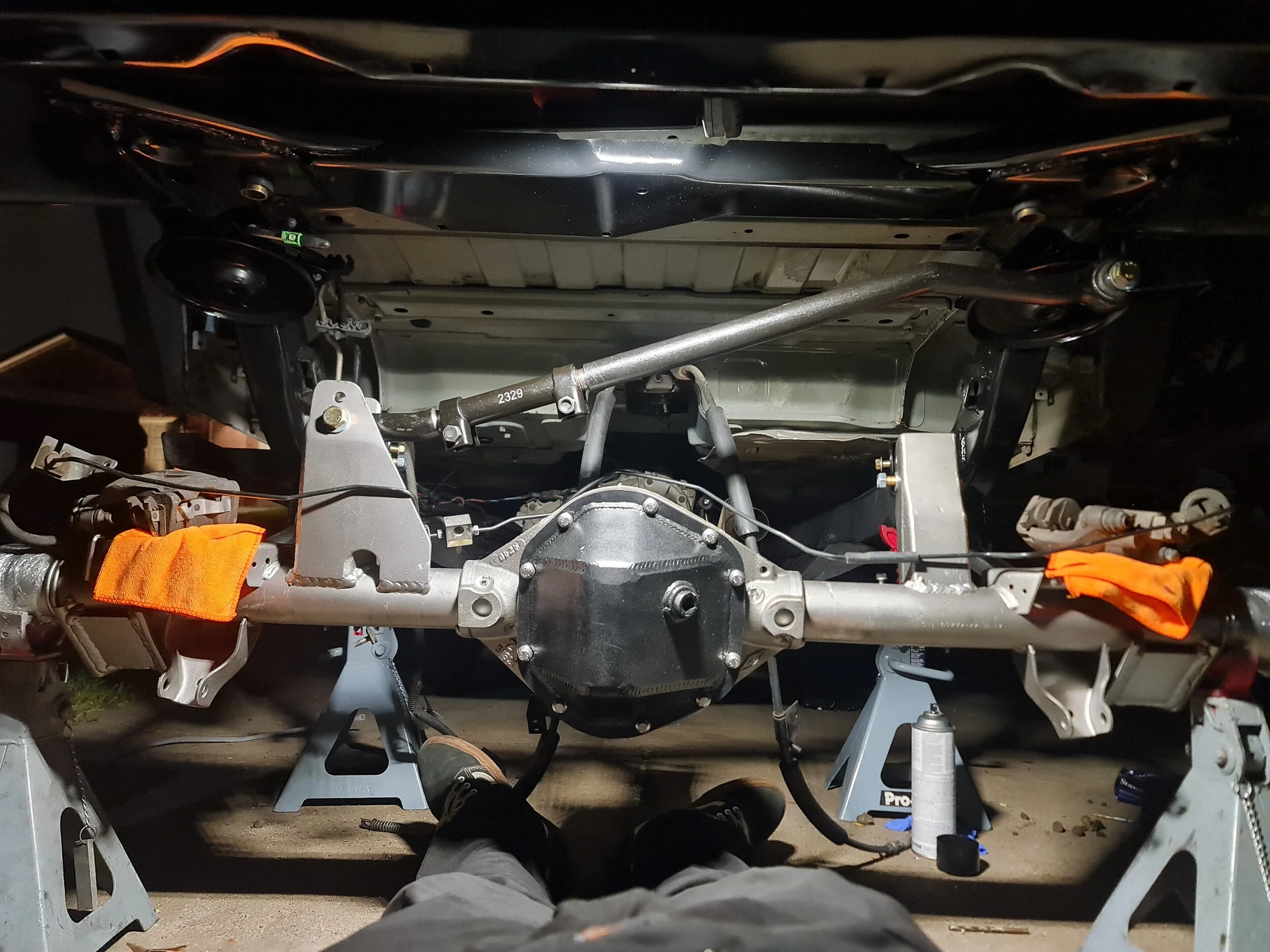

When I built my Dana 44 with the Jeeps West brackets a few months ago, I have clearance,not much at full stuff but clearance nonetheless,The clamp bolts did hit it but I just flipped em and problem solved
I wasn't limited on droop,The axle would just free fall when no jack stands were In place. I just have to give it a good push with my hands to get it where I want but that's what's it like with any TB with rubber joints when your installing springs,taking em off etc.
Edit- I didn't struggle with that is what I'm trying to say
The moog joints seem to do their job, The TB is an alright piece,Just take out the shitty bushings it has and make it work and it'll be fine 🤷🏻‍♂️ I also had the flexibility to move brackets around when I built this axle so I was able to accommodate any clearance issues
