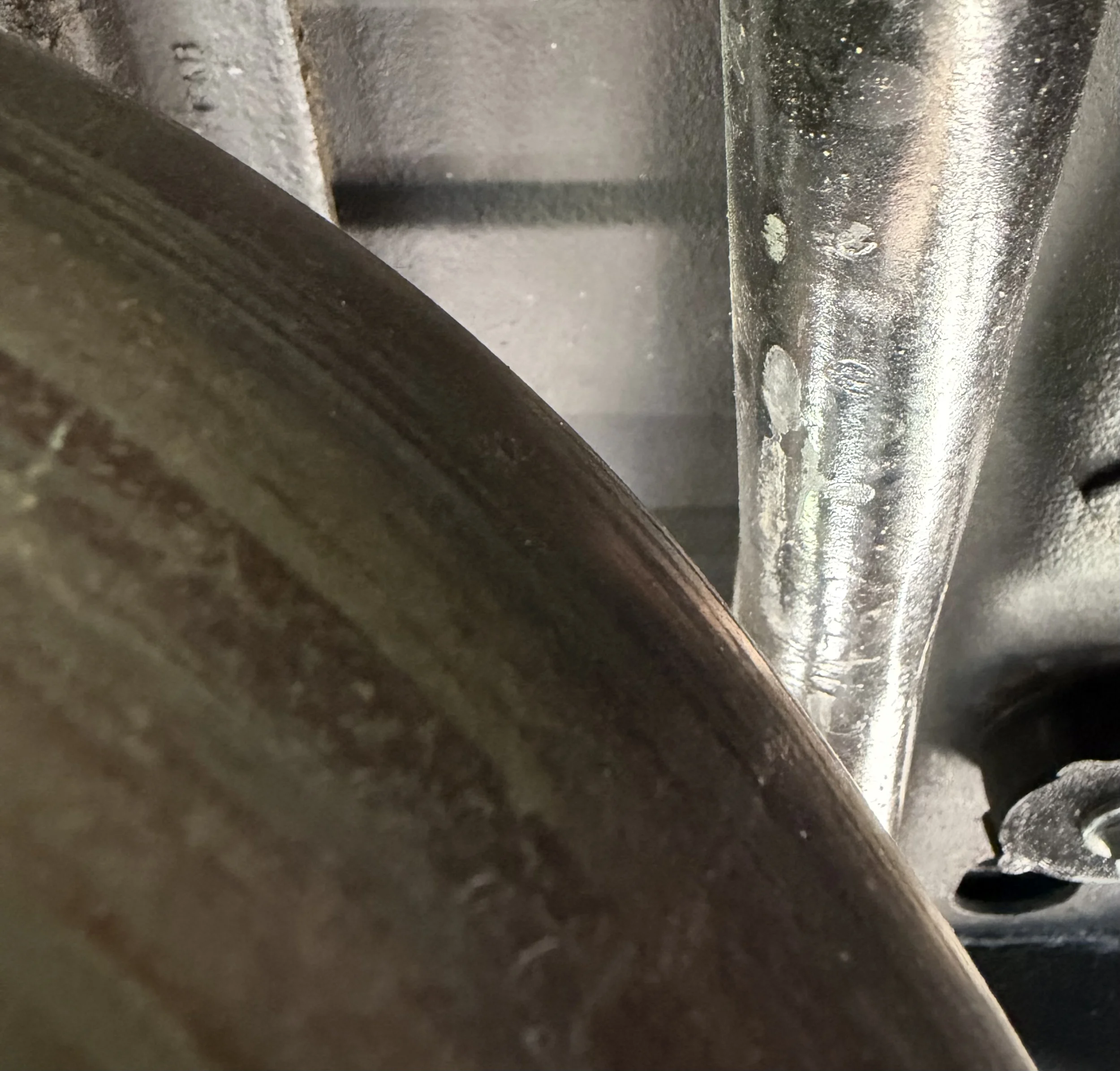

Did some more poking around and noticed I had some wear on my rear track bar. Not much clearance between the exhaust pipe. Definitely think this could be the winner, going to try pulling the pipe to verify.
