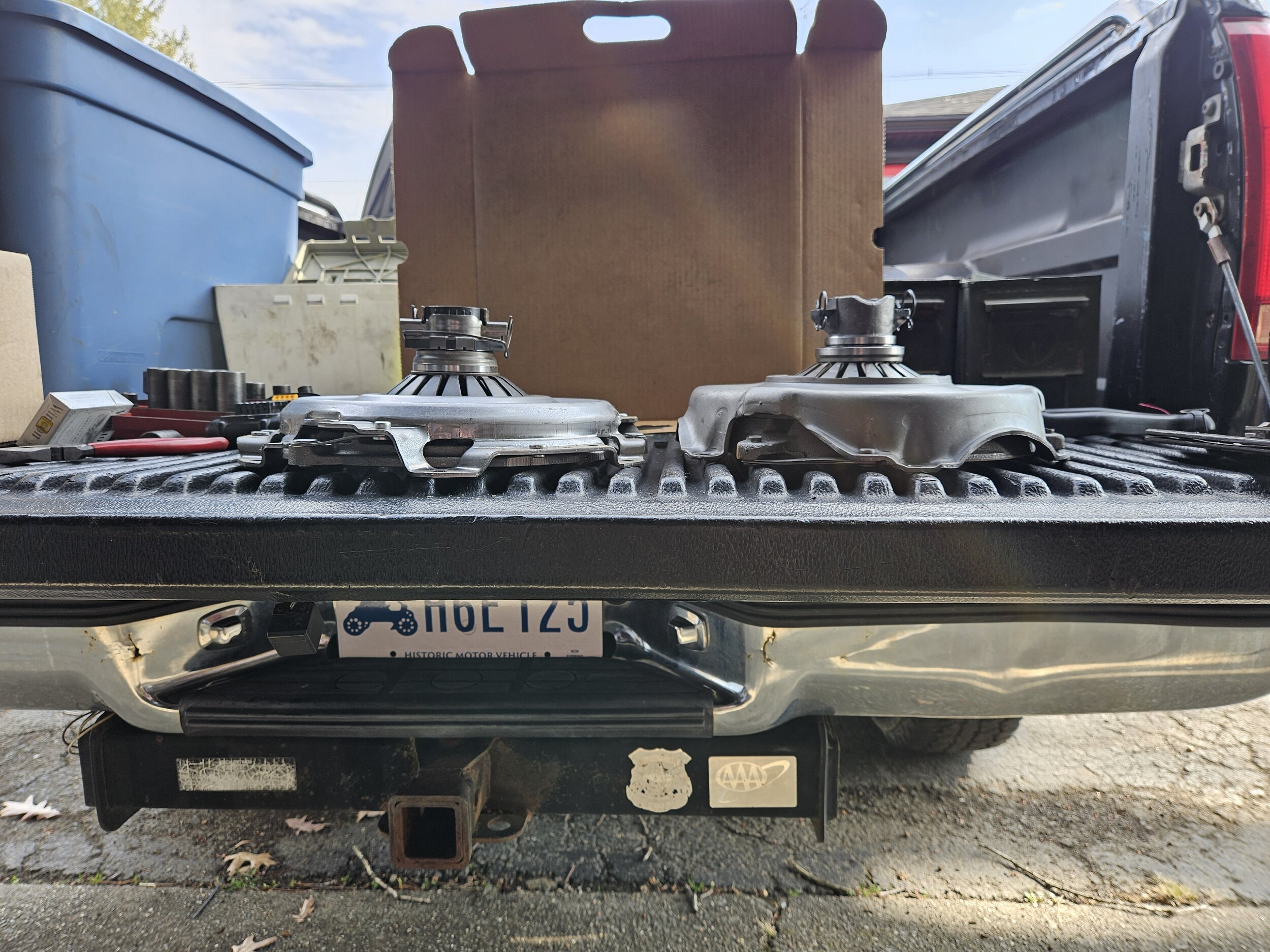

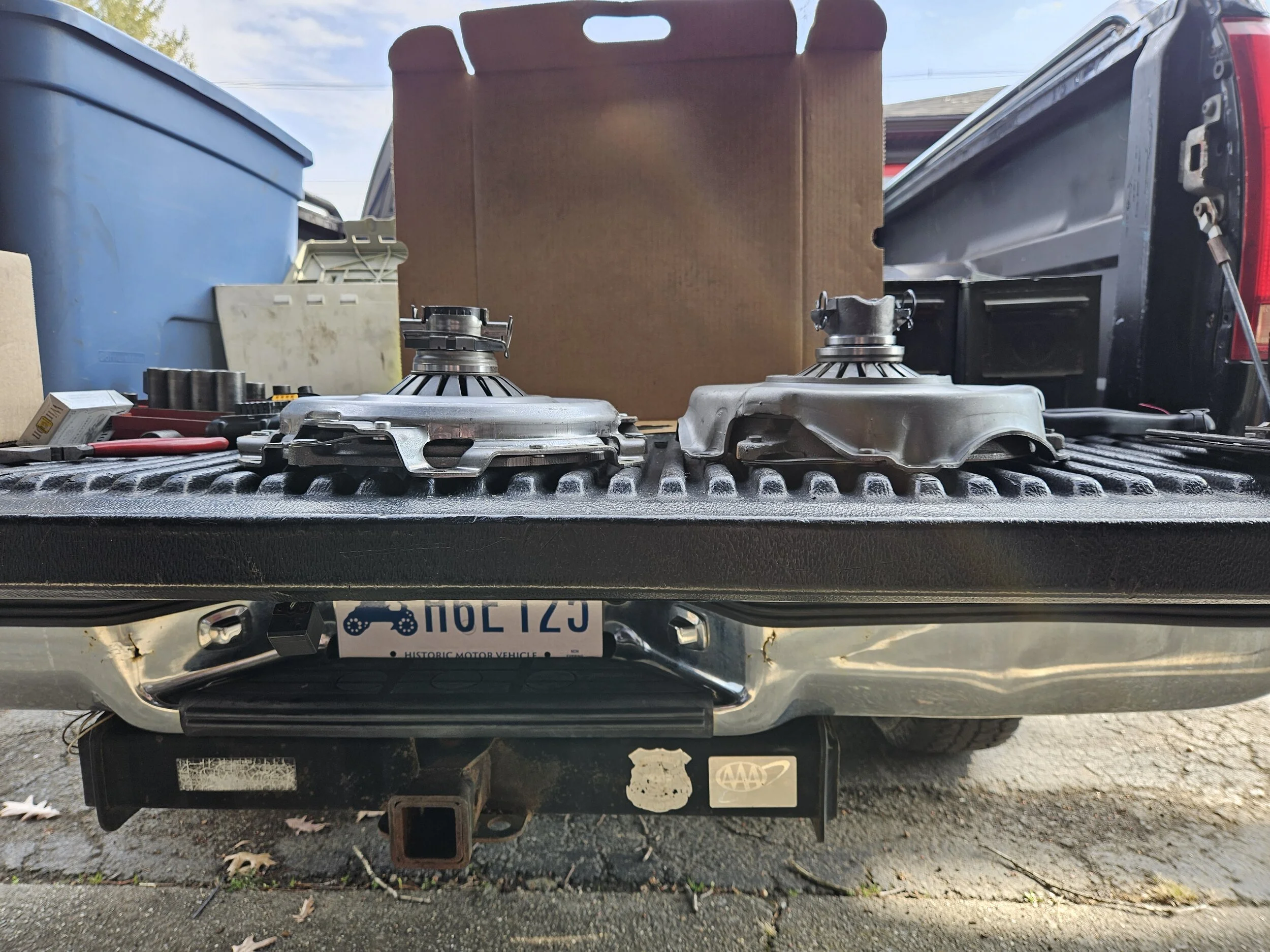

Ok ! I have an update on my clutch not releasing on my 04 TJ. After pulling it three times I found the issue to be the wrong pressure plate. The rebuilt one is on the right and the new LUK clutch assembly is on the left. You can see the difference! Once the new one was in it shifted like butter! No grinding or anything,so if you ever run into a clutch situation on you TJ I hope you will remember my issues ! We all learn something new everyday!
