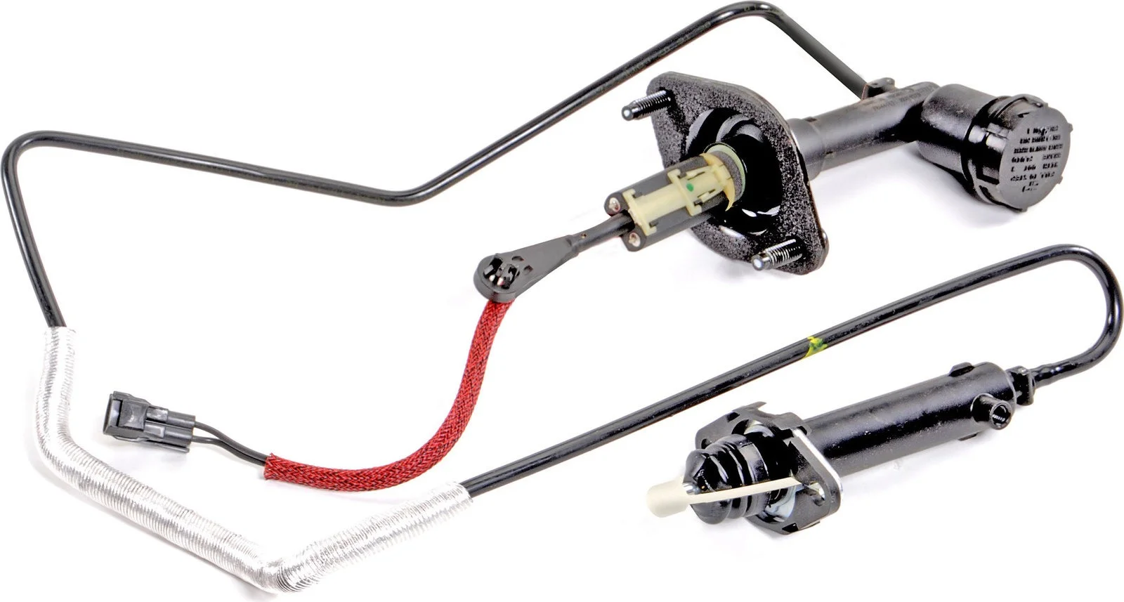

Might just need one of these deals (master cyl assem):
What I meant by harder is it taking more effort to push the pedal down. I have checked the fluid, no issues there. I have not had any issues of slipping but do not have any info on if its been changed and the jeep has 187K on it. I guess I was over thinking it, probably just needs the master/slave and it'll be good to go. Thanks you may have just saved me a bunch of unnecessary work.

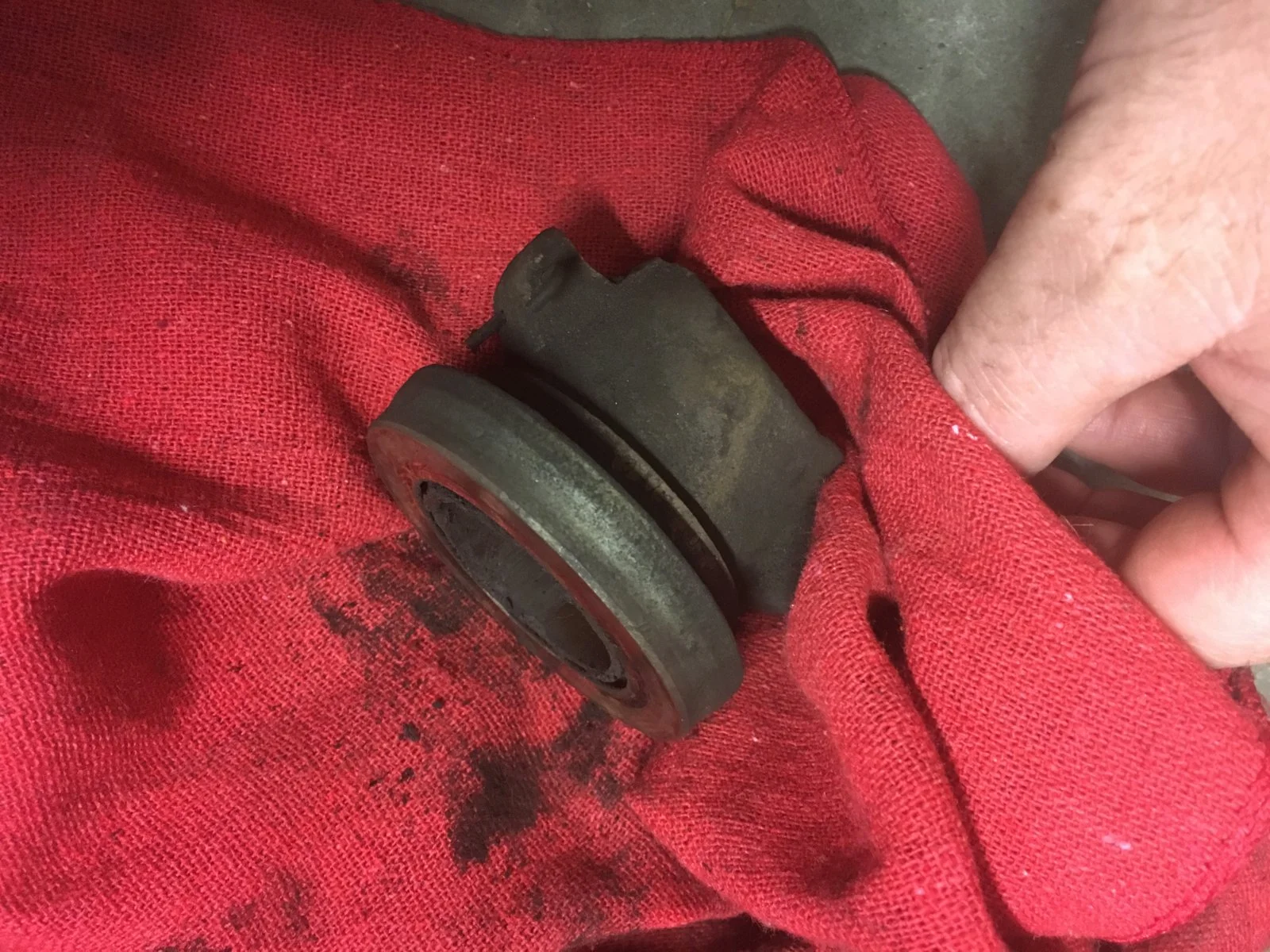

A binding throwout bearing can make it difficult to push.

Throw out bearing was squeaky/crunchy and one of the retainers were broken

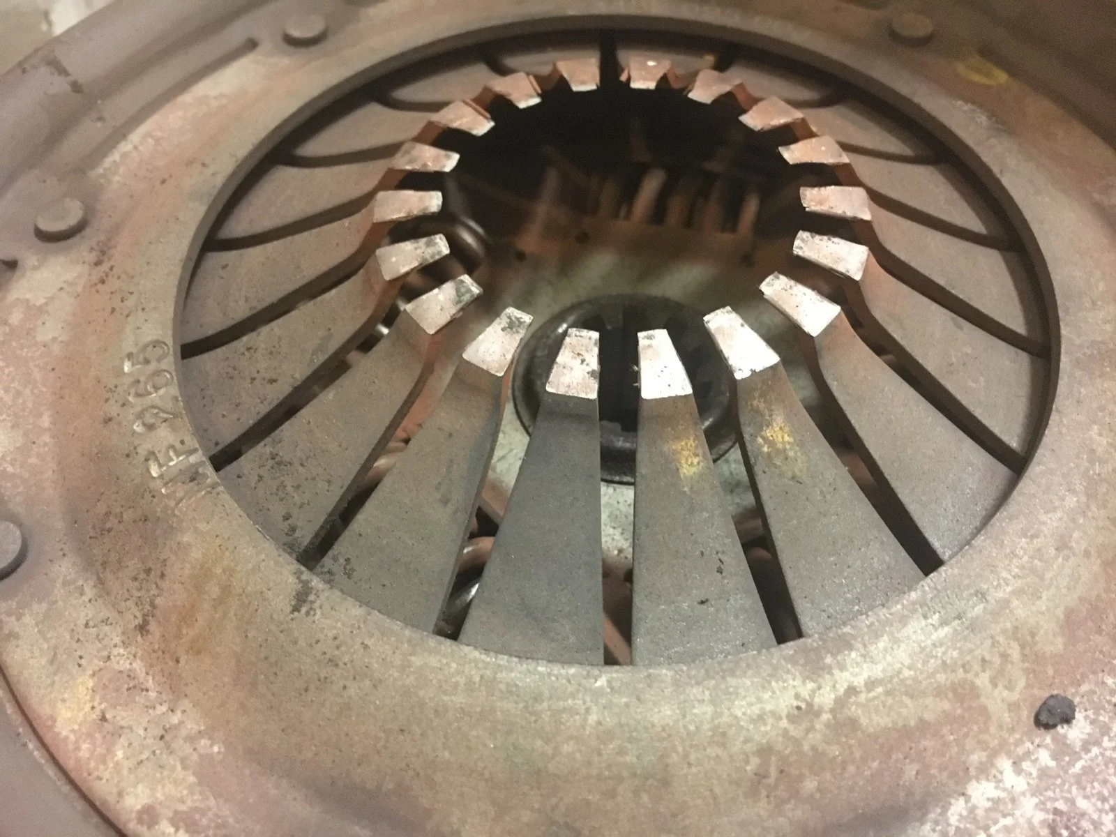

Pressure plate was worn pretty bad, the ends of the springs were as sharp as a razor

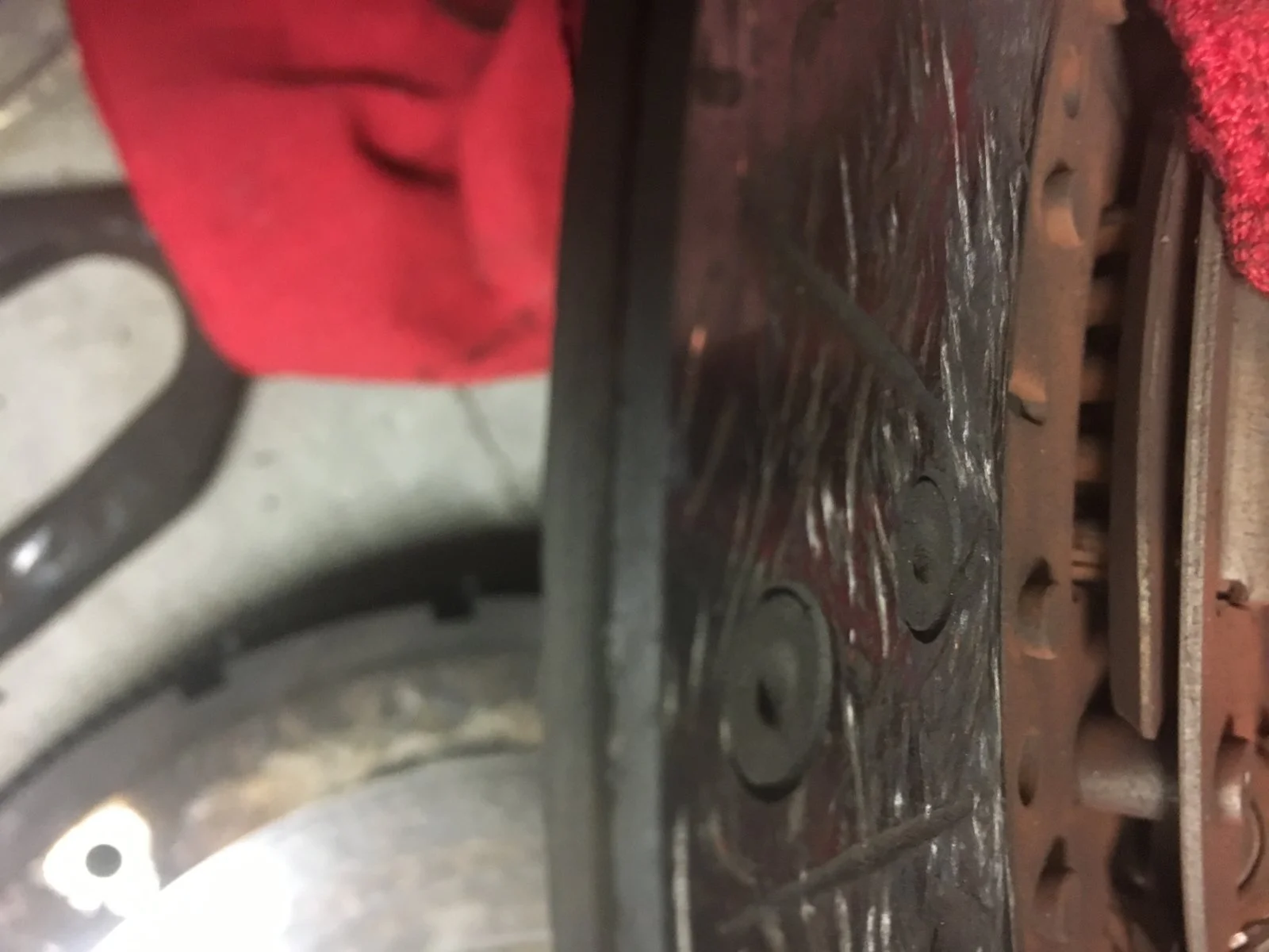

The disc still looked good but was getting close to the rivets

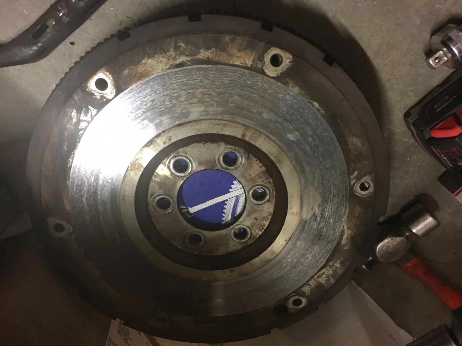

Flywheel was good, couple hot spots but no grooves. I replaced it anyway. Time taking it down to be resurfaced vrs. new...

Good call on replacing the flywheel, the TJ flywheels can’t be resurfaced.
Did you go with the LuK kit? Which TOB did you use?
Really no reason to replace the flywheel unless there is physical damage, it can be cleaned with emery cloth and or a wire brush.

assuming you receive the correct one...... Amazon sent me the wrong Luk flywheel, the one they sent was for a 2004, in 2005 Jeep apparently made the crank positioning sensor more precise and it then required 24 lobes on the flywheel as opposed to 12 on the 2004.... Luckily, as the poster above stated, the flywheel was still in pretty good shape and I just re-used my old one.
