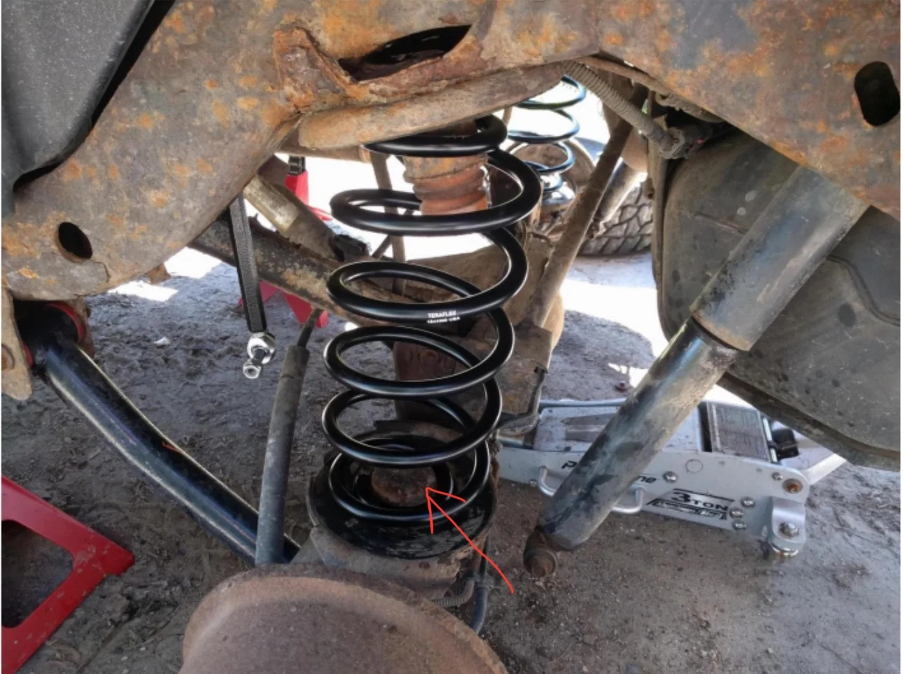

Having a lot of noises in the rear suspension. Initially thought it was the rear end going out due to some popping noises. Then fixed the popping after finding the rear brakes to be SHOT. Now, I"m having suspension related noises and it appears that the rear coils are not tight around the upper and lower perch centers. I'm getting a good bit of noise when hitting bumps and can seem to feel the rear end shifting around. Attached is a random google pic to better describe what I'm referring to if needed.
Are the tapered coil ends supposed to firmly wrap around the center of the perch, or is it OK to have room for movement in there? I have easily 1/2-3/4" of play.
My upper bump stops are also non existent, so I know those need replacing.
That picture is a generic pic on google. Without drooping the axle, I still have quite a bit of play as mentioned above. If i rock the jeep left to right, I can hear them (or something) moving around.

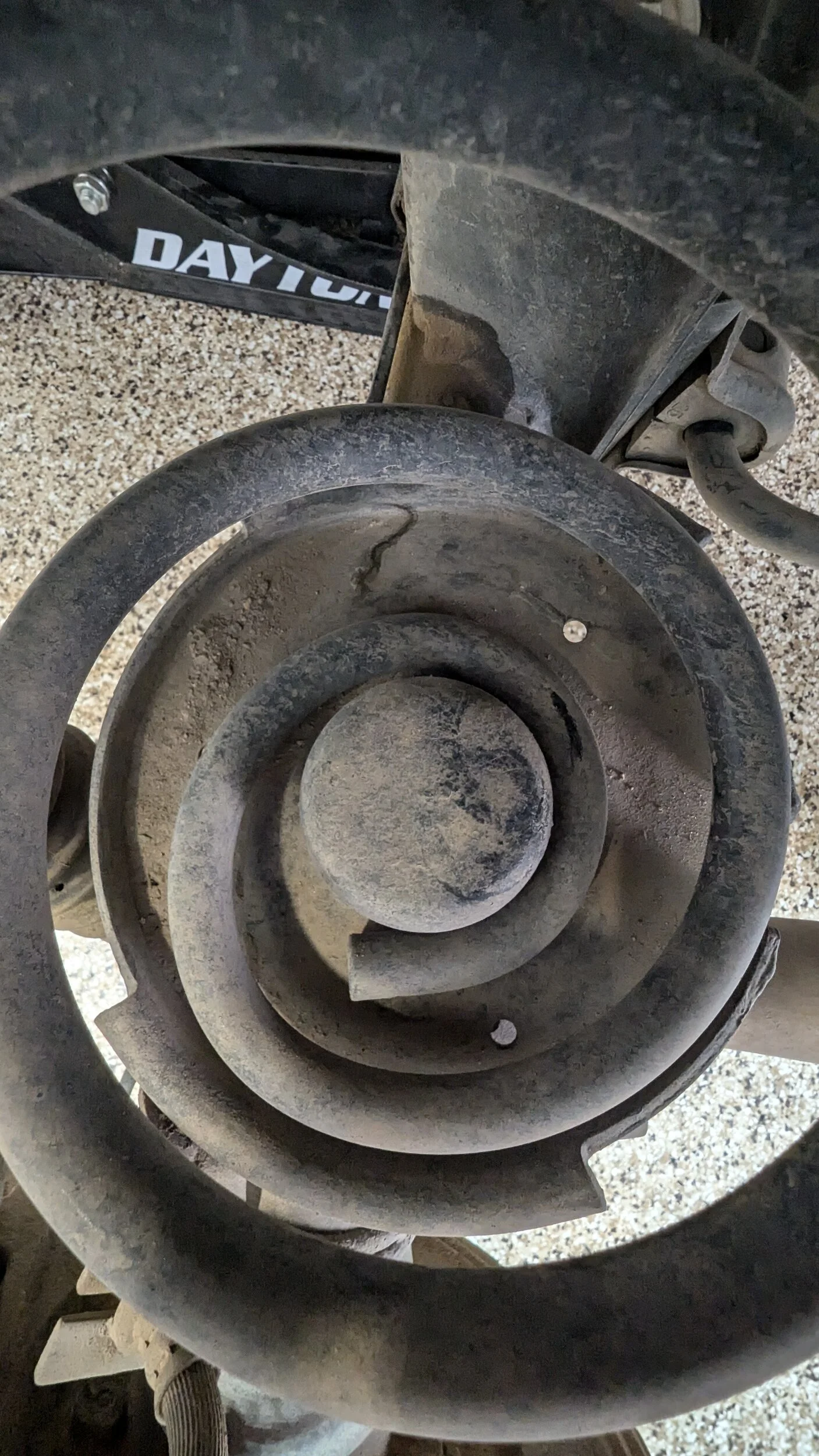

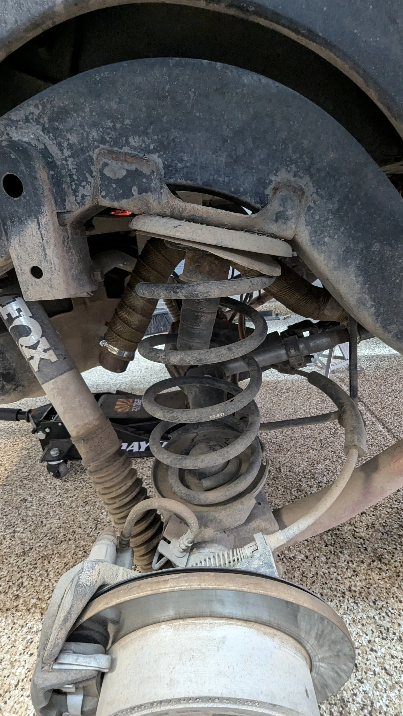

Since I am currently under mine swapping springs, I snapped you a picture of what mine looks like. Is yours different?
Mine looks very similar to your first pic. What made you replace?
