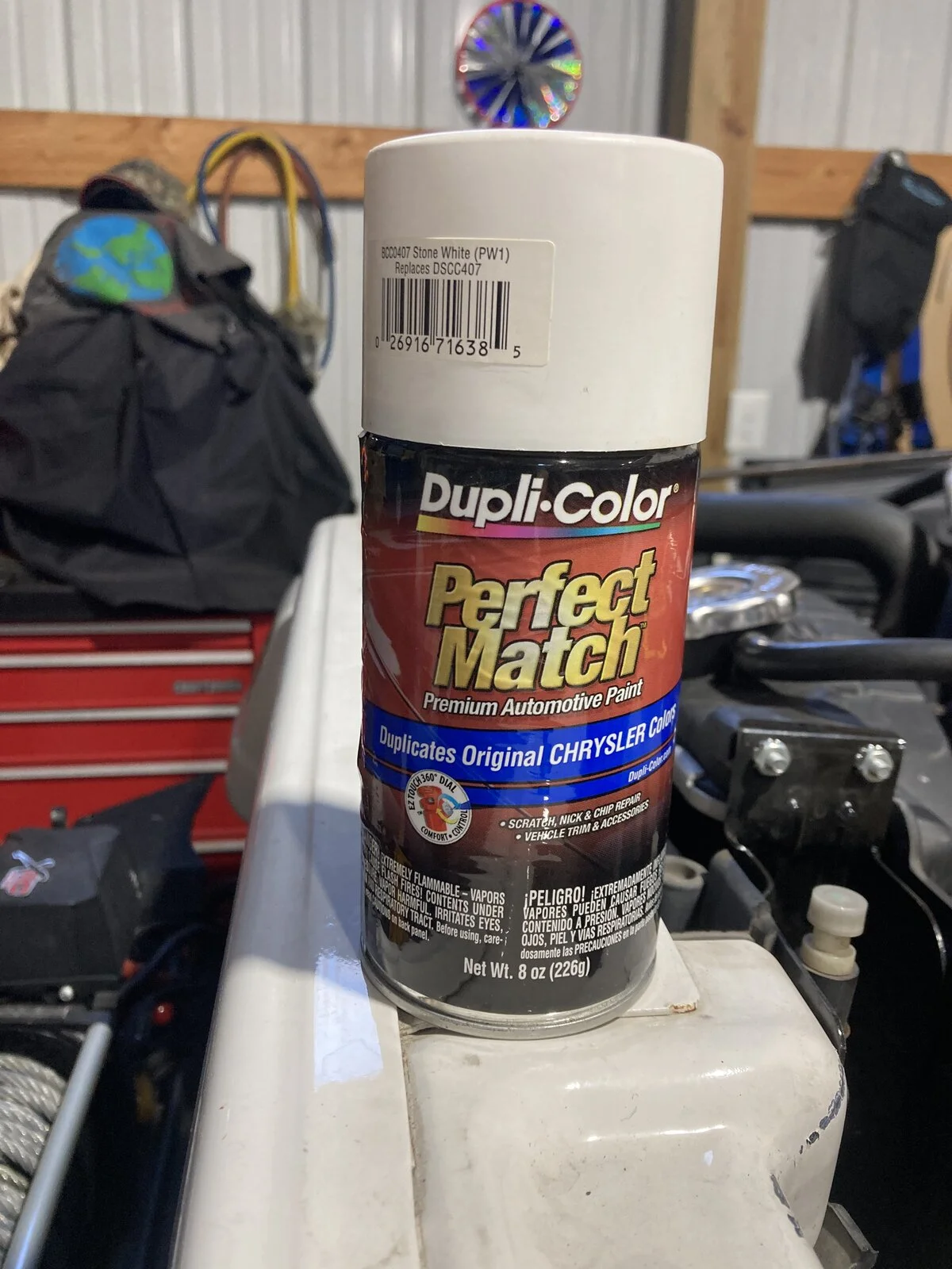

So I couldn’t find any zinc chromate, I read some of the ones on amazon haven’t actually had zinc chromate in them since the 2010s. I think the search on Rust-Oleums site to the best of my understanding is anywhere that carries any Rust-Oleum product.
I ended getting some sand paper, Por metal prep and SEM self etching primer (it advertises aluminum and saw some people praising it on what appeared to be pilot forums). Will report back how it works.
Also got some color match in a spray can and SEM 1k clear coat
