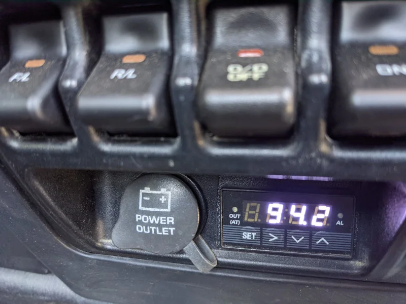

Funny you mentioned a PID, that's what I use to measure the temp of my 42RLE.
Jeep is cold, it's hot today.

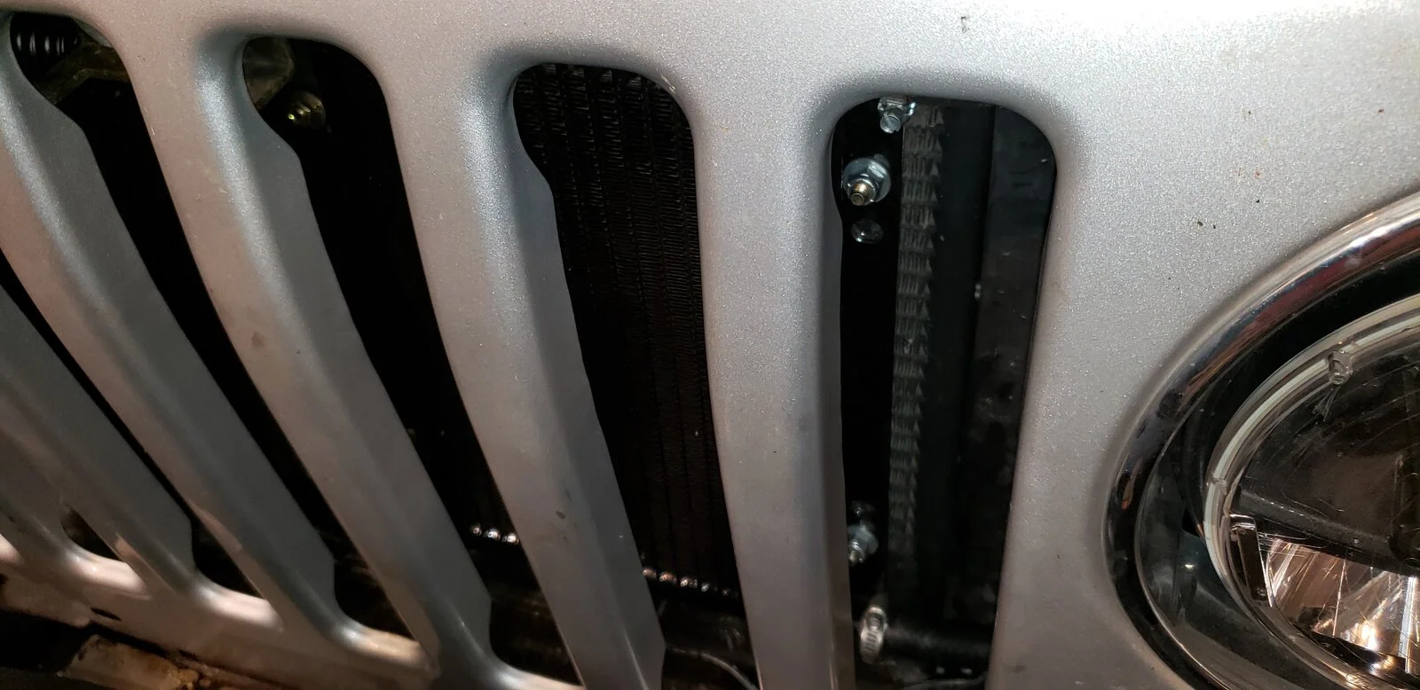

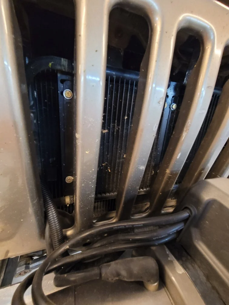

Yup, no problem, I will take some pics tonight.

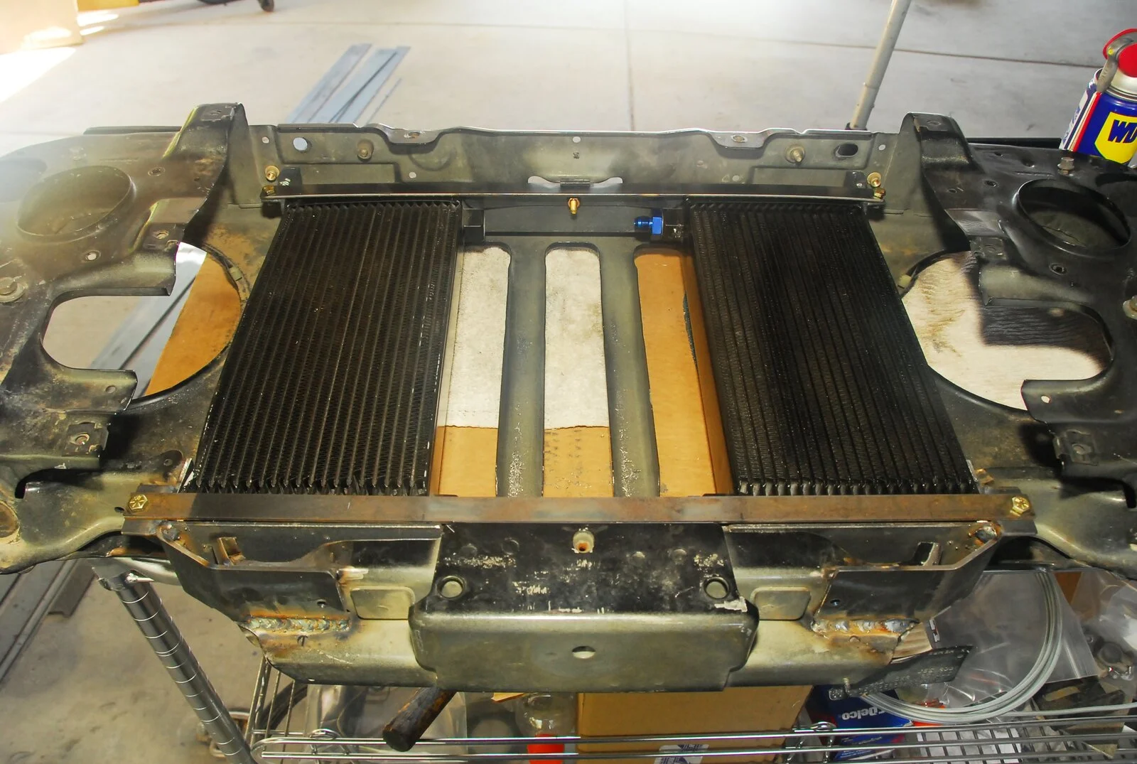

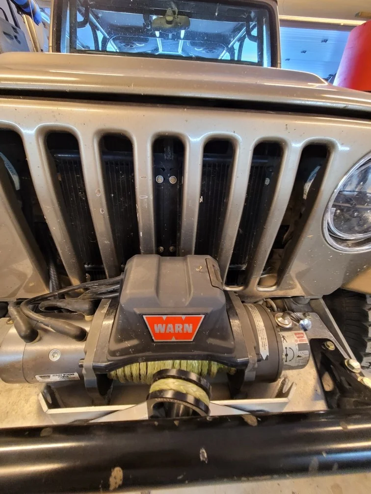

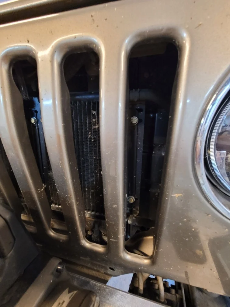

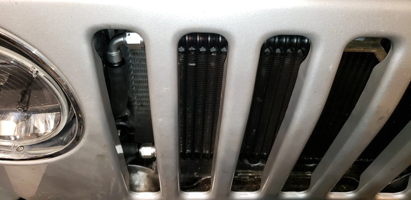

Here ya go @Irun it's a pretty standard setup.. the psc dual cooler with -6 lines.. only upgrade was I ditched the worm clamps for constant tension ones.. seems to work fine for a stock pump and non desert wheeling Trans operation... but I'm considering tearing it all out when I do the hydro assist .. I have never been unhappy with performance after following @mrblaine advice.. and when he says -8 return on the heatsink style single pass PS cooler coupled with a nice bar and plate style single pass Trans cooler I'm listening. I've researched a few competitors and pricing is similar to the Setrab. **edit to actually add the damn pictures... mobile app woes**

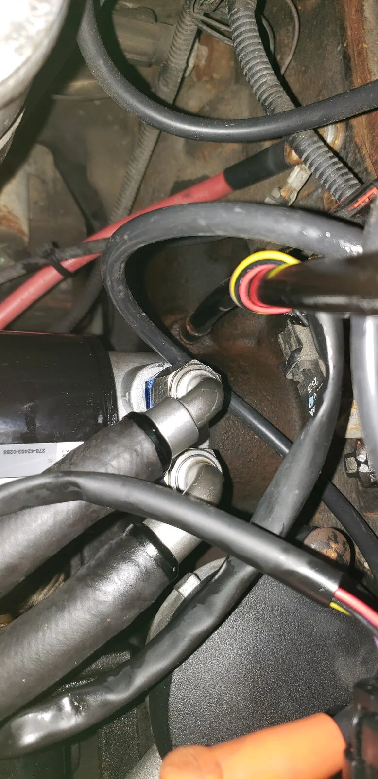

Here are some photos of the 33603 oil cooler and kit on the PSC bracket. Note the original PSC steering cooler is still installed in the driver's side. I plan to swap it with the 33603 shortly.
