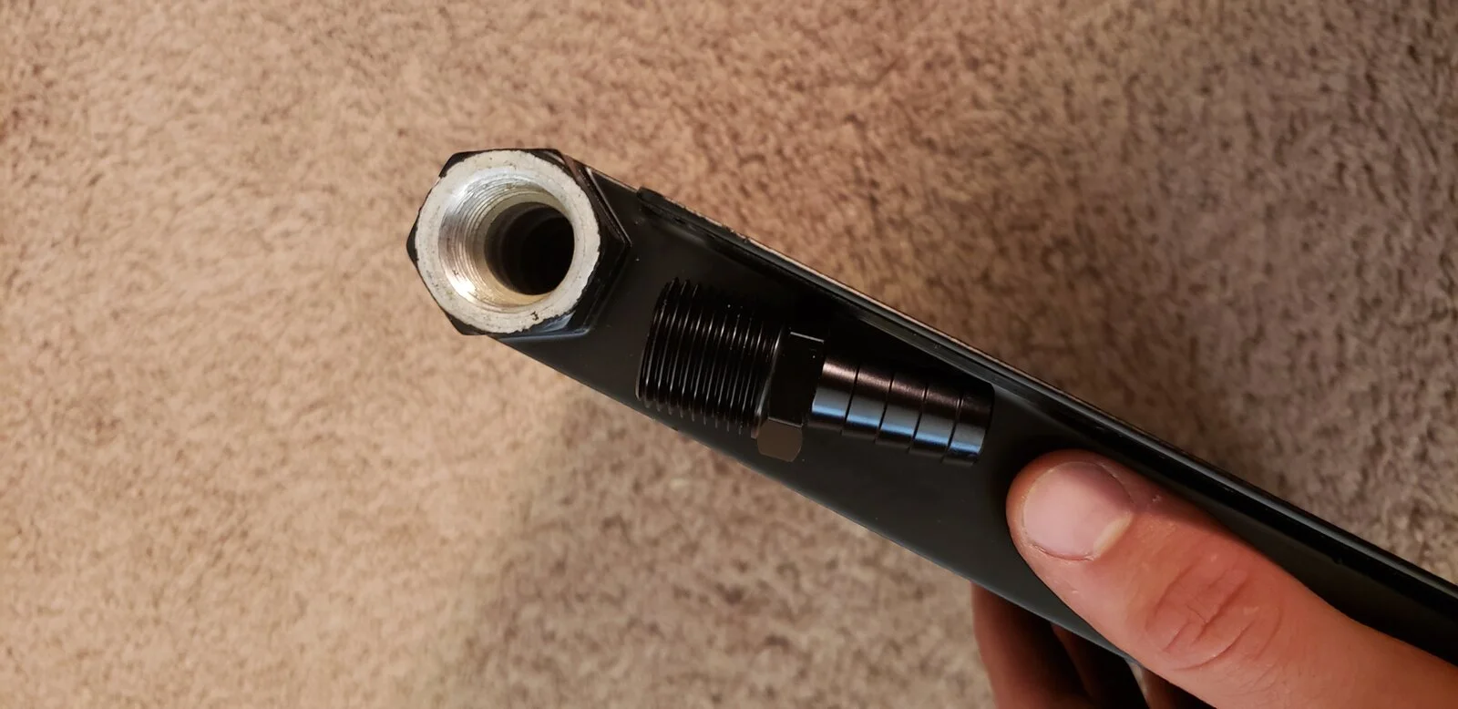

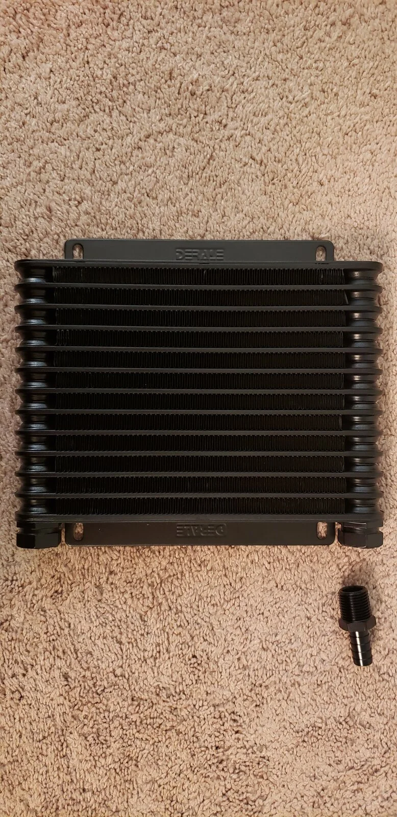

Got the Derale 33603 cooler in today as a part of the 15405 engine oil cooler kit.
As expected, the mounting holes on the 33603 pretty much exactly match the PSC cooler. The thickness looks to be shallow enough it should clear the grille with room to spare.
The fittings provided with the kit are 1/2" NPT to 1/2" barb. Looking inside the cooler, I think 5/8" barb would also work and the barb, rather than the cooler main channel, would be the flow restrictor.
I am going to install this one on the passenger side as an engine oil cooler. I'm still debating as to if I prefer to use the provided fittings or convert to AN or JIC fittings for future convenience.
Interestingly, the sandwich adapter that came with the kit is in fact thermostatic, which I did not expect. I actually ordered a separate thermostatic sandwich adapter because I thought the included one was non-thermostatic.
