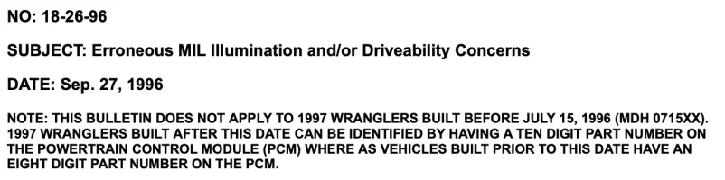

Interesting. I got it from a Technical Service Bulletin dated September 1996:
Edit: I see that the Parts catalogue does indeed show a change for July 24, 1997. But that was from seven-digit part numbers to ten-digit part numbers. Now I'm even more confused.
I checked my 97 TJ, which was built in September of 96. It has the 10-digit PCM. So I think the TSB date must be the correct one, rather than the date in the Parts Catalogue.
I don't know what change the Parts Catalogue is referring to, and why it shows seven-digit numbers (not eight) for the early style.
