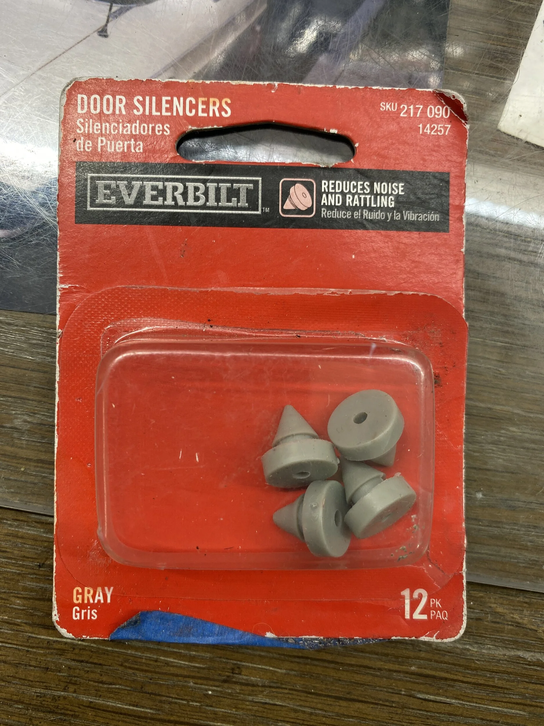

The Dorman 961-375D is $6.99 + tax for an assorted package of rubber bumpers at Advance or Autozone. I need two packages to get the two bumpers I need.
Doesn't $14,96 seem a little bit steep for two pieces of rubber the size of your thumb nail?

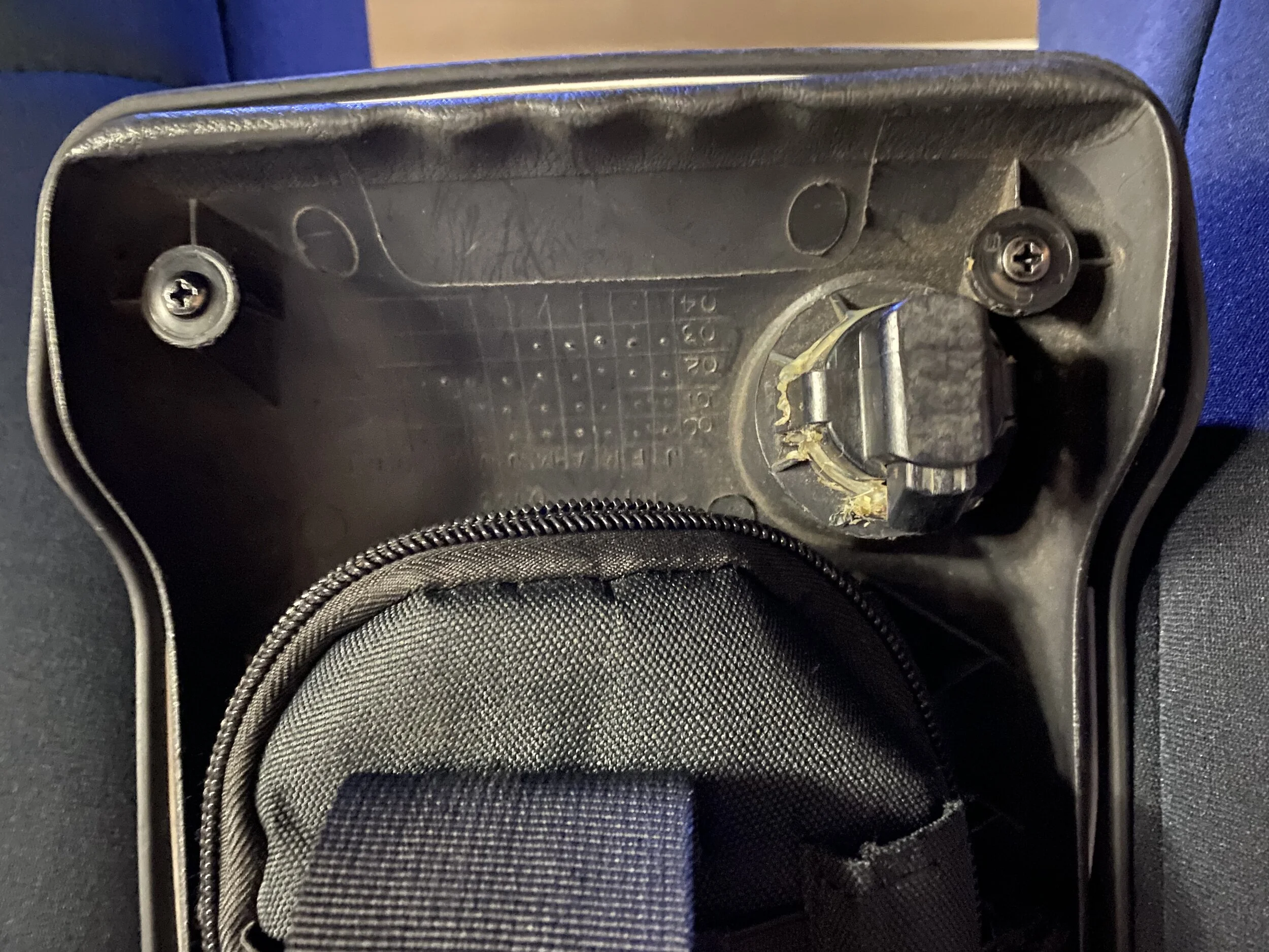

I don’t recall how much the Everbilt bumpers are, but you get 12 in a package and they work pretty well.

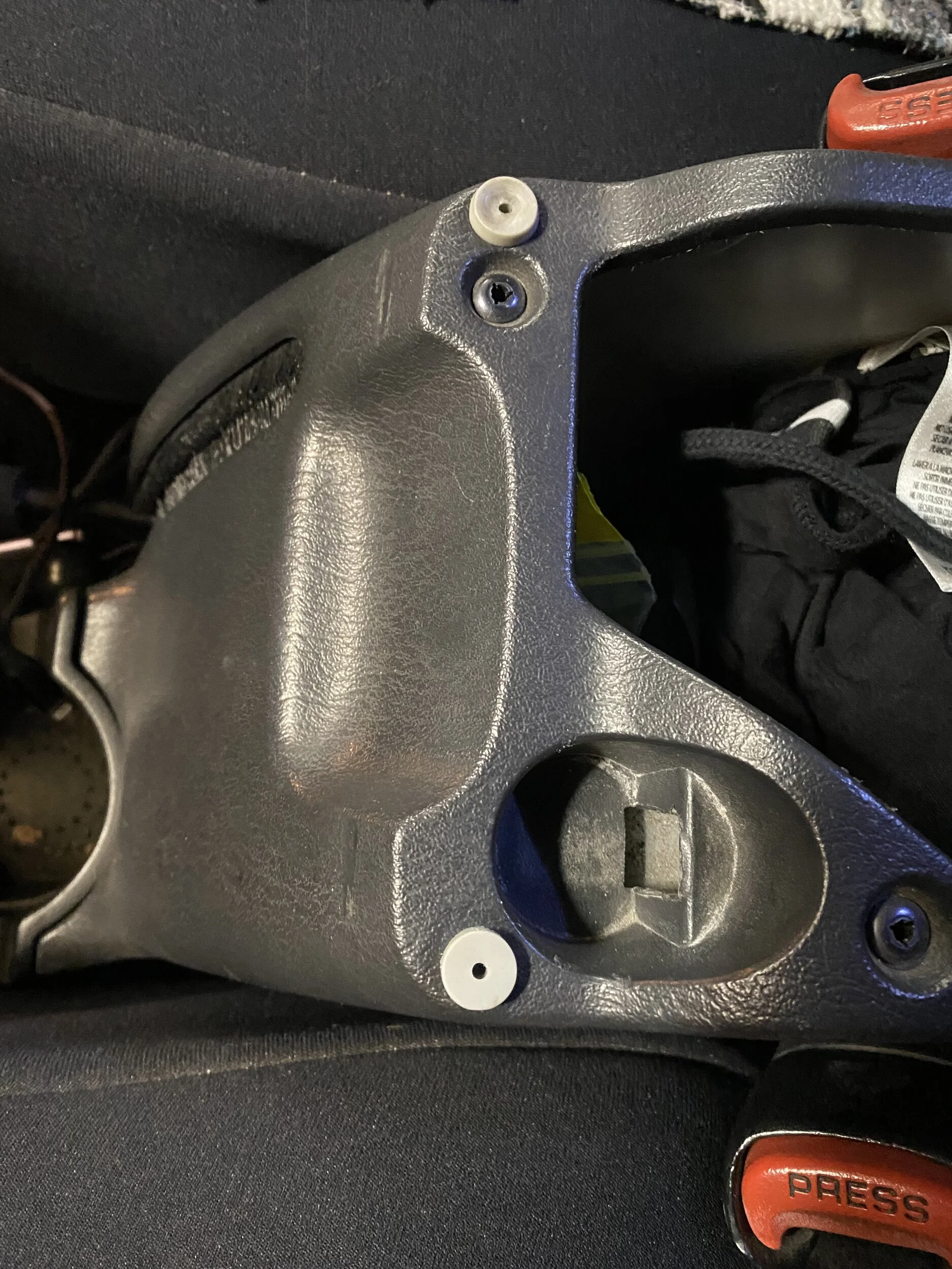

Here they are installed:
Bottom one is new.
You’ll have to extend the upper stops with a spacer or something to keep the lid from flopping around.
