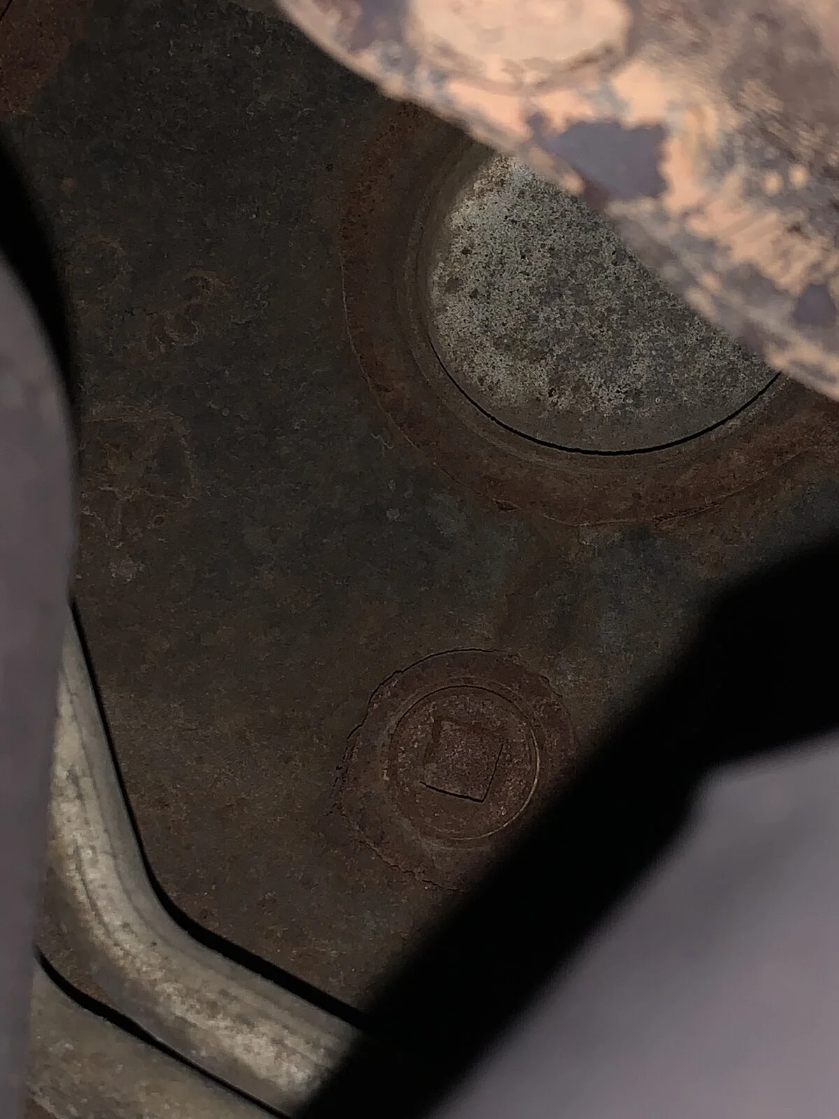

I’m going to give the thermocure a try. Drain plug looks to be a little rusty

1. Concerned about removing the block drain plug (for making a less reason, I have a small dog that I don’t want licking coolant as well as if the plug is stuck in there reason) Is this essential or is there an equally good way to drain?
I would drain from the radiator then drain the block. IIRC there’s about a gallon sitting down in the block. If you don’t crack it open, you could instead drain the coolant from the radiator and then do one flush with water before throwing the thermocure in (that way you get most of the coolant out).
For my first rig, I didn’t drain the block. After flushing the thermocure out with distilled water (multiple rounds), I did one gallon of concentrate to offset the water in the block and then did 50/50 to top it off.
For the second rig, I drained the block and saw loads of rust scale come out. It’s hard for me to not recommend draining the block after seeing what came out.
For both rigs, I drove around with the thermocure about a day (maybe more). I looked for the fluid to turn black and it did both times. I then did flushes after running the engine at temperature so the fluid would cycle through the thermostat.
I had a puppy during the first Jeep drain and the same doggy during the drain on my current Jeep. I didn’t have any issues but I drained from the radiator drain and then lower radiator hose for flushes into a bin when I was impatient. I made a mess but I was mindful and cleaned it all up and sprayed the area down out of paranoia.

You could use liquid wrench on the drain plug or maybe even crack it after thermocure has worked on the plug.
This is the tool I used. I bought two just in case. It was on tight but cracked off with controlled torque.
