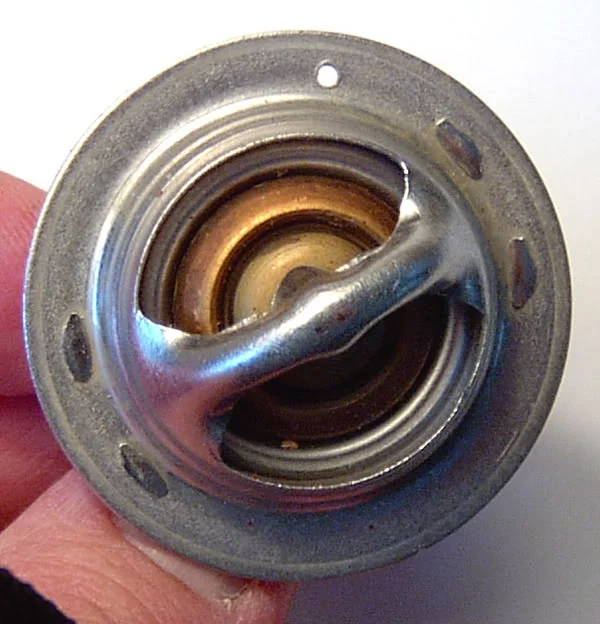

Having installed a 195 degree thermostat with a hole like this positioned at the top would speed up getting rid of the trapped air. You need to add more diluted coolant or distilled water as the trapped air leaves the system.
Reactions: Moglocker
