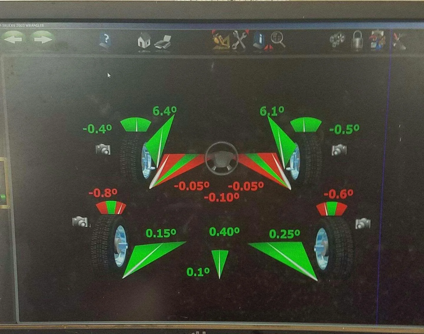

Got a quick reading on the alignment this morning.
Front toe will be getting my attention, and will be extending right side control arm by a turn or half to adjust the caster.
What i dont understand is middle 3 numbers:
-0.10
0.40
0.1
I am guessing one of them is telling me by how much the rear axle is not aligned?
Any comments or concerns?
Middle three numbers are
.010 is your total toe, once you adjust your toe to 0.15 per side it will become green. spec is 0.18- 0.42 total
.040 is your total toe in the rear. it's not adjustable, so do not worry about it.
0.1 is your rear thrust angle which is just about perfect.
The only thing I would touch is the toe, leave everything else alone.
That is a pretty fancy display, much different than the Hunter display I have at work.
