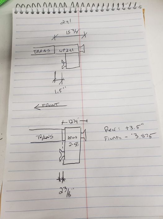

The 2 speed is even shorter and allows for better driveline angles in the rear. With my setup (UCF Ultra High Clearance tummy tuck, Atlas 2 speed) my rear drive shaft length was a little over 20" which is nice. The front driveshaft did get shorter as a result, but not enough to cause me any issues. A 4 speed Atlas would be sweet though, but I'm very happy with my 5.0:1 so far.
Any issues with front driveshaft bind at full droop?
None that I have noticed. I even have a slightly shorter front driveshaft since my Atlas output yokes are 1350. Axle sides are still 1310, but am building for the future a bit.
I have a 1330 front output and a 1310/1350 flange CV rear output. At full droop, my front DS had a slight bind.. Almost non-existent but I had to grind down some of the yoke a bit. Compared to a 241 (not sure of 231 dimensions) My rear DS was lengthened 3.5" and the front DS was shortened nearly 4"

I was a dummy and didn't take a before measurement on the front driveshaft, only the rear. My rear was almost 3" longer than before. I'll need to check the CV on the front and see if its touching anywhere.
