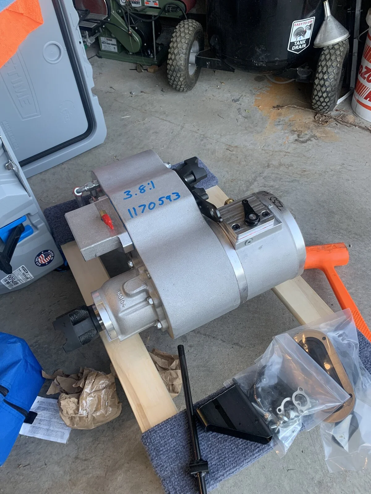

I used this pump from Harbor Freight to do my first Atlas oil change (hang in there guys it'll get built eventually). This works SOOOO Much better than the plastic transfer pump they sell. I cut the top of the AA supplied MT90 gear oil bottle off inserted this and it made quick work of the oil change. The nice features are there's a spring inside the hose so it doesn't get kinked yet remains very flexible and theres a metal tip that fits the Atlas oil port without have to hold it there. Maybe not a long-term performance tool but the $13 was worth it for me.
https://www.harborfreight.com/5-gallon-oil-pump-95068.html

I like the looks of that one. I'm still about 200 miles from my first change needed. This job will be way easier now that I have a dedicated crossmember installed. I assume you just take out that blue bolt to drain and fill the top hole with 2 bottles of what came with the case.
yes thats correct.
