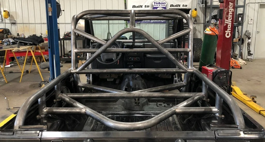

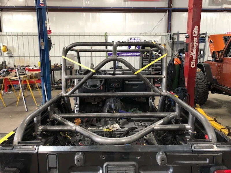

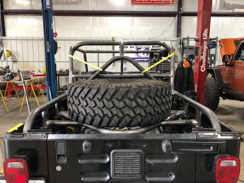

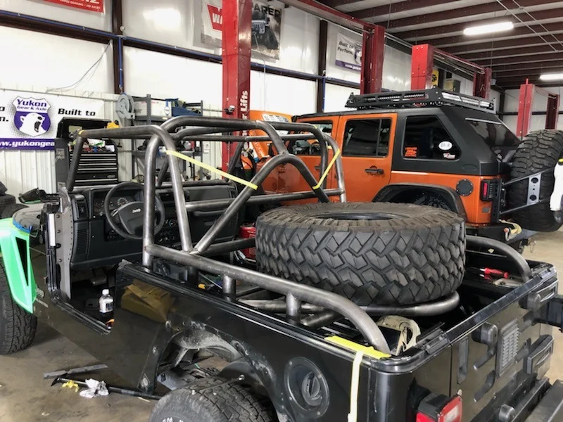

    More cage updates. V3 is 100% awesome. Cannot thank them enough

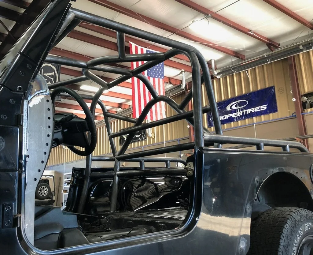

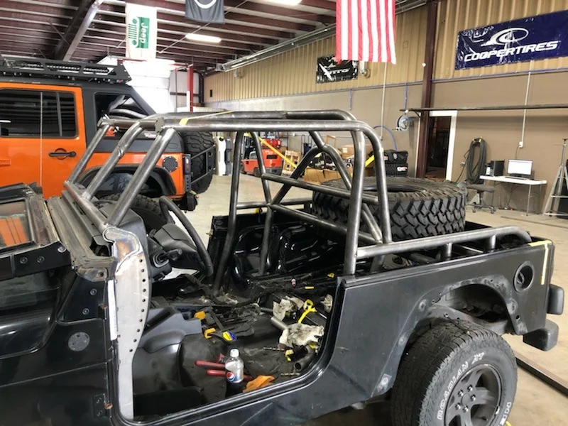

    Cage is done except for final welding, grab handles, and some gussets. Very happy with the results. Michael and Christian are great as is everyone I have dealt with at V3.

    WOW! That's one hell of a cage!
    Who built that cage and what did they charge? If you don't mind me asking that is...

    V3 Jeeps in Louisville, KY is the company and Michael is the fabricator. Christian is the man to talk to at 502-445-5816. The estimate was around $3000.00 but each one is unique and so costs vary based on your wants. I figured it was worth it to have what I wanted and not what genright or poison Spyder had out of the box.
    Don't get me wrong I am using a ton of poison spyder stuff but wanted some uniqueness
    I was looking for a place and nowhere in Nashville I called seemed interested so I found V3, called and they were interested, stopped by and confirmed and dropped the Jeep off.
    I am a very happy customer and these guys didn't know me from Adam when I walked in but still treated me like I had a name.

    Very nice! It turned out awesome, and $3000 or so was about what I was expecting.
    I hear you about wanting something custom as oppose to something that was just out of the box.

    Great job on the cage. Is the spare tire going to be mounted in the bed like in the picture? Or on the back?

    That thing is freaking incredible!!
    It’s funny how much longer it looks without the rear stock roll cage

    Those are sturdy roll bars, can get into the ring with an attitude!

    The spare tire will be mounted horizontally in the rear just as shown in the photos. It will be held down with a Y Strap from Poison Spyder.

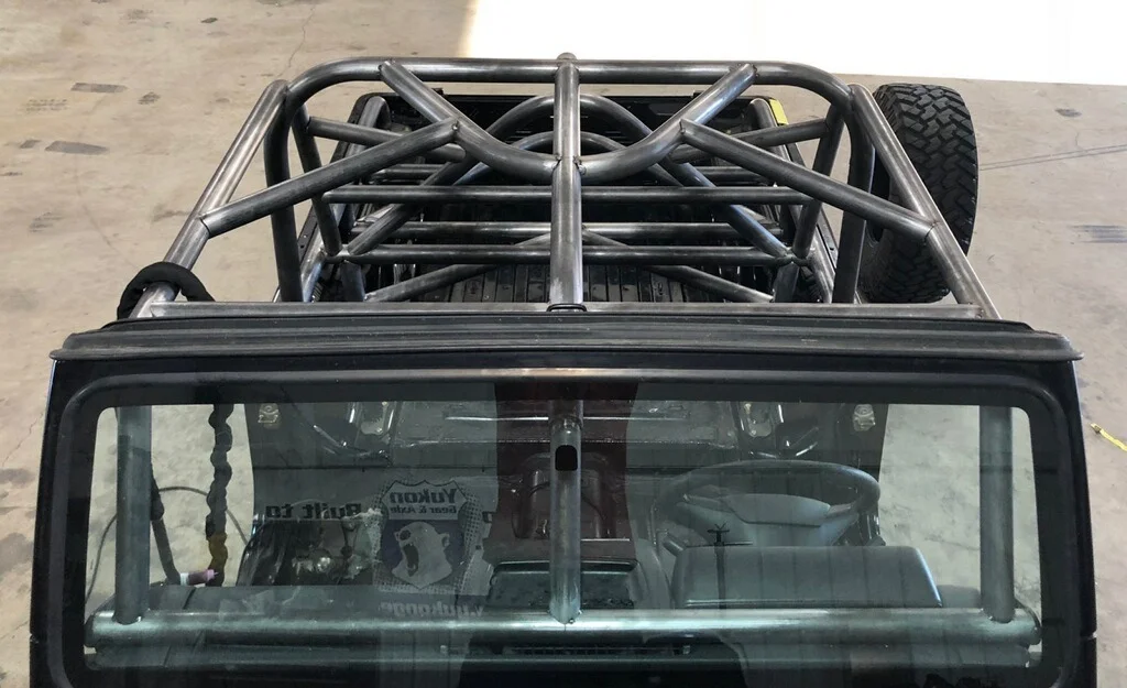

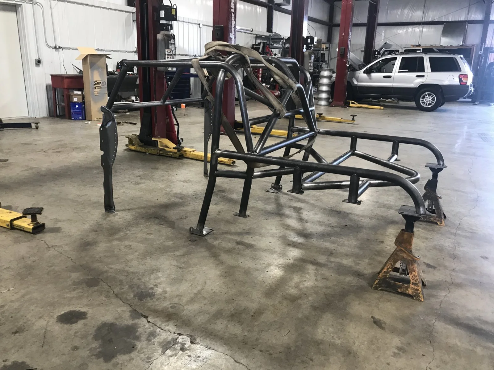

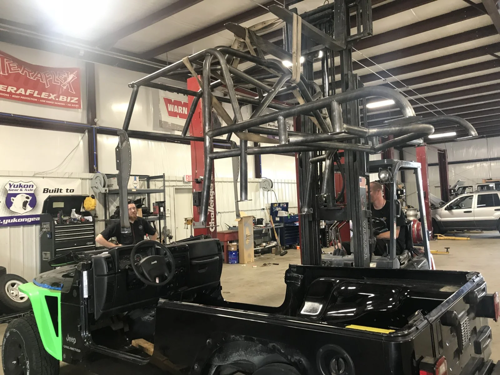

    V3 pulled the cage Friday for final welding. This is it coming out and sitting on the ground. I cannot thank these guys enough for all the hard work, and I am excited to get it back and get it powder coated.

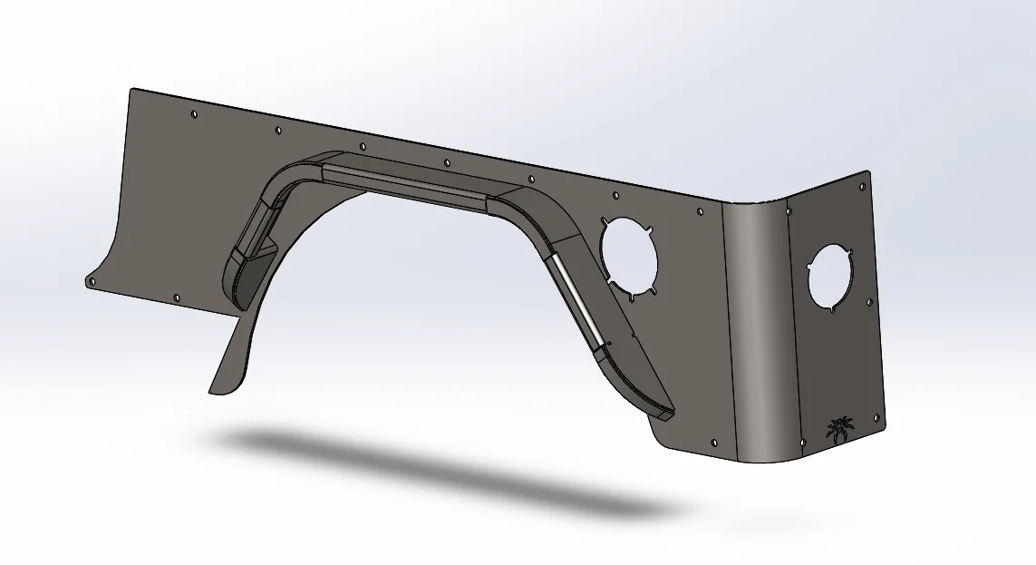

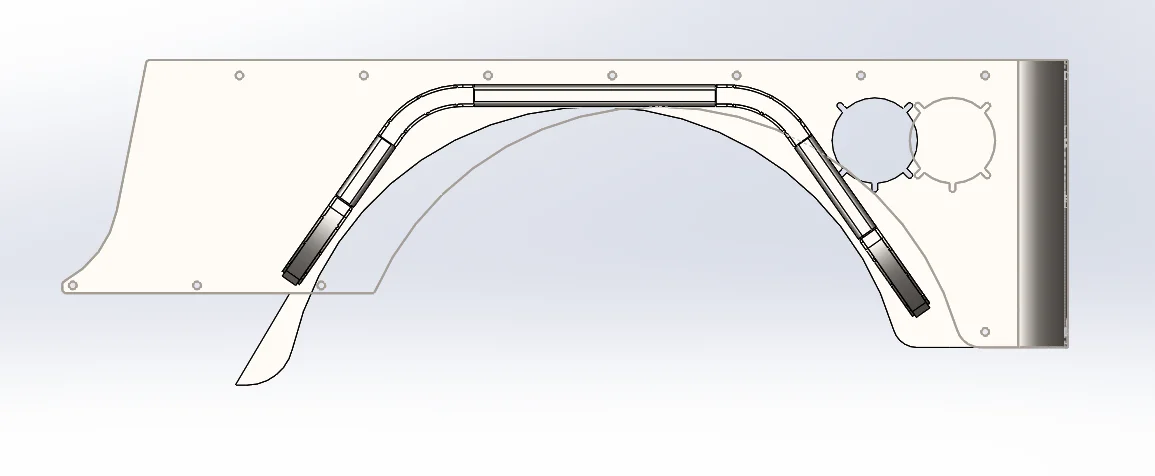

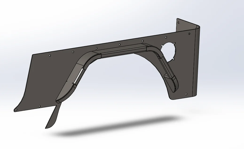

    Around the outside, I am using Poison Spyder armor. I originally ordered the LJ Crusher Corners, but measured and did the math, and they were not big enough to stuff a 37" tire into. Also, they had cutouts for the stock tailgate hinges that I will not be using. I know they make plates to cover that, but I would rather it be smooth.
    I reached out to Poison Spyder and it turns out that for $150.00 more you can get the corners customized. I am getting them with the 40" Daddy Long Legs opening in the stock position as well as had them raise the flare up to match the XC front fenders along with deleting the tailgate hinge cutouts.
    for $150 extra plus shipping it is well worth it to get them the way I want them, and not try and cut them myself after the fact.
    This is a picture of what a Daddy Long Legs looks like overlaid on what I am getting (Daddy Long Legs is the Grey Outline)
    These are 3D Renders of the driver corner.

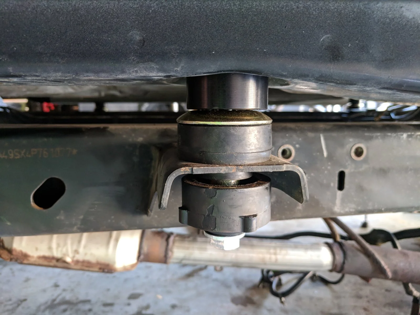

    V3 Also ordered OME Coil Springs and replacement rubber and metal body mount parts that I will replace when I put in the 1" body lift from Rokmen. I want to make sure that it is all riding on good mount points.

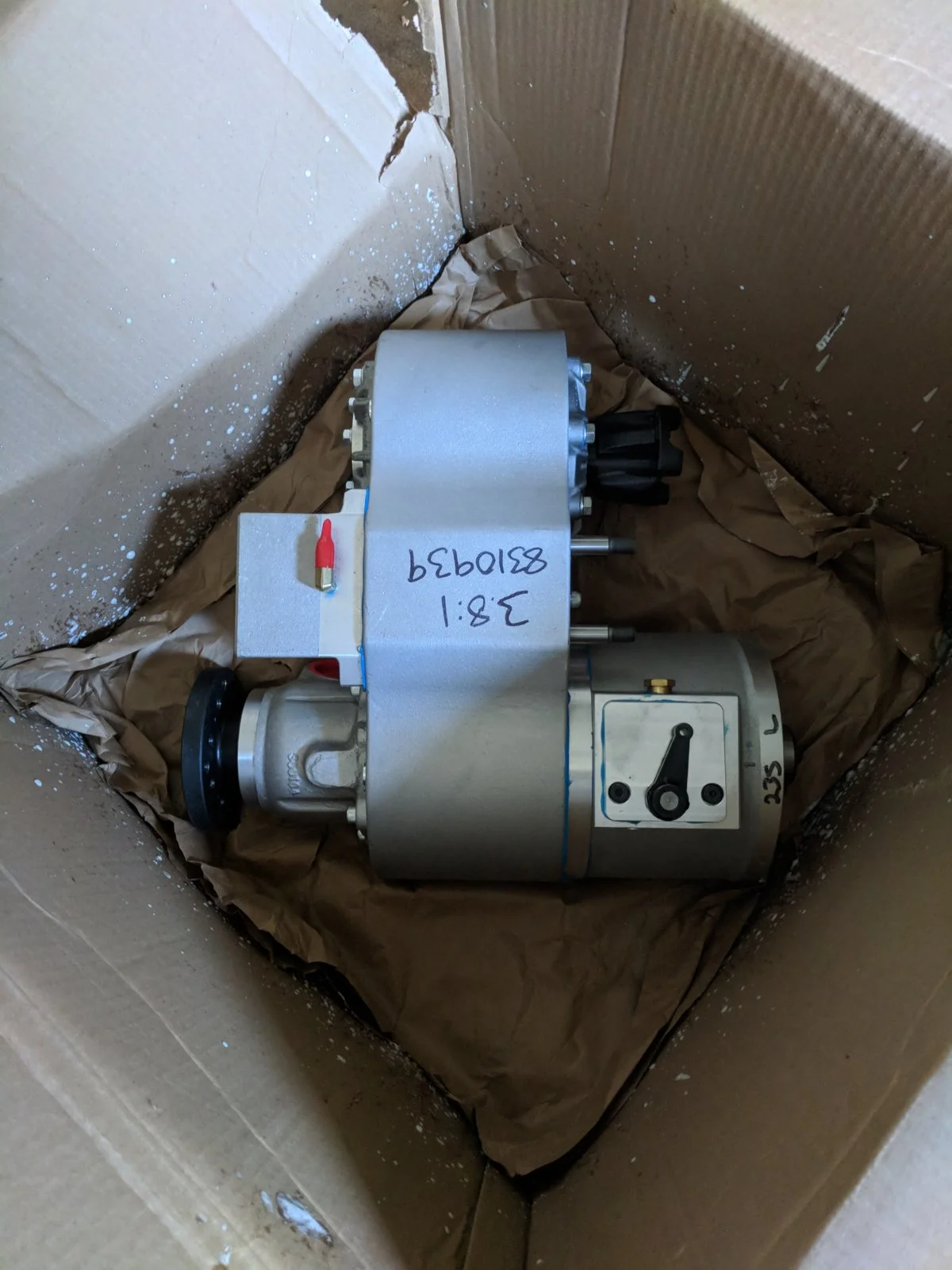

    Advance Adapters called, and the atlas is going into production ahead of their 6-7 week estimate. Ended up being 3.5 weeks from getting in line to build start. They estimate it to ship in 7-10 days, so end of this coming week will be the approximate time frame.
